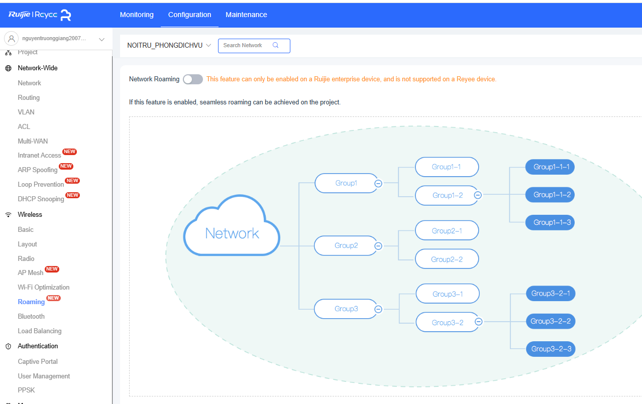

How can I setup Roaming? Configuration>Wireless>Roaming only allow on/off . What's meaning of this setting?

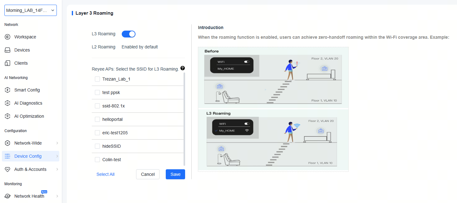

When managed via Ruijie Cloud, APs in the project can perform layer 2 roaming by default. May I ask if you are refering to the configuration in the "Device Config > Wireless > Layer 3 Roaming" page?

I can not find"L3 Roaming" option page anymore on Ruijie Cloud. Now only "Network Roaming" available. What's "Network Roaming"?

Dear customer,
The roaming option here is the same with the one in "Device Config > Wireless > Layer 3 Roaming" page in the new UI. It is advised to configure it in the new UI since the old UI is less maintained.
