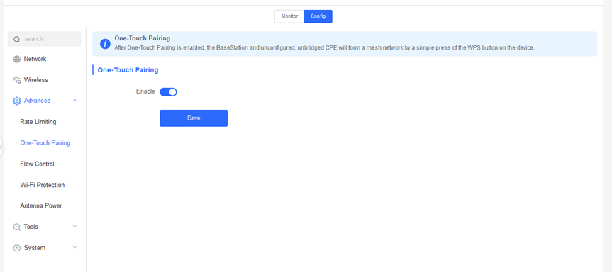

Overview:
When the One-Touch Pairing feature is enabled, a simple press of the One-Touch Pairing button on the device triggers the mesh operation. During the mesh process, the BaseStation promptly forms a mesh connection with the factory-configured and unbridged CPE, streamlining the networking process.
Configuration:
Choose One-Device > Config > Advanced >One-Touch Pairing
Toggle on Enable and click Save.
Check whether the bridge is in BaseStation mode or CPE mode. If the bridge is currently in BaseStation mode, pressing the One-Touch Pairing button on the wireless bridge will bridge it to all nearbydevices operating in CPE mode. If the device is currently in CPE mode, pressingthe One-Touch Pairing button will switch it to BaseStation mode and continuebridging with all nearby devices operating in CPE mode.
