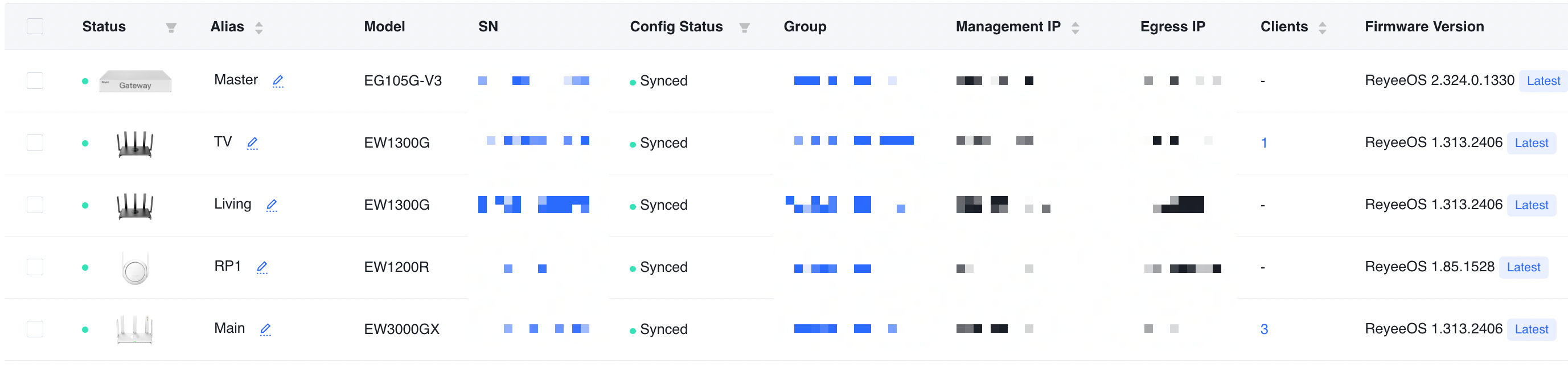

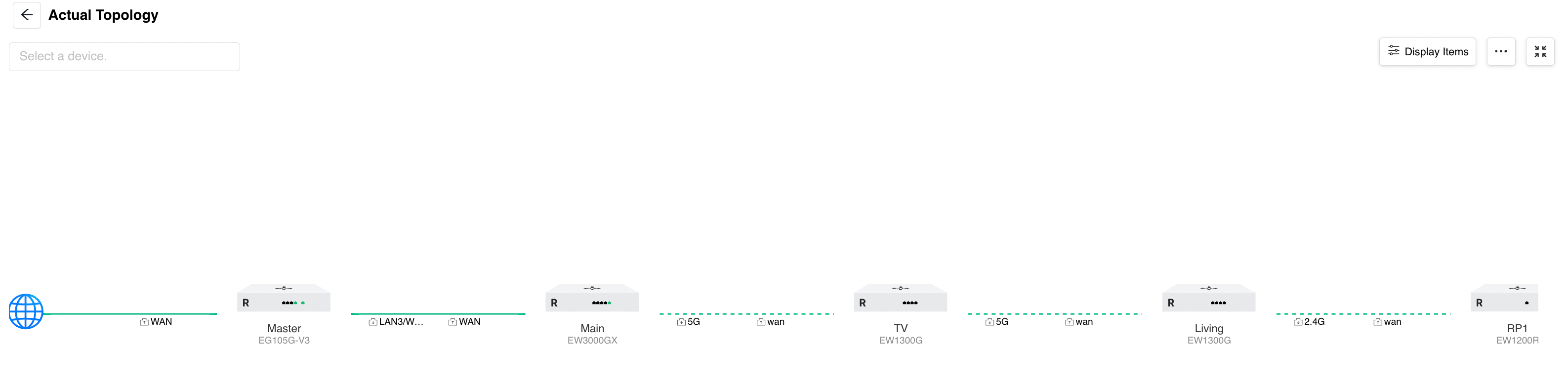

Below is my devices. Between Master (EG105G) and Main (EW3000GX) were connected through cable, the rest are mesh.

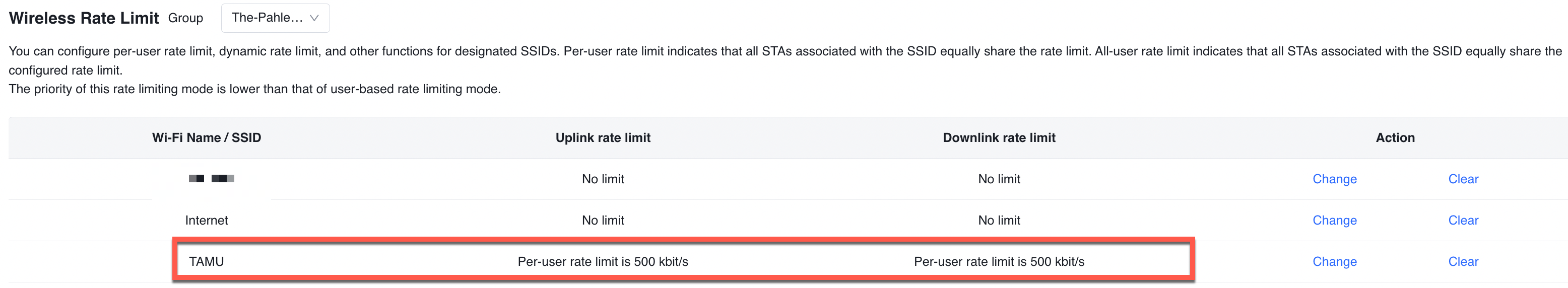

the following are the configuration that I have applied

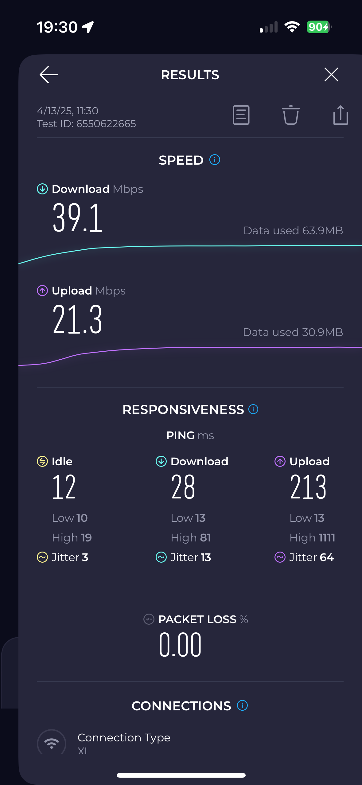

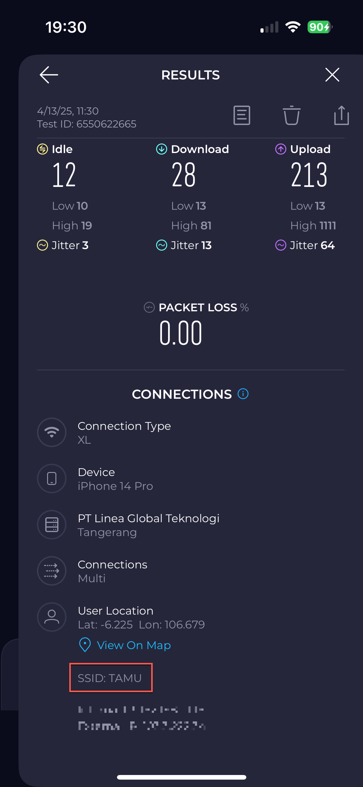

below the speed test result using ssid TAMU and the speed is surpassing the limit that I have set.

Can I know what is EW working mode? Is access point mode?
If so, EW does not support flow control in this mode. That means you can't control the user's speed on EW. If you want, you can configure it on EG based on user network segment:

Yes all EW devices are in AP mode.
