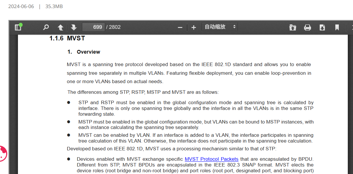

This is device configuration guide , you can check more details from this link: https://www.ruijienetworks.com/resources/preview/rg-cs83-series-switches-rgos-b1404p1-configuration-guide/

Hi sir,
RG-CS83-24GT4XS does not directly support PVST because it is a Cisco's proprietary protocol. However, Ruijie Switch can be configured with MVST, Which  is  a  spanning  tree  protocol  developed  based  on  the  IEEE  802.1D  standard  and  allows  you  to  enable spanning tree separately in multiple VLANs. Featuring flexible deployment, you can enable loop-prevention in one or more VLANs based on actual needs.
