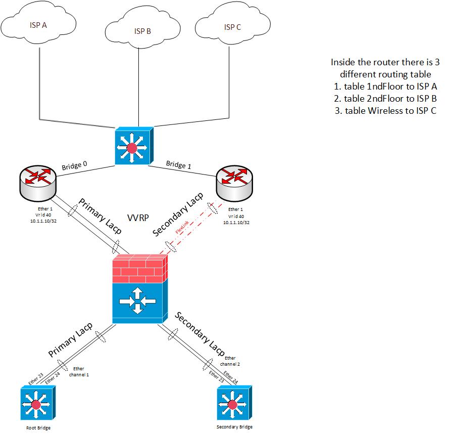

Hello everyone i  need help. this is my first time using rg-wall for enterprise. what i want to achieve is high availbility system design without change the current network topology. here's my topology.

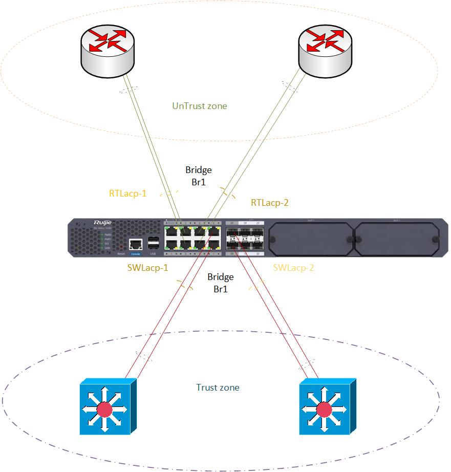

how do i configure the rg-wall so that it can be like the picture above.
1. someone told me that the RG-Wall cannot function optimally if it is made transparent mode with the nat on the router. for the RG-Wall to function effectively, the RG-Wall must be placed before the router in routing mode and the nat masquared is on the RG-Wall. is that correct?
2. can the RG-Wall be configured with a bridge inside the LACP that carrying a vlan inside, 2 LACP for HA system?

i got question regarding link aggregration..
1. i need to setup RG-Wall in transparant mode with 4 LACP in 1 bridge (idk if i need to put this into 1 bridge or not. CMIIW) in transparent mode. and the bridge will carry out 4 vlan. my question is can the RG-Wall work seamlessly to secure my network like a common IDS, IPS, app & url blocking ?

Dear sir,
Good day.
As long as the traffic will pass through the firewall, the firewall will determine it and actiavte the policies to the traffic.
