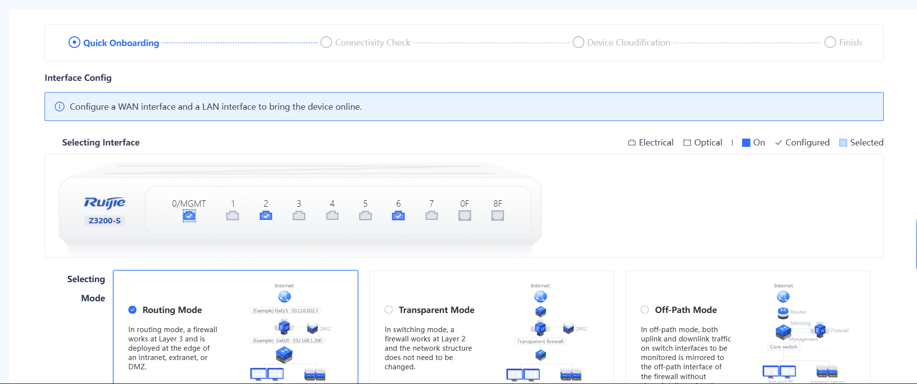

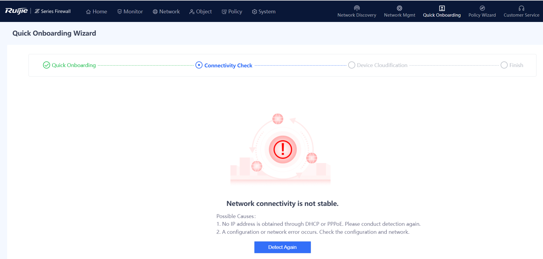

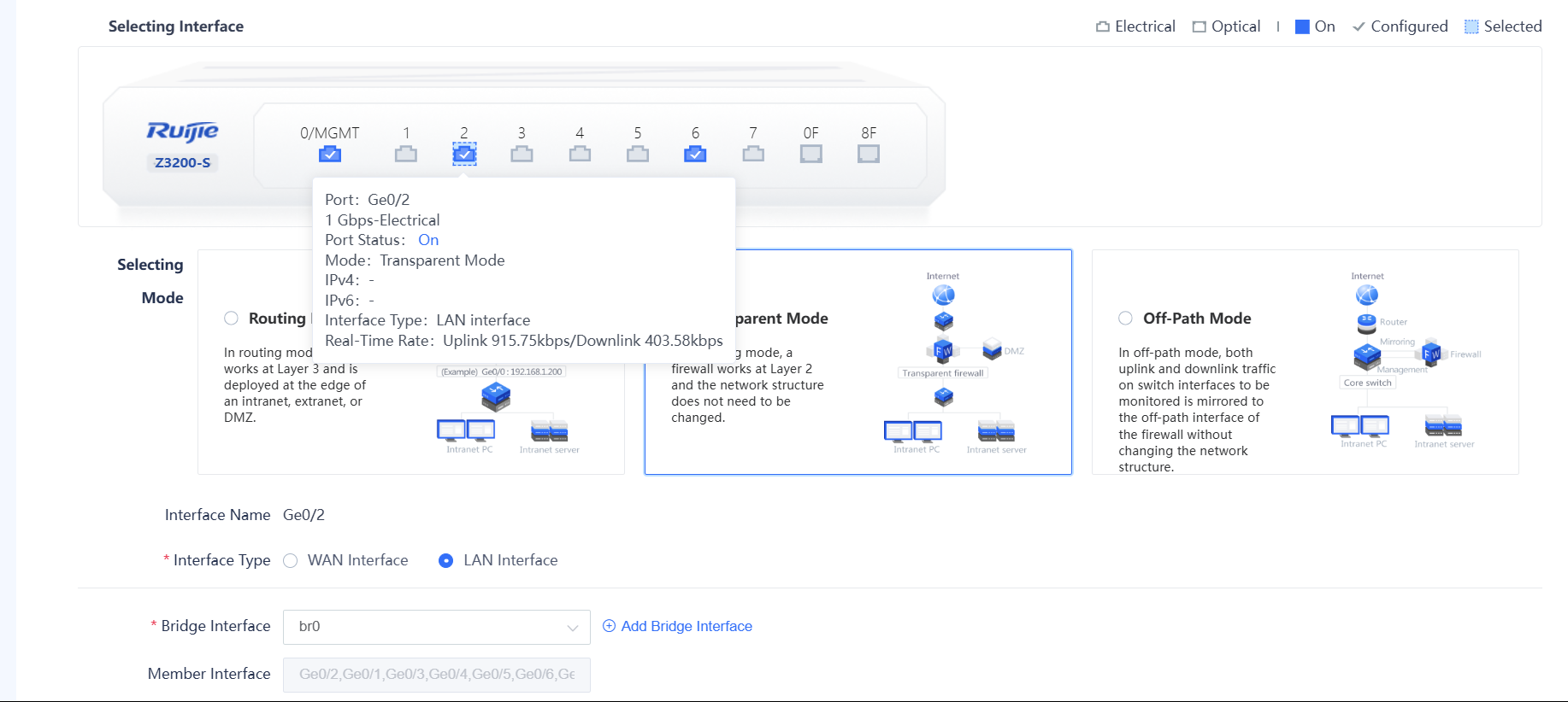

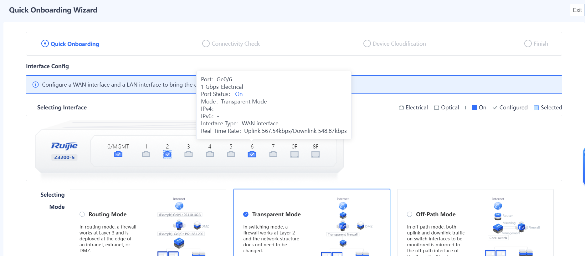

Hello, I've followed the above recommendation but I'm still stuck.

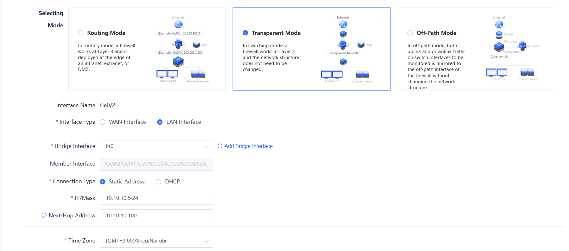

The quick onboarding seems like a good track but it's not completing onboarding because the firewall can't connect to the internet. Can anyone please help kindly. ISP Router - Cisco Router (G0/0/0 - Public IP), (G0/0/1 - no IP), Vlans 1,2,3,4 assigned on the sub-int each with an IP - Core_SW. Could it be that because there's no IP on the g0/0/1 the reason why I can't setup the firewall using quick onboarding sunce it can't connect to the internet? Anyone who understands this topology to kindly assist.

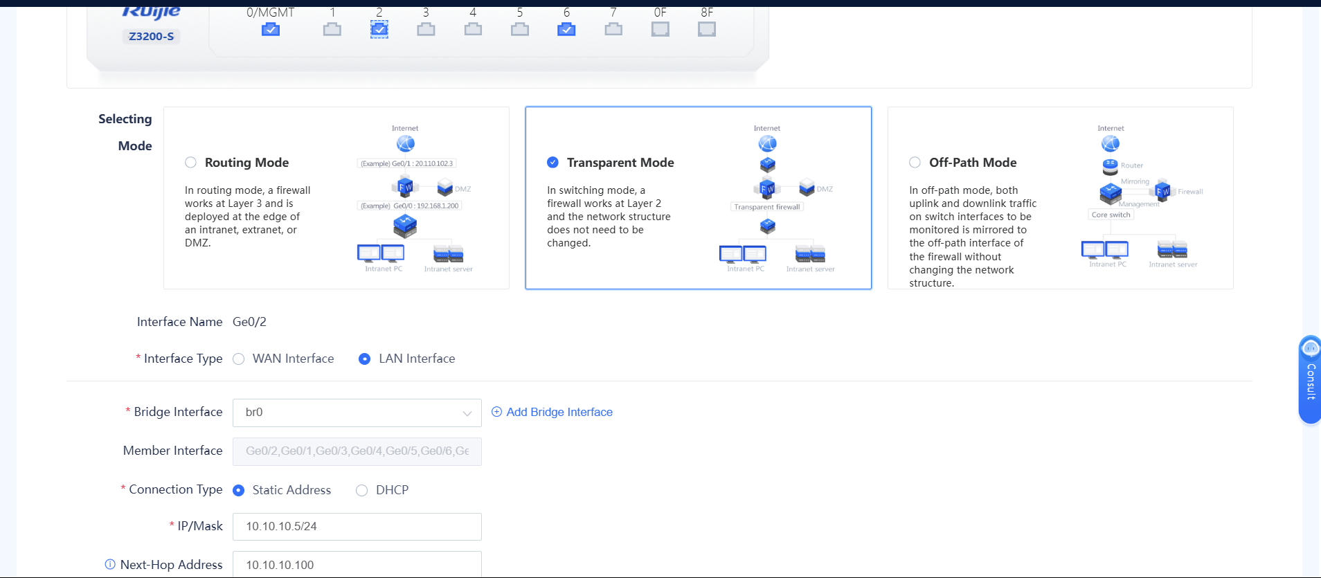

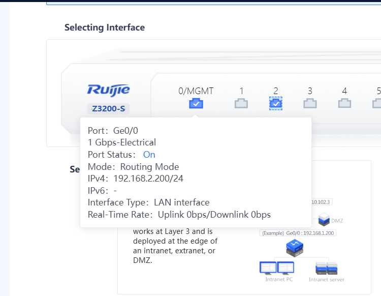

Hello, I'm still stuck. Please find the images for your reference as to what I've attempted to implement that with no luck. Anyone who can kindly assist with steps to deploy this firewall I'll really appreciate it.

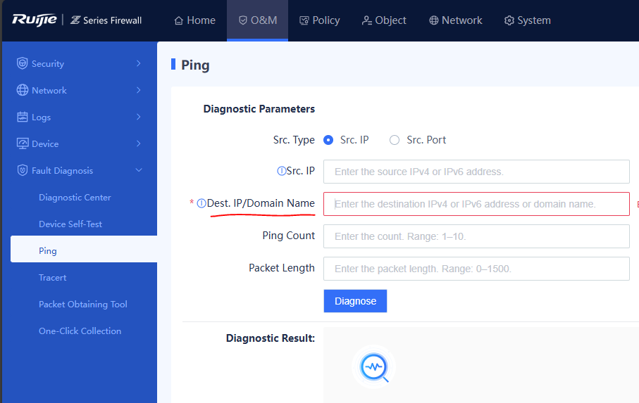

Dear customer,
Acccording to the screenshot you provided, the Gi 0/6 is configured as WAN interface. After it is configured, can you ping the next hop address configured on the Gi 0/6?
If the Gi 0/6 is connected to a device like a switch, has any default route been configured for its IP?
To resolve this issue effectively, we highly encourage you to contact us on Rita(www.ruijienetworks.com/rita). We can help you check it via a remote session.
