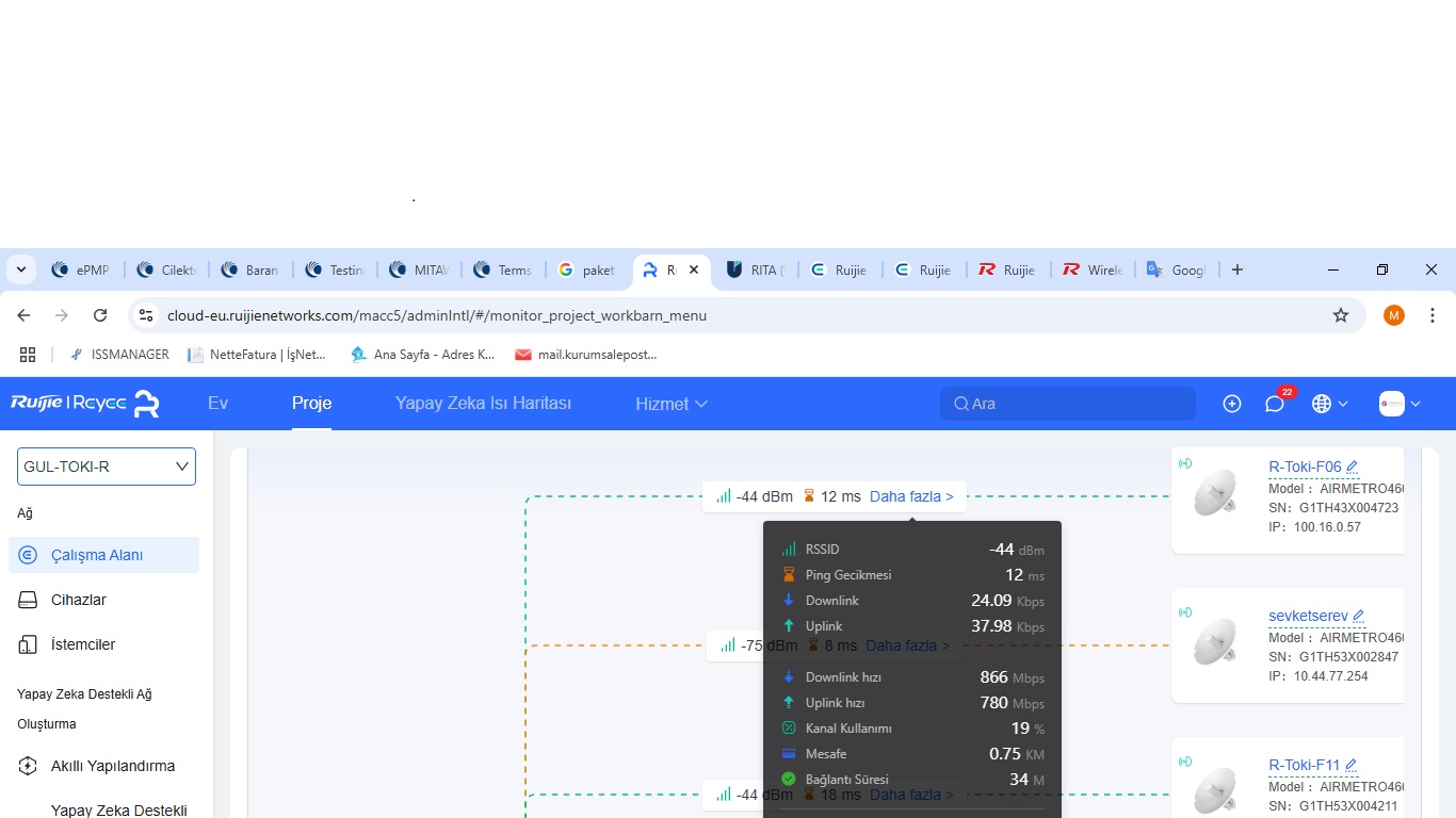

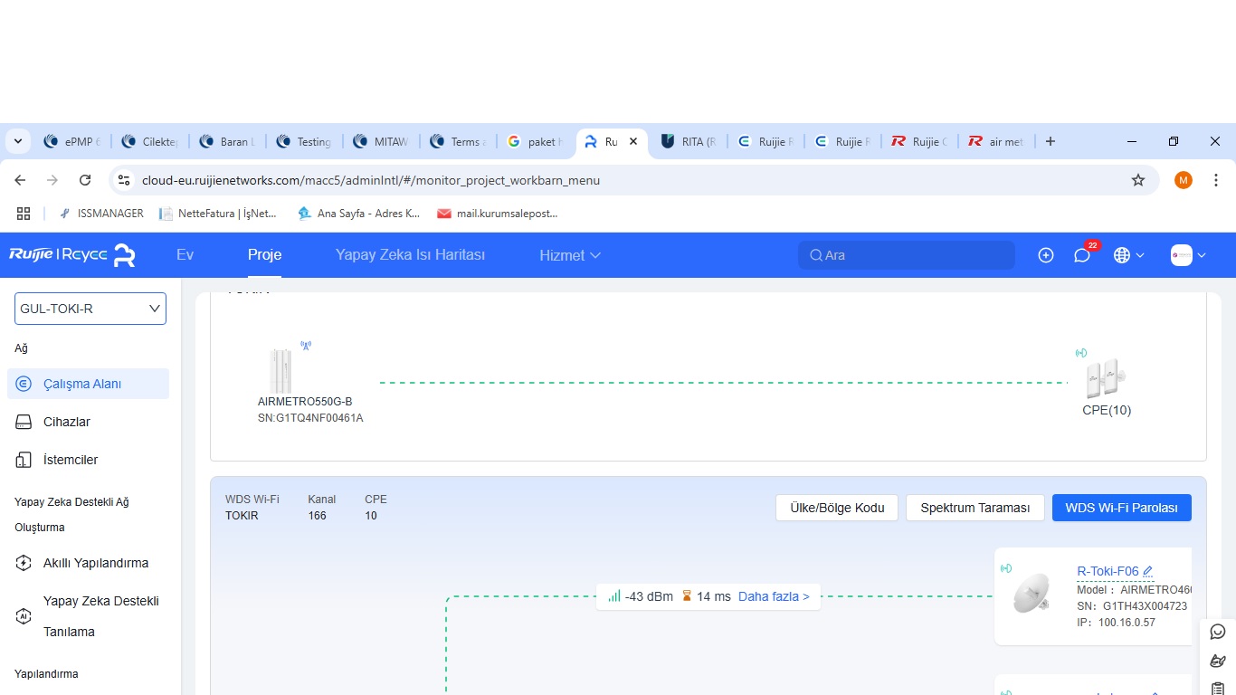

I installed the system as air metro 550g base station and airmetro 460g cpe, I added 12 cpe to the 550g antenna.
The signal decibels are 43 dbm as standard in all of them. But the cpe's are constantly disconnecting and reconnecting. Also, I cannot configure VLAN to the cpe antennas. Can you provide support regarding this?

There is no physical barrier between the devices, data dbm is almost 45 dbi. I started experiencing this problem when the number of cpe started to increase. There are currently 12 cpe. I did not experience these problems when there were 5-6 cpe. The 550 G datasheet also states that it supports 32 cpe, but I think we will not be able to reach this number.
The lack of VLAN is a big deficiency of this antenna. We provide Wisp service. I cannot imagine a network without VLAN.
