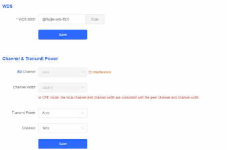

does choosing the shorter distance in the parameter helps a stronger signal?

i mean, what's the purpose of distance parameter here? does it affect the signal?
This is just a convenient way to set the correct ACK Timeout for your link. It does not change anything regarding signal.
Just make sure it is higher than the real distance.
It depends on the EST how far they're actually bridging
If the distance between EST is more than 1km, and the configuration shows 1km, the bridge between EST will fail

oh i see, so what happens if the distance between EST is 500m, then you choose 5km?
