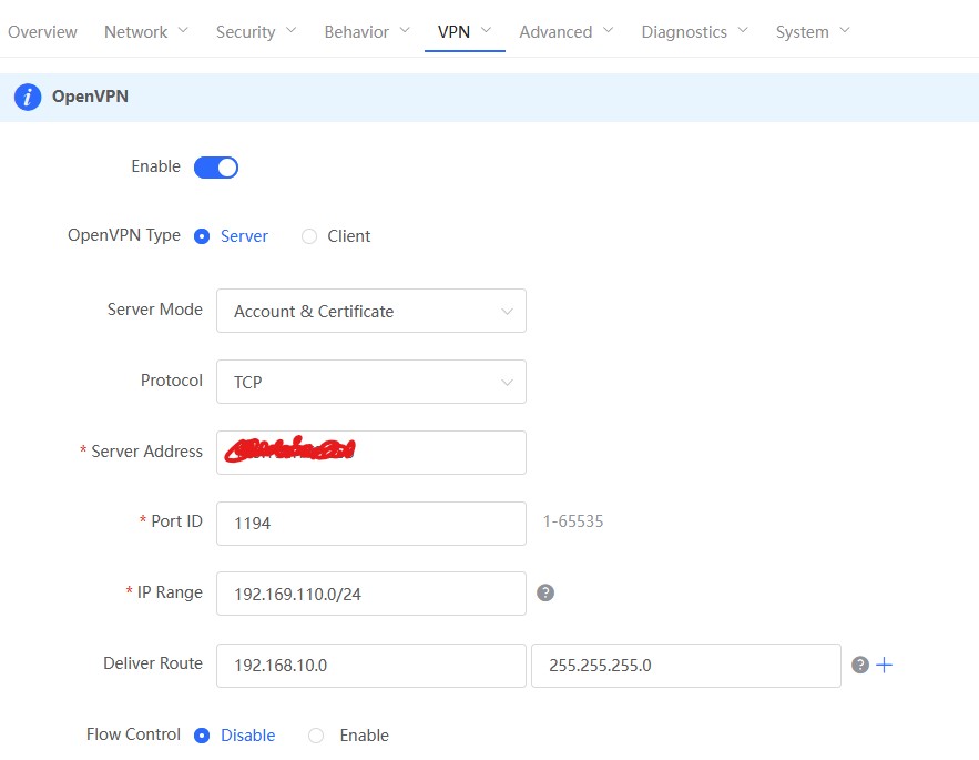

Sir, I have connected with openvpn but I can only reach the gatewayny ip 192.168.10.1 and can't reach our system ip at 192.168.10.2, how can I connect to our system ip?
0 2024-3-30 18:39:17 View all replies
TryXZ replied at 2024-3-30 18:23
Sir, I have connected with openvpn but I can only reach the gatewayny ip 192.168.10.1 and can't reac ...
Hi sir/madam,
could you show me the VPN tunnel status and the route settings please?

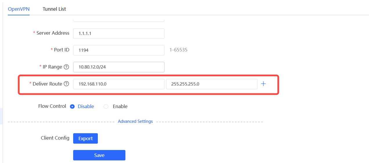

TryXZ replied at 2024-4-1 08:19
Thank you for answering, this is the PC to client settings that I made. So from OpenVPN I want to  ...
In the IP Range section is to set the tunnel IP which will assign to the VPN clients.
You need to add the server intranet network routes in th Deliver Route section and the tunnel IP range can not be the same with it, otherwise will cause conflict.

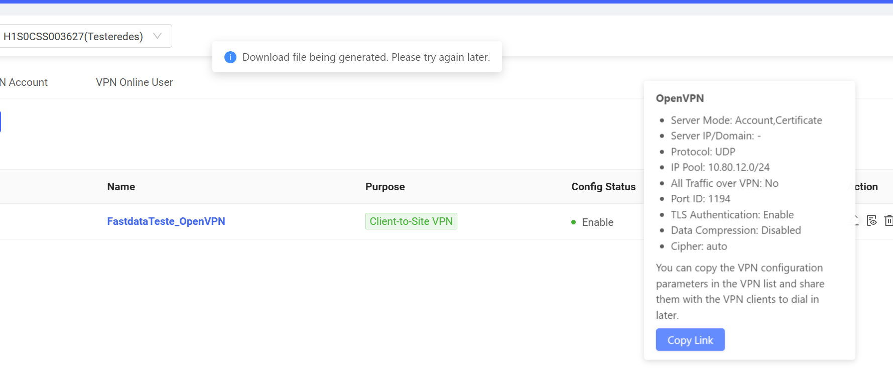

Good day, i cannot download the configurations.
Router EG105G-V2
Download File don't apear. THANKS
0 2024-8-14 04:55:06 View all replies
Acácio José Gaspar Rapaz replied at 2024-5-26 18:11
Router EG105G-V2
I have the same problem. Cannot download VPN file
