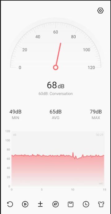

The Ruijie Gateway EG3200 (1) and Reyee switch RG-NBS3200-24GT4XS-P (2) are in a open rack. With the noise level, see below. I need to move the rack into a closet in a close rack to reduce the noise level.
