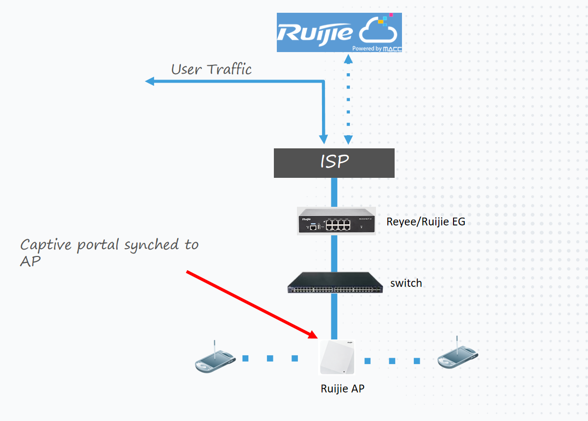

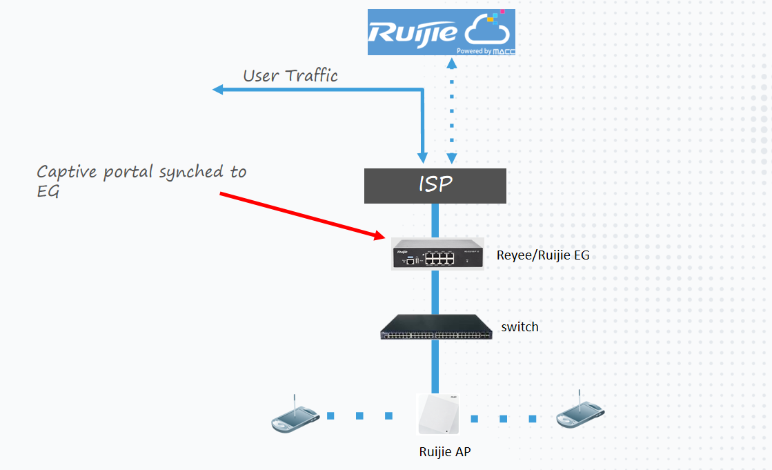

Scenario 1. Captive portal authentication with Ruijie EG
Configuration Steps:

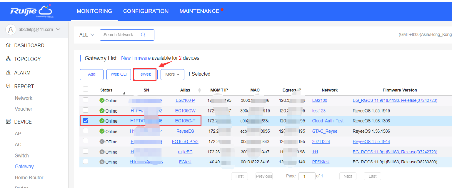

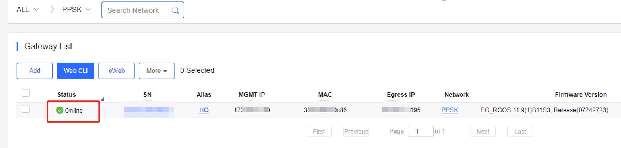

Step 1: Make sure the EG is online on Ruijie Cloud

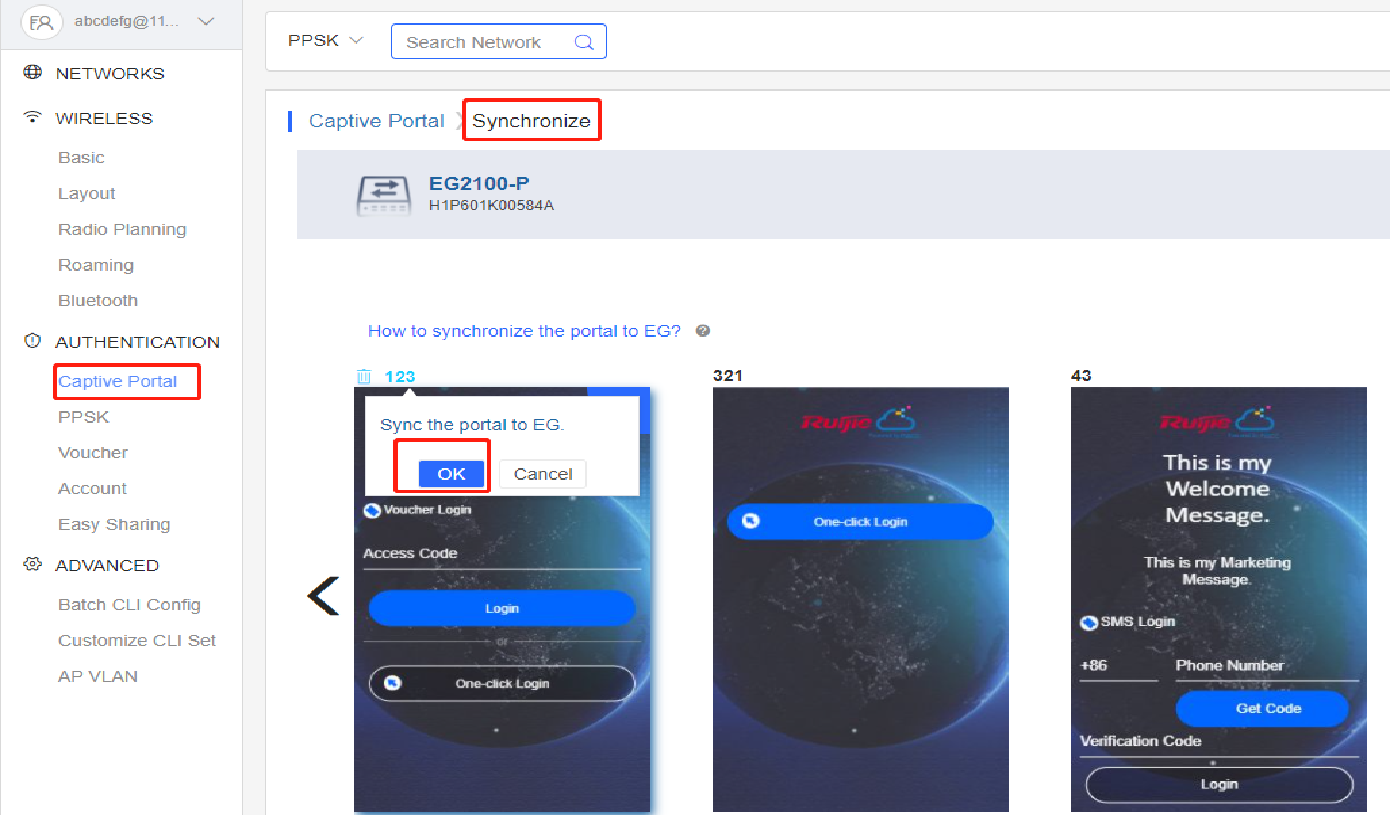

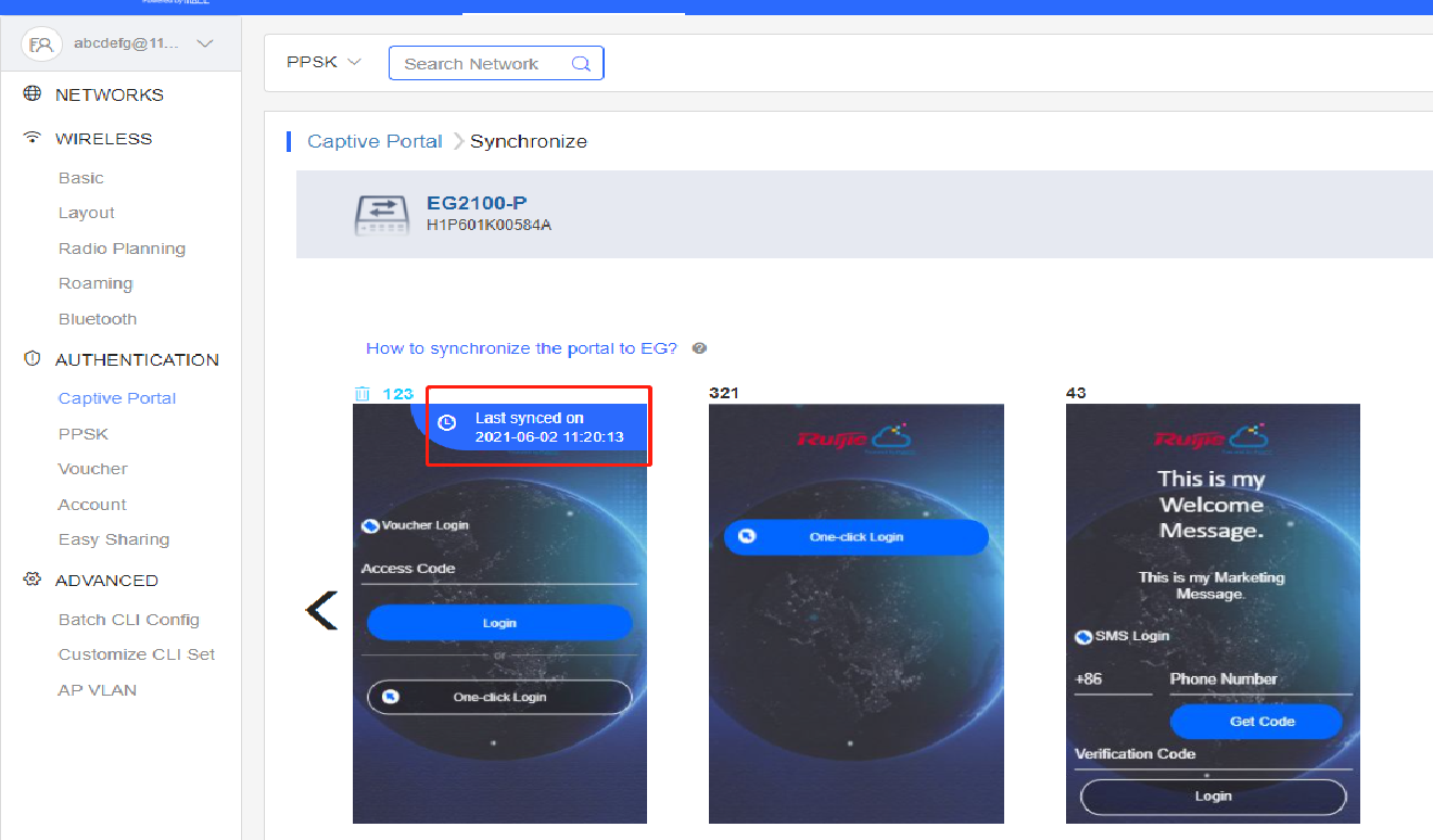

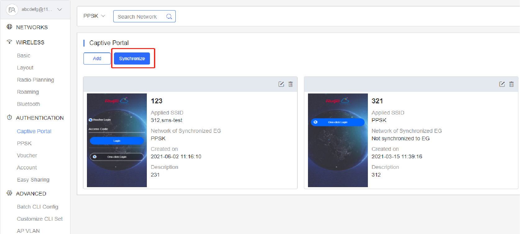

Step 2: Create the portal template and click the  “Synchronize”
Step 3:  Choose the portal template and click “OK” to sync the portal to EG

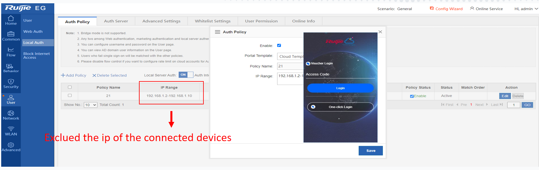

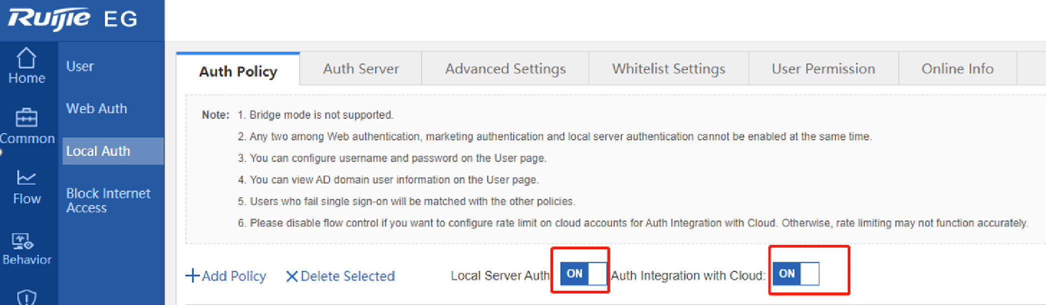

Step 4:  Go to EG eWEB, and enable the “Local Server Auth” and “Auth Integration with Cloud”,
Notice: you need to add an policy and set the ip range which need to authenticate
Step 5:  Wait 2 mins, check the portal template have synced to the EG.
Step 6 : On Cloud, the status of captive portal shows the date when last synchronization.

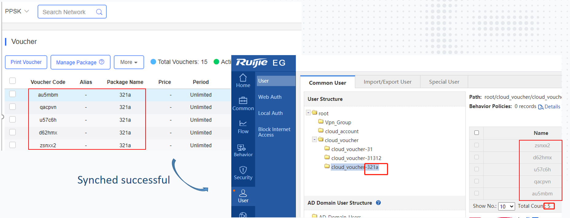

Step 7:  Create the voucher code on Ruijie Cloud and check all the vouchers have been synced to the EG.

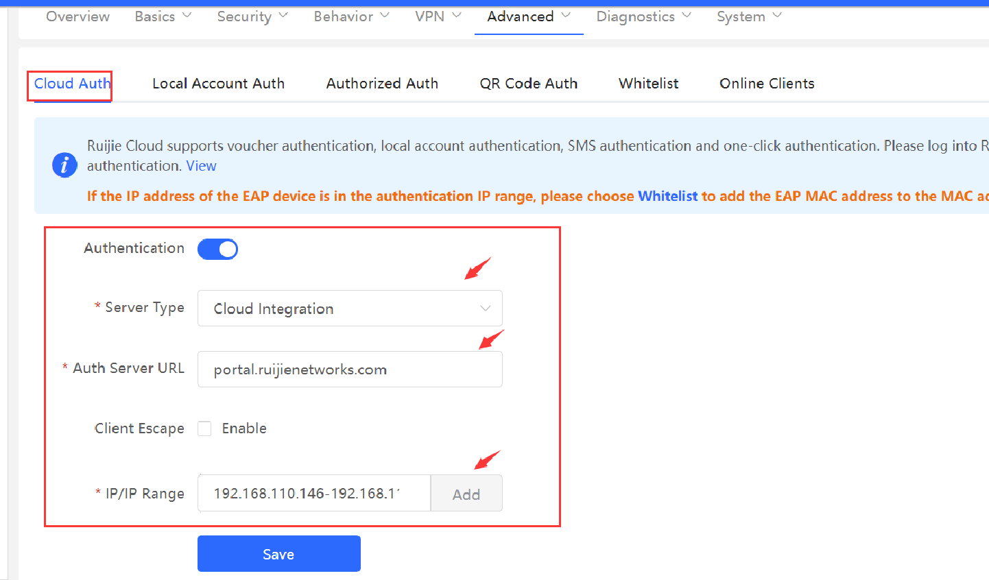

Scenario 2. Captive portal authentication  with Reyee EG

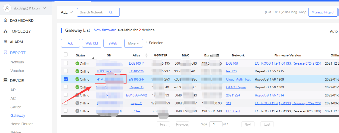

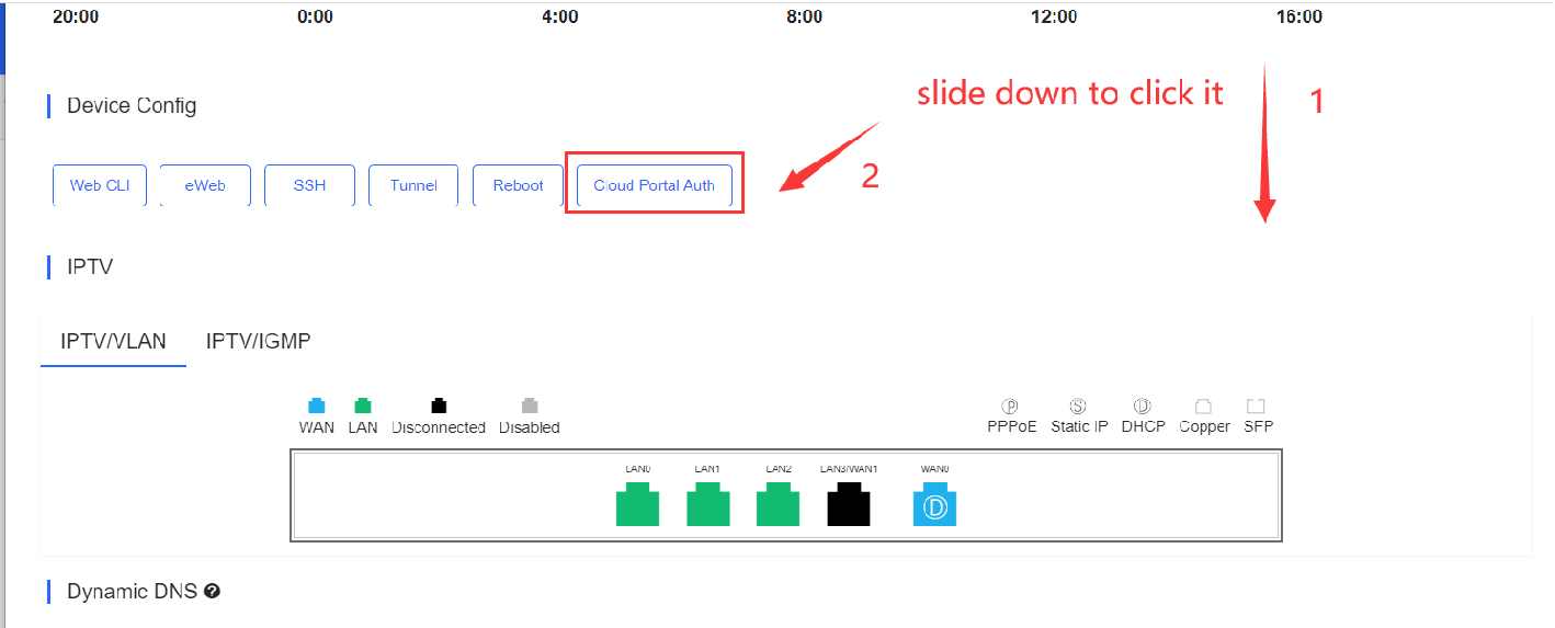

Step 1: Make sure the Reyee EG is online on Ruijie Cloud and click its SN in the list to enter the config page

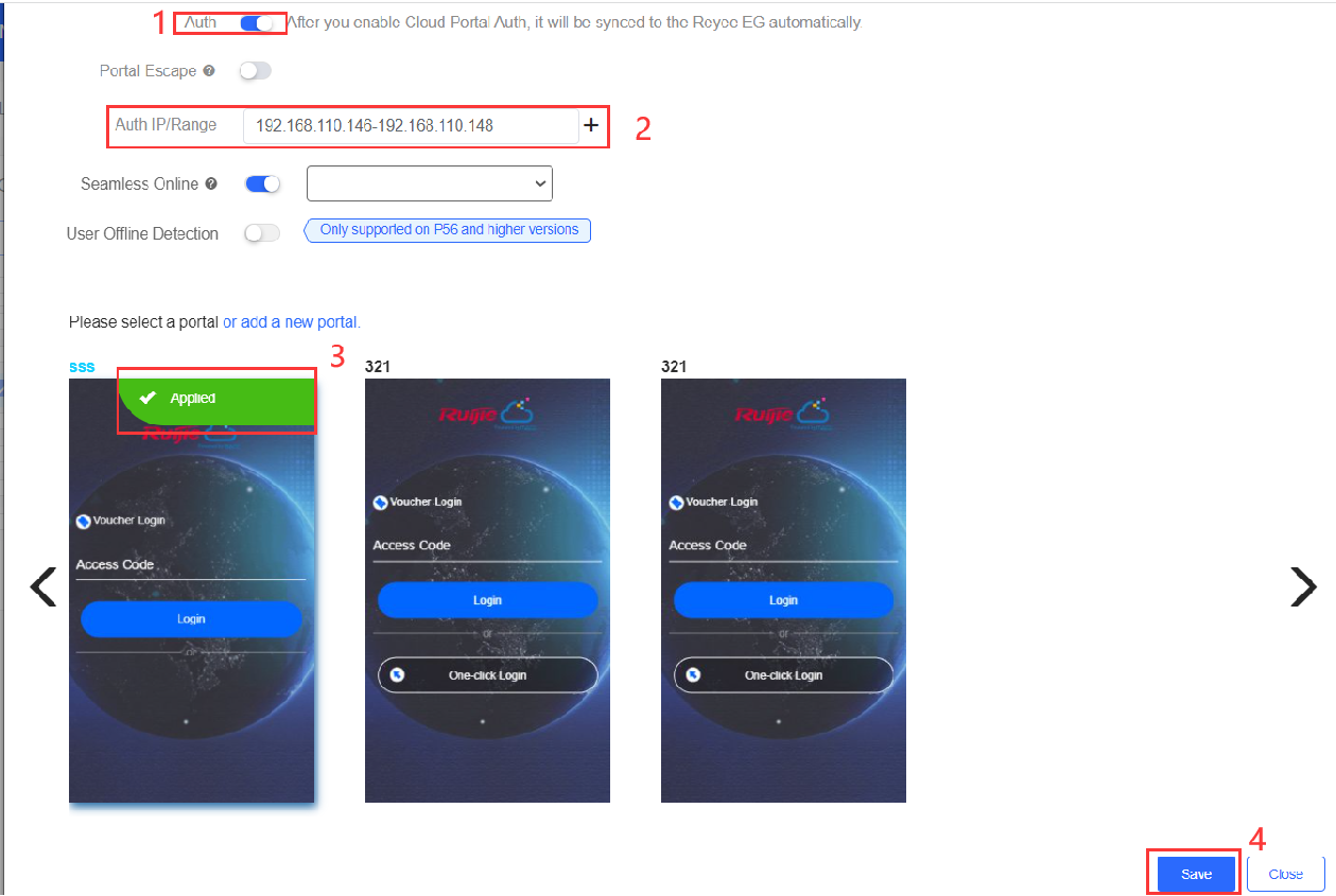

Step 2: click the ‘Cloud portal Auth’ to configure the portal on Cloud
Step 3: enable the Auth firstly, then set the IP range which need to authenticated and choose the portal template to be used.In the end, click the ‘save’to save all configuration
Notice: Exclude the IP of connected devices

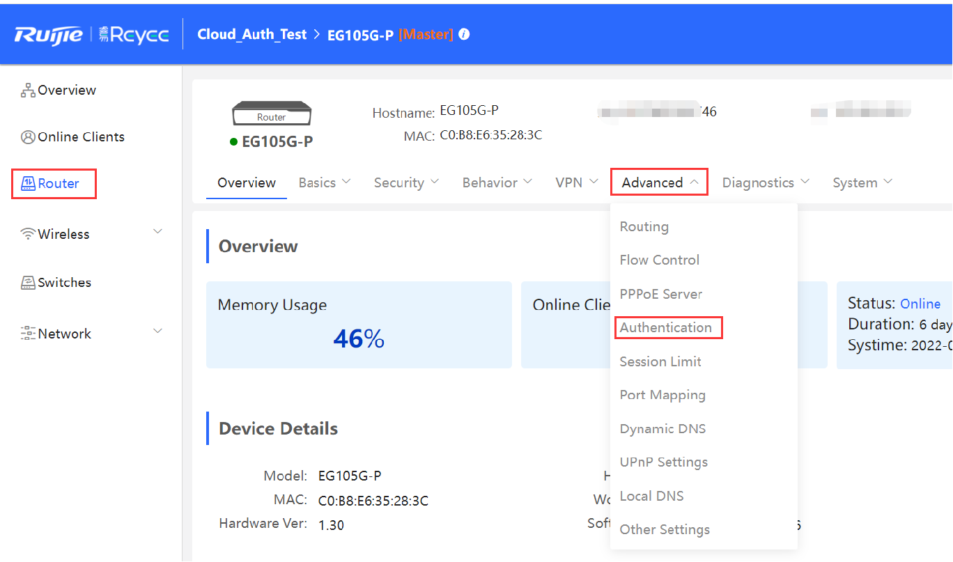

Step 4:enter the eweb of Reyee EG
Step 5: enter the ‘Authentication’page of this Reyee EG.
Step 6:Click the ‘Cloud Auth’, you can see the Authentication was enabled, and the IP range was synchronized to here.

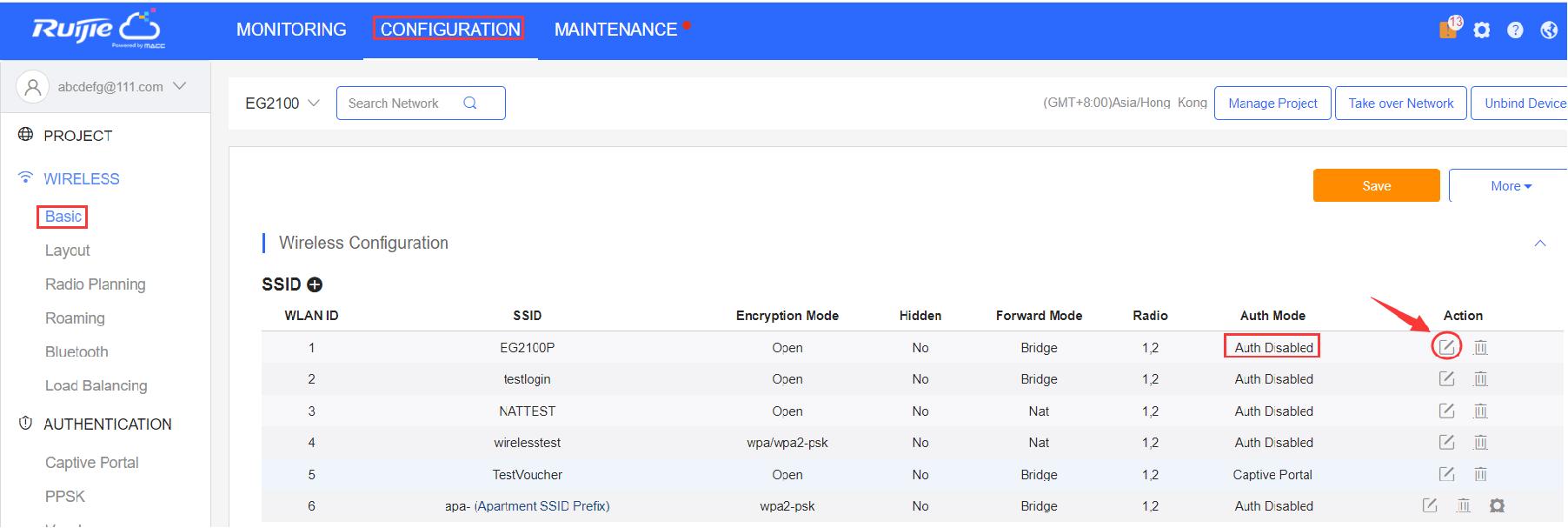

Scenario 3. Captive portal authentication  with Ruijie AP

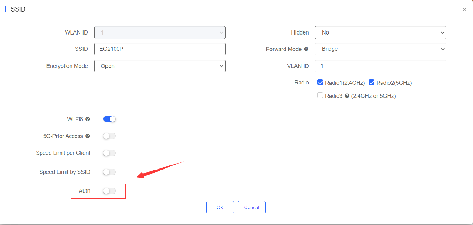

Step 1:enter the wireless basic configure page and choose the SSID need the auth
Step 2: enable the ‘auth’ in this page.
Notice: only the AP captive portal need to enable the ‘Auth’ in this page

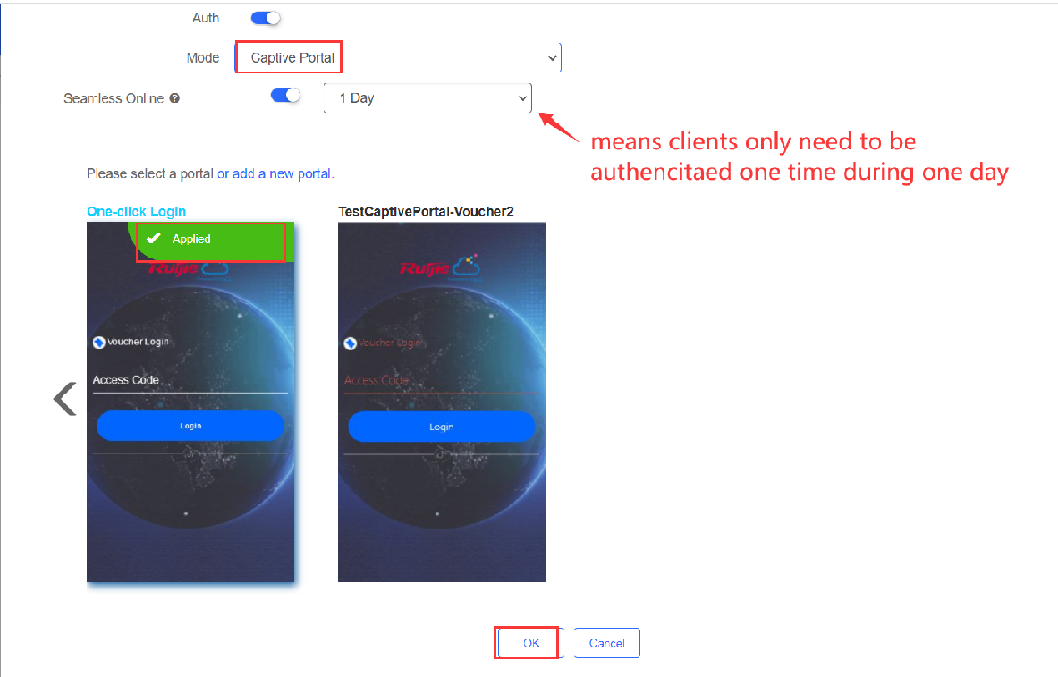

Step 3: after enable the auth, need to chose the portal template to be used and set the seamless duration.

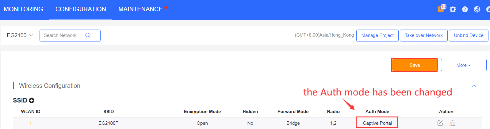

Step 4: after lick the ‘OK’, the auth mode has been changed. In the end, don’t forget to click the ‘save’option to save all configuration.
