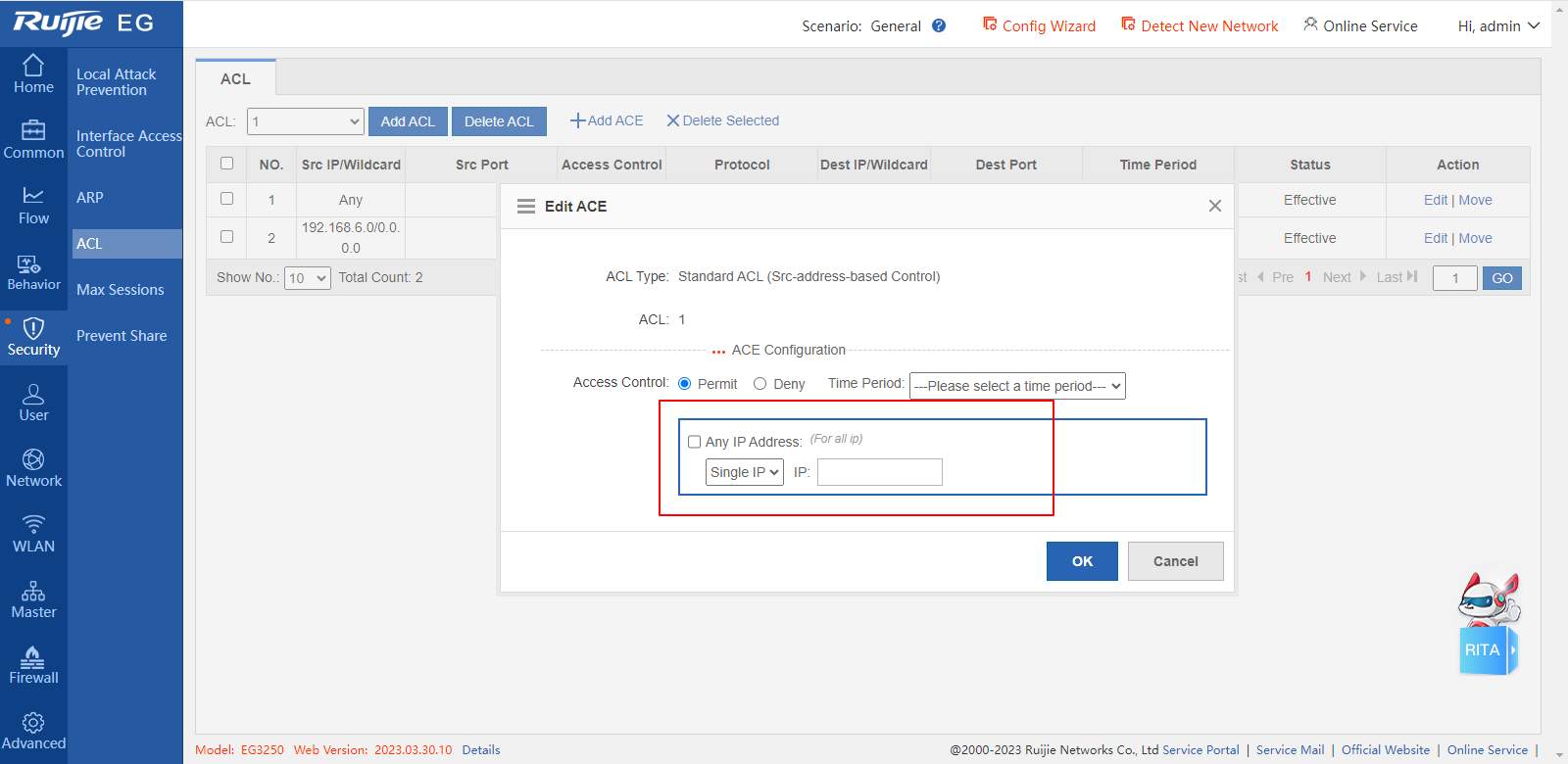

I want VLAN 1 go through WAN 1, VLAN 2 go through WAN 2, how can I do it?
You can use the policy route to do it, for example
     vlan 1 is 192.168.1.0   vlan 2 is 192.168.2.0.
     WAN 1 is 10.100.10.1,  gateway is 10.100.10.254
     WAN 2 is 10.100.11.1,gateway is 10.100.11.254
Step 1 click route policy-base route, click add ACL
Step 2, Add two ACL 10 and 11,set ACE to permit 192.168.1.0 and 192.168.2.0
Step 3 Configure Policy route
Finished

this is for VLAN, what about specific IP address (one client/server) only?
0 2023-7-20 13:23:25 View all replies
The Wi-Fi Hero replied at 2023-7-20 12:48
You can configure the ACL  to match the specific IP address here and apply the ACL on different PBR rules.

do i have to enable default route for both WAN?
0 2023-7-21 09:51:55 View all replies
The Wi-Fi Hero replied at 2023-7-21 09:44
Yes, the default route will be added by default when you set the port to WAN port to make sure the user internet access. You can type this command: show ip route to check the EG routing.
