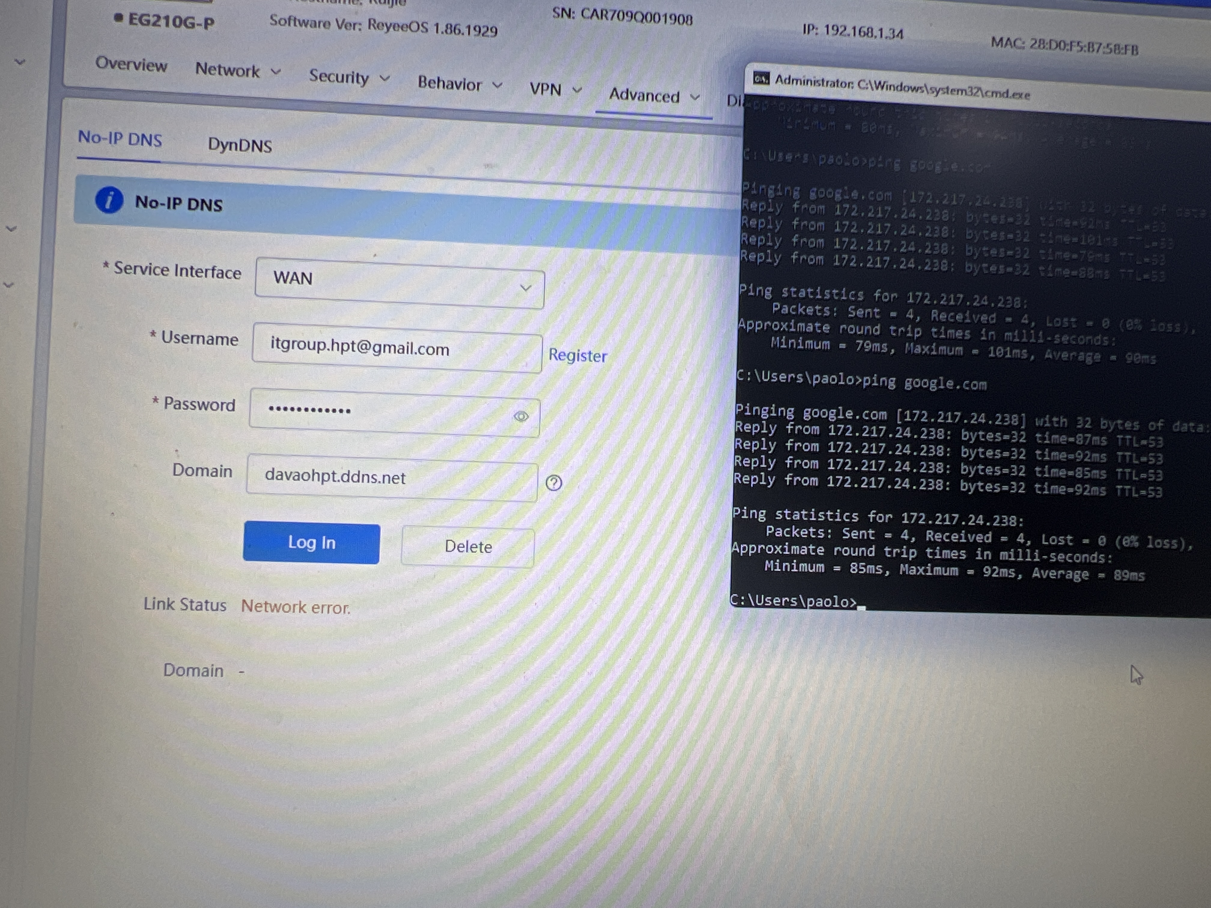

RG-EG210G-P cant connect DDNS server, always saying Network error but it has already have internet conenction.

    'always saying Network error but it has already have internet conenction.   ---- For judging this situation better. Could you please send some photos or videos about this issue?

Hi sir, can you access the EG via that domain --- davaohpt.ddns.net ?

Hi sir, the DDNS must bind a public IP address and domain, so need the EG have a public IP address. But in your picture, this EG now are using private ip address, so it won't works

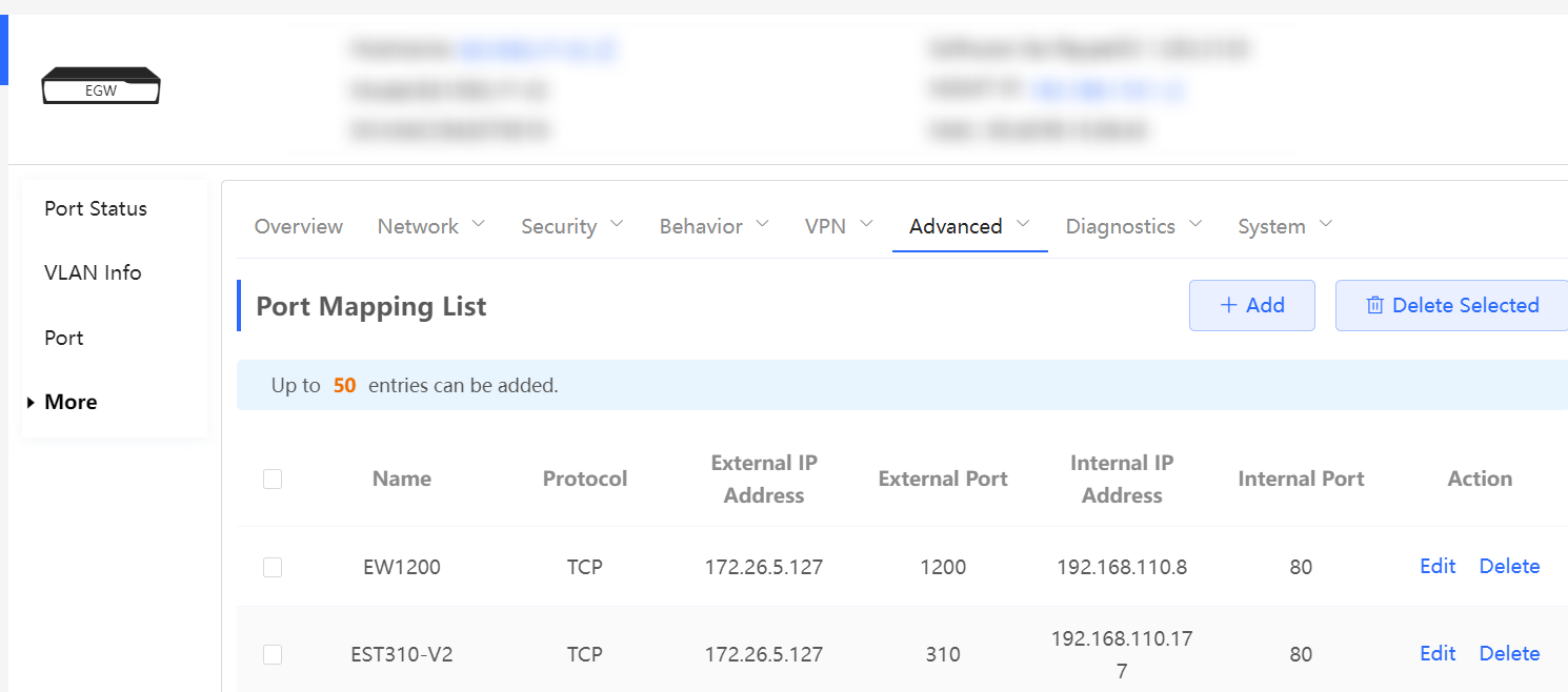

can you local login the server of this machine? can show us your port mapping setting page on EG ?

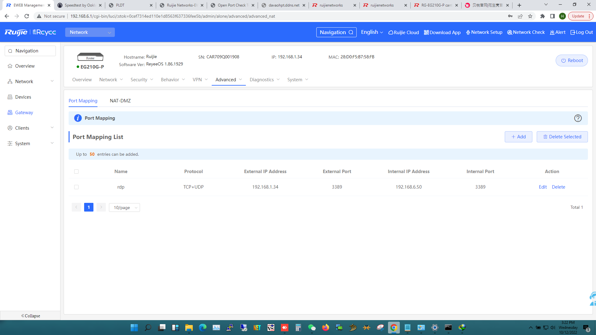

sir, sorry for the late response, I was on a tight schedule, here is my testing port mapping, RDP only for testing.. the machine is already configured to accept RDP so if the DDNS is working, then we should able to reach the device using RDP.

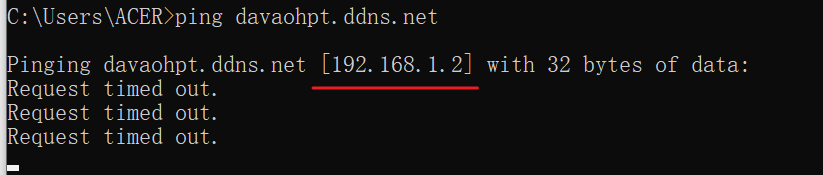

as the ping test, the DDNS already take effect, the doamin already bind to the WAN ip of  device. but we cant access the internal network of EG from external.
For the port mapping issue, can you local login the eweb of that machine locally? can you provide the detailed topology of your network to us sir
