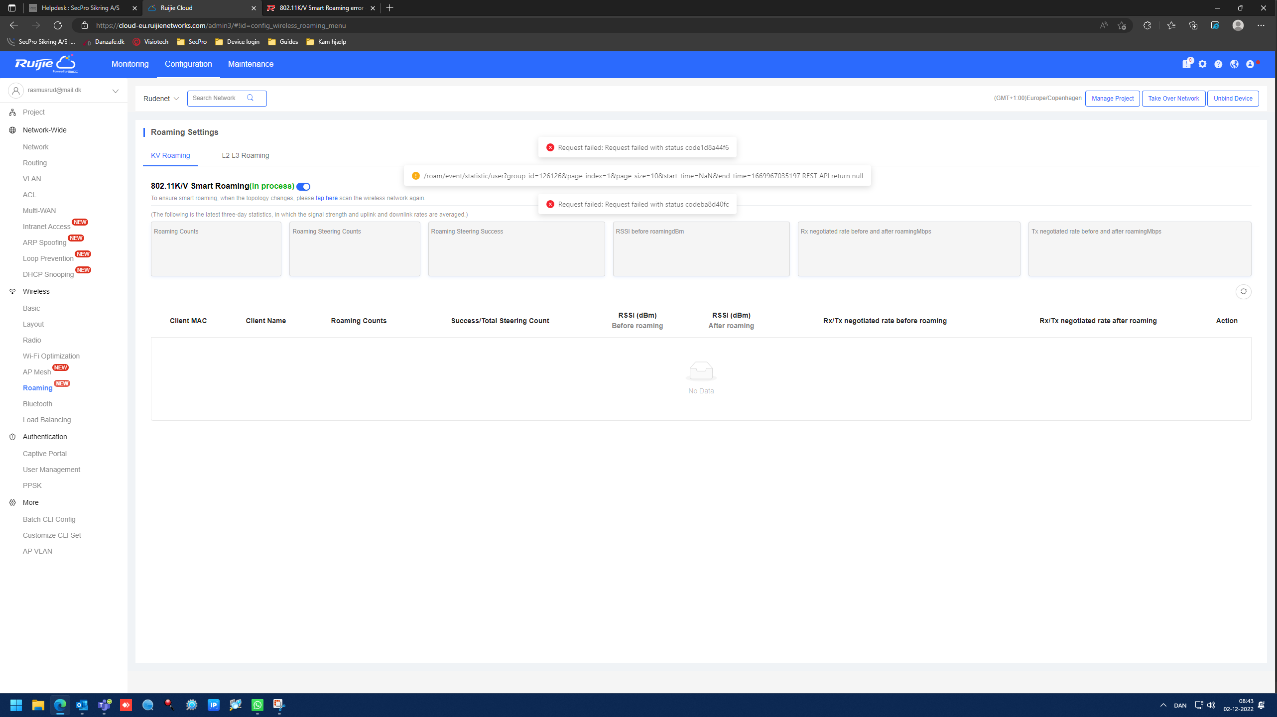

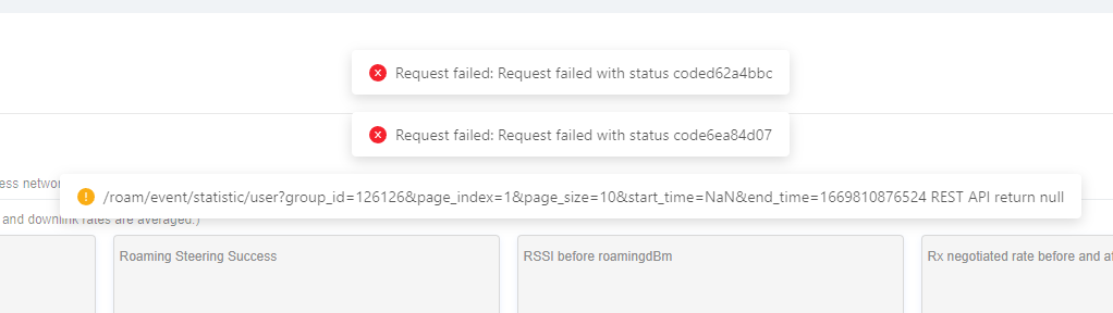

I wanted to try out the new 802.11K/V Smart Roaming, when i try to activate it i get this error codes on the picture below.
My network is 1xEG210G-P, 1xES205GC-P and 2xRAP2260(G).
What to do?
Question nr. 2: Is there way to check these error codes?

Dear sir,
Has your topology changed? You can update the topology and try again.

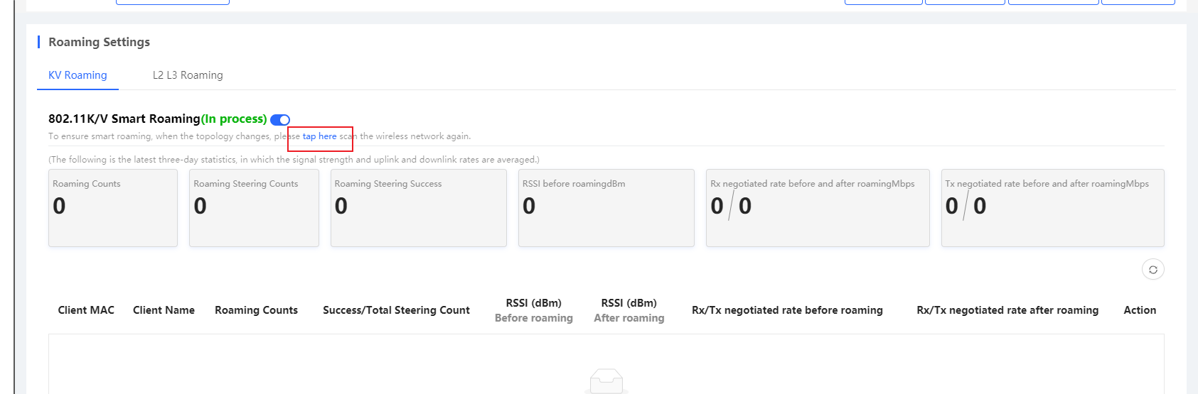

Hi
Clicking this resaults is the same error.
It have been set to "activated" all night but there is still no data.
0 2022-12-1 16:40:50 View all replies

Dear sir,
Can you share network with me,I check it for you.

Dear sir,
Now that the problem is resolved, you can check it.
Steve

Dear sir,
This is currently a regional reason,and cloud has been repaired. If you have this problem again, please feel free to contact us.

Hi
i just checked, it is still the same issue.
This screenshot is from right now.

Hi sir,
I just tested that your network is normal, could you please share the wrong network with me?
Steve

This is sadly not fixed, i hope a update in the future will fix this issue.
The function does not work as of now.

Hi sir,
You can try it now. A patch has been applied today. I'm sorry for the inconvenience.

Hi Steve
This is working now, the patch worked !
