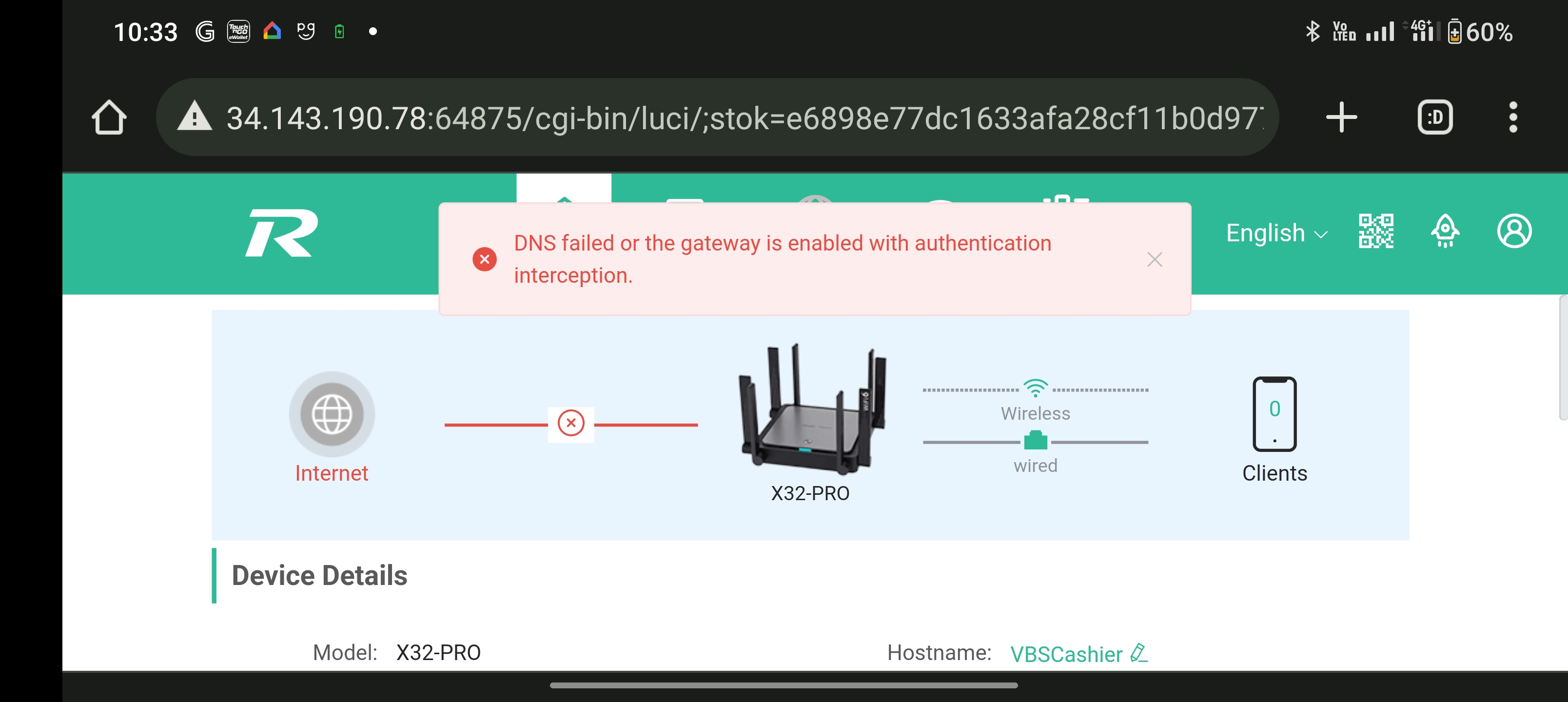

Hi team,
I can see this error in my dashboard.
How to solve this?
RG-EG105G-P
Router

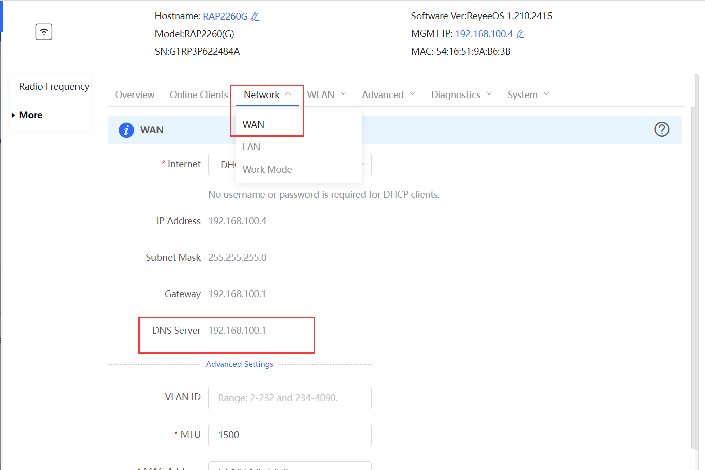

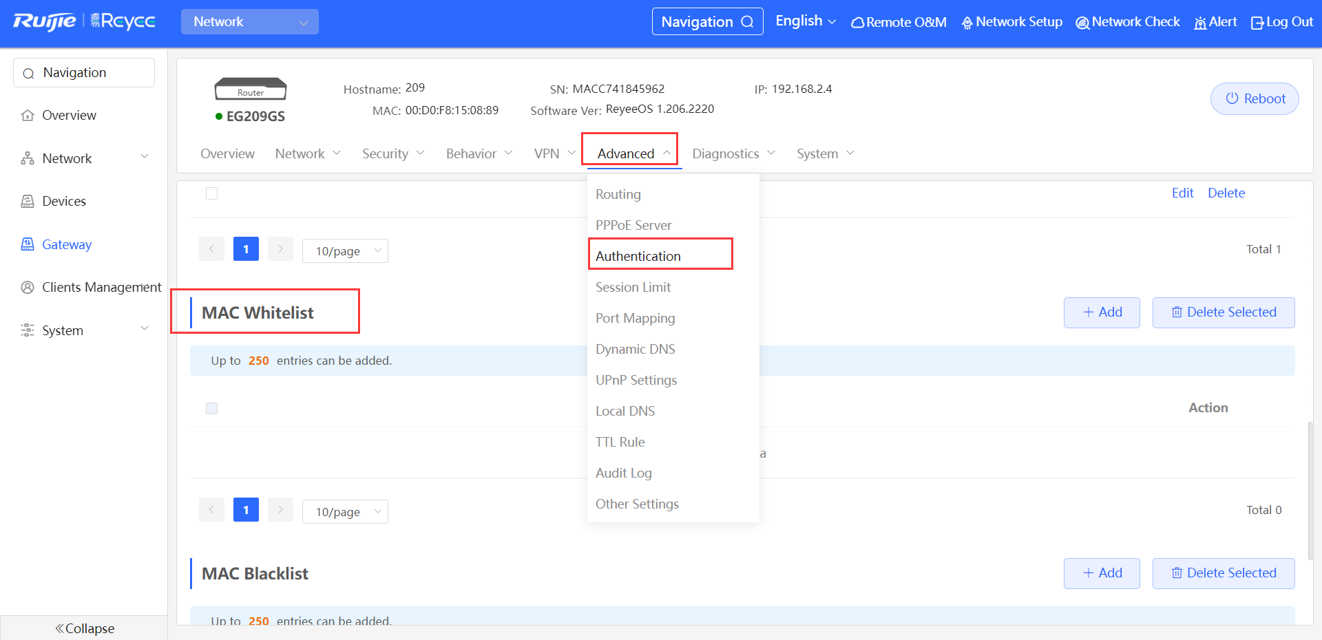

That means your device cannot get the Internet. Please help check whether your device has configured dns server ip. If your eg has enabled authentication, please remember to add the network devices mac address to the whitelist.

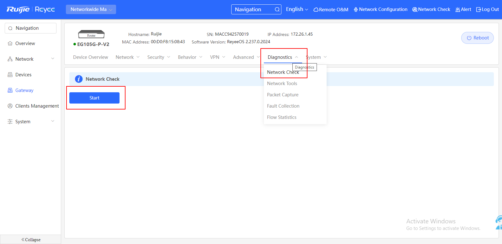

May I know your network topology? Can you login to the router local eweb interface and do network diagnose to further check whether it can get the Internet normally?

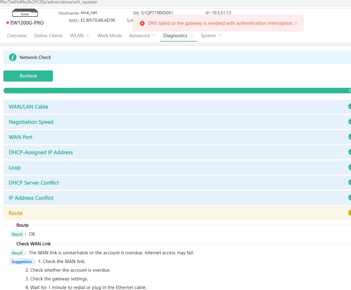

pls. see my screen shot i have the same problem
Dear,
plz check the gataway device that's connected to your EW1200G-PRO,and check if DNS address has been settled. For further assistance, plz visit our Rita: www.ruijienetworks.com/rita
