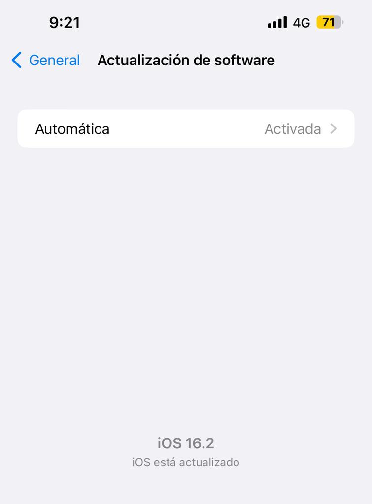

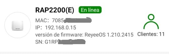

Good morning Patrick, I am attaching the firmware version of the APs and the IOS version of the Apple devices, I will post the video here in about two days after I am home and make the video. But if with this information you can see what the problem could be, I would really appreciate it.
