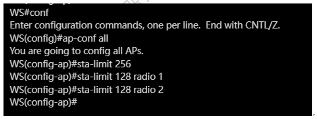

For ap-config command:
Configure for all AP:
WS>en
WS#conf
WS(config)#ap-conf all
You are going to config all APs.
WS(config-ap)#sta-limit 256
WS(config-ap)#sta-limit 128 radio 1   --- set limit of 2.4G to 128
WS(config-ap)#sta-limit 128 radio 2   --- set limit of 5G to 128

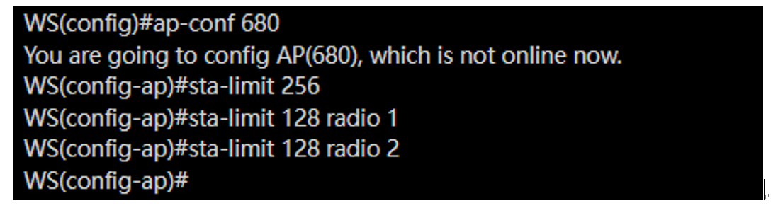

Configure for a specific AP:
WS>en
WS#conf
WS(config)#ap-conf 680

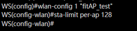

For wlan-config command:
WS>en
WS#conf
WS(config)#wlan-config 1"fitAP_test"    -----"fit AP_test" is SSID name
WS(config-wlan)#sta-limit per-ap 128     -----set sta-limit to 128 per AP
