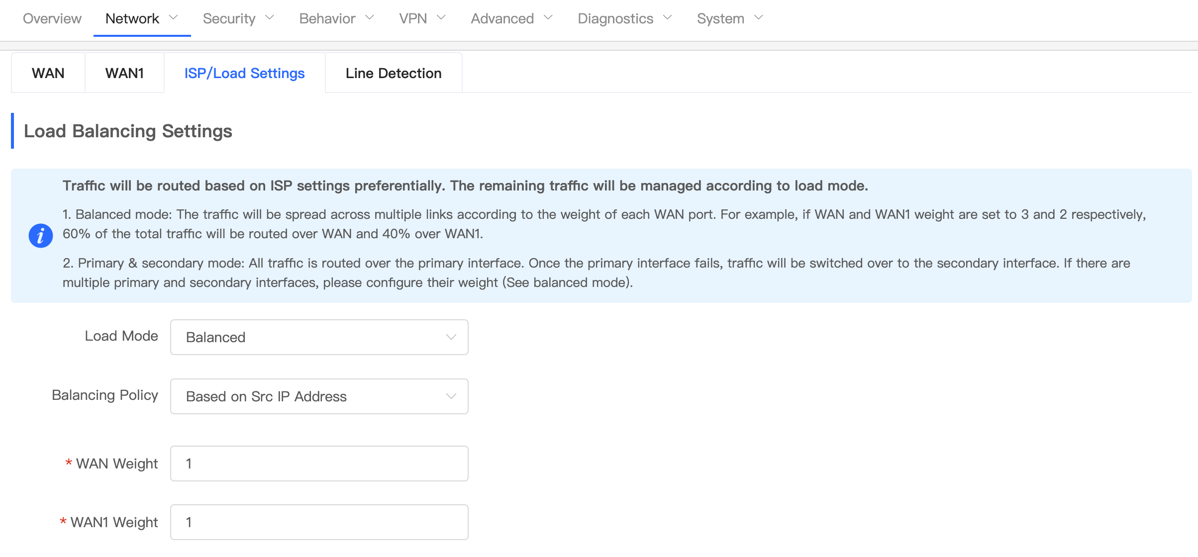

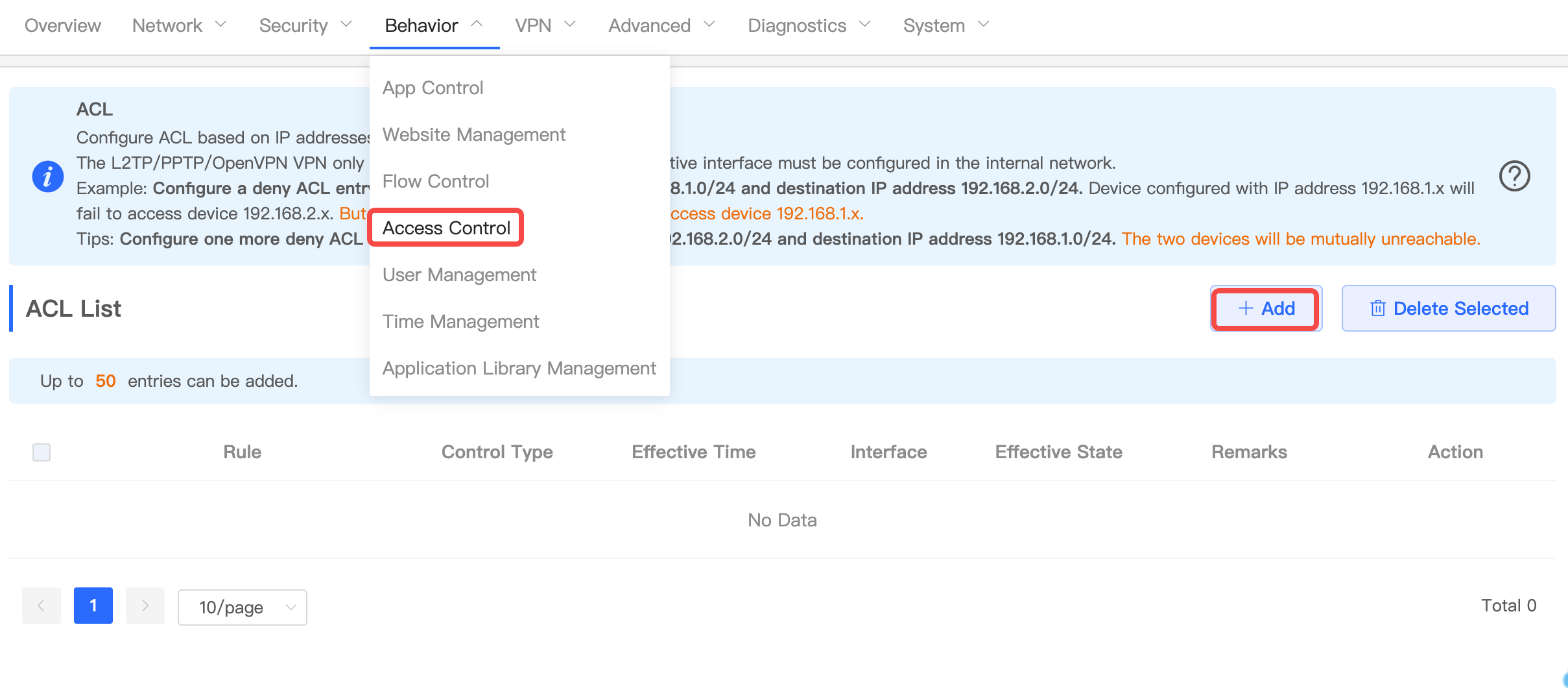

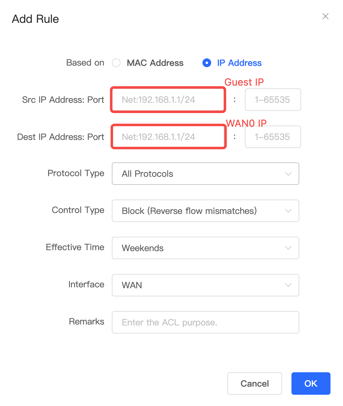

Hi bro,
You can configure load balancing on EG, and then configure ACL to filter traffic.
1.Configure Load Balance
2.Configure ACL: Block Guest IP address pass through WAN0
0 2023-2-10 01:03:53 View all replies

hi bro thanks for your reply .
but it doesn't work. still the guest Wi-Fi can access the internet throw wan-0
simply. the need is
Wi-Fi employee use only wan-0
Wi-Fi guest use only wan-1
no balance or fail over need.
my network config ,
Wi-Fi emp ip(192.168.22.1)vlan defult  / wan-0  ip (192.168.3.11)
Wi-Fi guest ip (192.168.33.1)vlan33 / wan-1 ip (192.168.5.13)
0 2023-2-10 12:26:56 View all replies

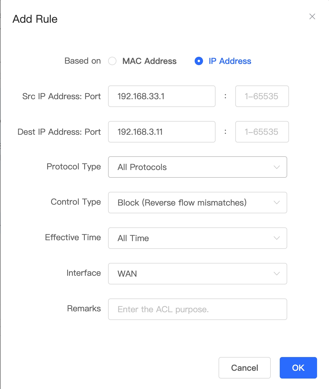

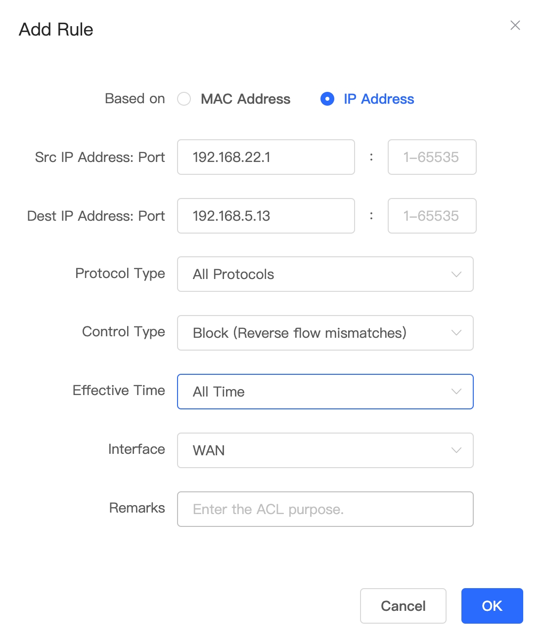

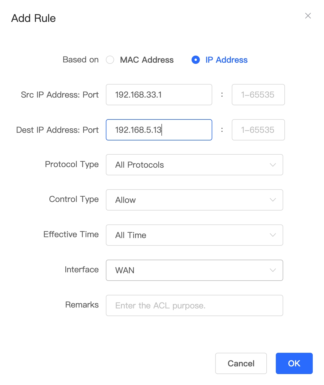

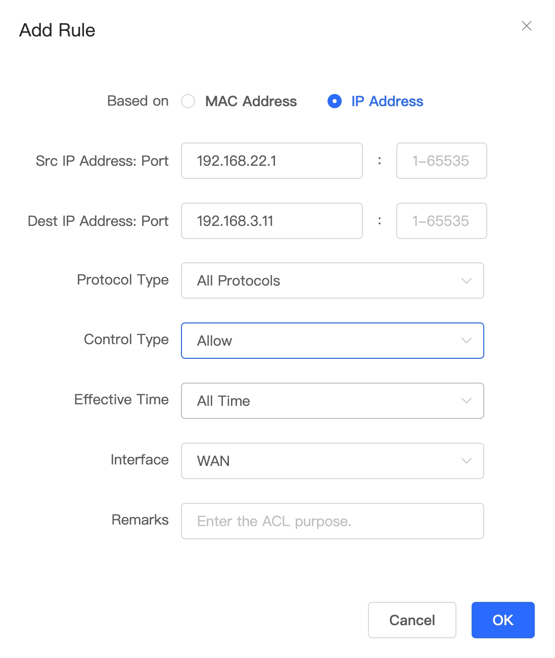

Bro, could you try the following configuration?
0 2023-2-13 02:11:17 View all replies
Toby1 replied at 2023-2-10 12:26
bro
the same doesn't work. still Wi-Fi guest can access internet throw another wan .
i reset all the project and reconfigure all devices. but same result
i think this device can't be secure on network. and can't divided wan's
0 2023-2-13 09:22:06 View all replies
