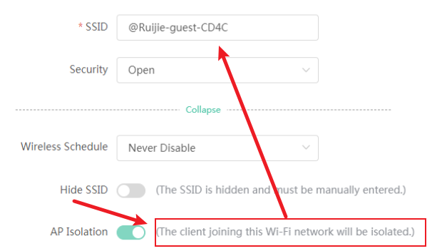

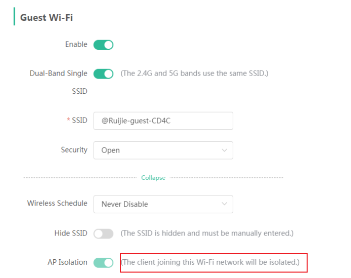

1. As I said before, the guest wifi on EW router will only isolate the guest user who connect to guest wifi, pls kindly see the introduction on the guest wifi menu on EW router. You need some device

Please kindly see the description on the eweb > guest wifi setting on Reyee EW router.
For example,
2 SSIDs: Ruijie-guest-CD4C(guest wifi),ruijie-ew(normal wifi)
2 users connected to Ruijie-guest-CD4C, then can not reach each other, but still can reach the normal ssid and your local network.
I'm sorry for your inconvenience again. I will feed back this request to my team.
