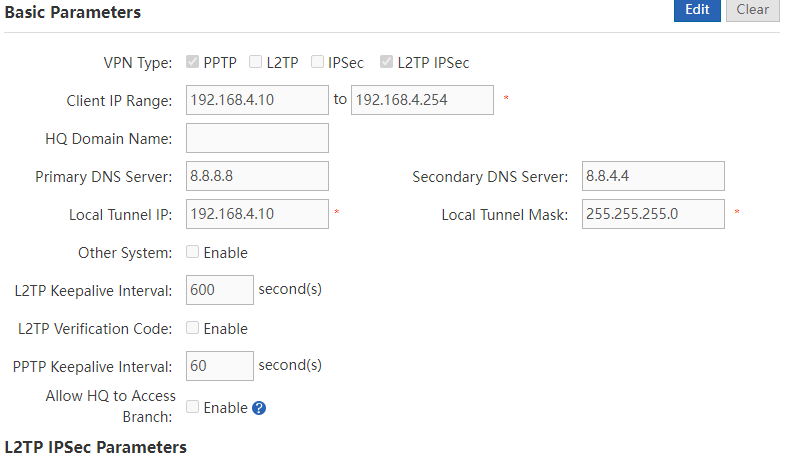

Hi!
I Configured VPN on EG2100-P and I can connect with VPN ip but I can´t access local devices from VPN client? could some help?
Thanks!
RG-EG2100-P v2
Router Troubleshooting Configuration VPN

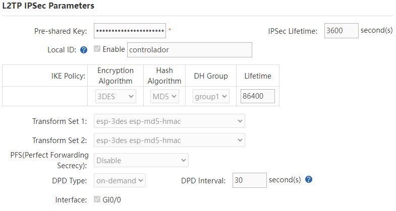

is it what you need?
Thanks!

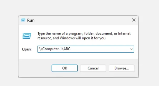

May I know whether smb share is refer to this?
Btw, may I know issue phenomenon screenshot pls?
