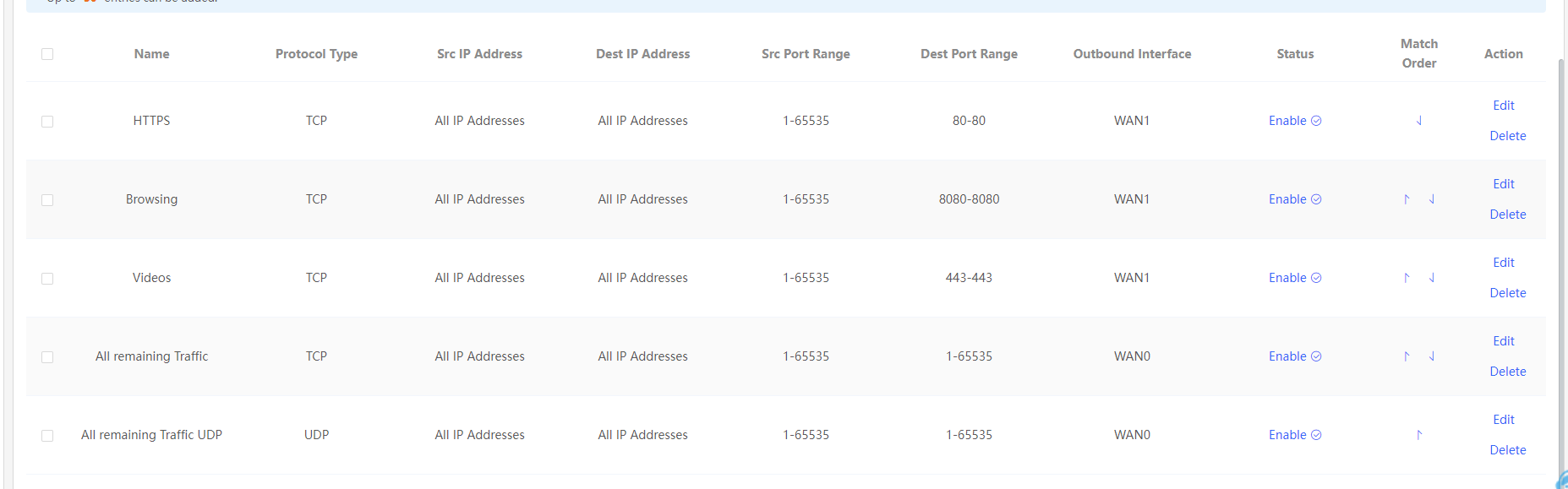

Currently this is my config when separating the connection via port number, not sure if this is correct but i check on the real time flow isp are both working. maybe someone that is knowledgeable that can confirm or add something on my config to work properly. Currently using EG210G-E

The PBR can only control the outbound port of the packets based on the source/destination  IP address or source/destination port you set. It cannot identify whether the data stream belongs to the gaming.
So it can not  separate gaming and streaming with 2 ISP.

What I mean is that port for streaming and browsing which is 80 , 443 , 8080 ports will be rerouted to ISP 1 then maybe other port like gaming port will be on ISP 2
ISP 1  - Steaming and Browsing
ISP 2 - Gaming
0 2023-3-26 22:01:54 View all replies
unknown unknown replied at 2023-3-24 20:07
What I mean is that port for streaming and browsing which is 80 , 443 , 8080 ports will be reroute ...
According to your configuration, you just set traffic of 80, 443, 8080 ports
will access Internet via WAN1.
Games are also divided into client side and web side, there are some web games also need to use these ports. However, some video software, may need to use more than these ports.
So the distinction between video streaming, game streaming and web streaming based on these ports may not be completely distinct.
If you just want to differentiate based on the 3 ports above, you need to add a rule at the end with all remaining traffic will access Internet via WAN0. Because this matching rules are from top to down.

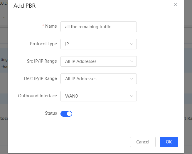

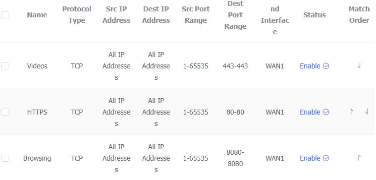

Is this what you mean?
Thank you for the response.
0 2023-3-28 12:04:31 View all replies
If you want TCP remaining traffic to access the Internet via WAN0, other remaining of the traffic randomly accesses the Internet via WAN 0 or WAN 1, then your configuration is correct.
If you want all remaining traffic to access the Internet via WAN0, you should configure it as follows:
0 2023-3-28 13:26:03 View all replies
