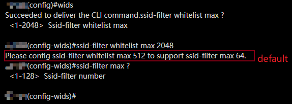

Default value:
ssid-filter whitelist max is 512.
ssid-filter max 64
512*64=32768
It means SSIDs that are configured as whitelists support up to 64 SSIDs, and each SSID can have up to 512 STA capacity under it
If you want to expand this STA capacity to latest 2048, you need to adjust the ssid-filter max number to 16.
2048*16=32768
0 2023-4-4 08:32:46 View all replies

As I said before, this is related to ssid-filter max number.
32768÷1024=32
So you need to adjust this number to 32 by using this command first: ssid-filter max 32
then set the 1024: ssid-filter whitelist max 1024

Hi sir, this is related to ssid-filter max number.
32768÷1024=32

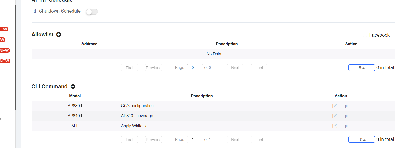

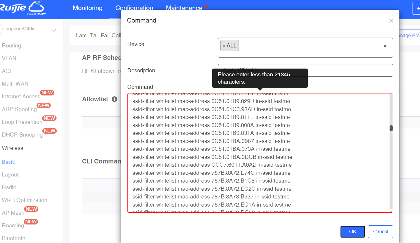

Thank you so much.  I have couple more questions
(1) Is there a way to increase the field limit 21345 characters? when I tried to insert 1000 entries on the whitelist into the CLI command box. it fails
If I split these command into 3 commands, are there any sequence of execution esp after I reset an AP
e.g.  when I create 3 CLI command "Apply whitelist 1","Apply whitelist 2" and "Apply whitelist 3", will be there an order of execution ? because I included a reset whitelist command on the first "Apply whitelist 1".
Thanks in advance.
James
0 2023-4-17 13:46:09 View all replies
Lam Tai Fai College Wifi replied at 2023-4-17 09:28
(1) Is there a way to increase the field limit 21 ...
1. Sorry for your inconvenience, there is no way to increase the number because of the limitation on Ruijie Cloud.
2.These commands will be execute at the same time, not an order.
