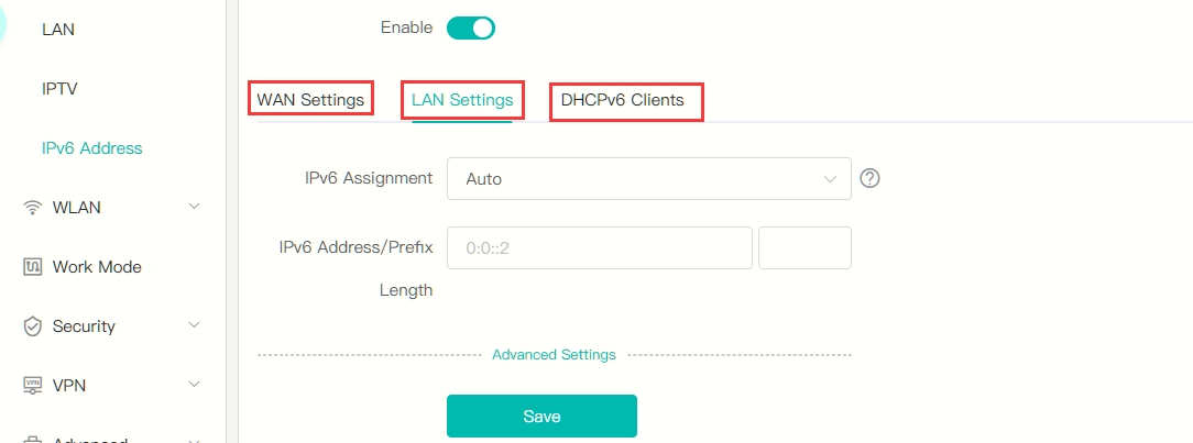

1.could you provide these information,and whether the devicesobtained  the ipv6 ip address?

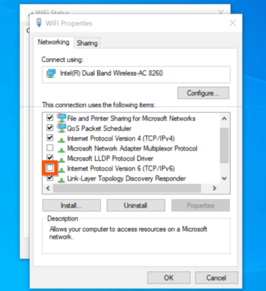

2.could you check if  the termaiIif ipv6 enabled on the terminal
3.If none of the above steps work, reset yournetwork to see if it will work.

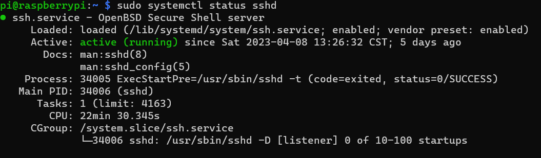

Sorry for late reply! I have tried what you said, but I still can't solve the problem.
I have done much more test. Here are the results:
Firstly, Windows have no problem. The checkbox have been checked.

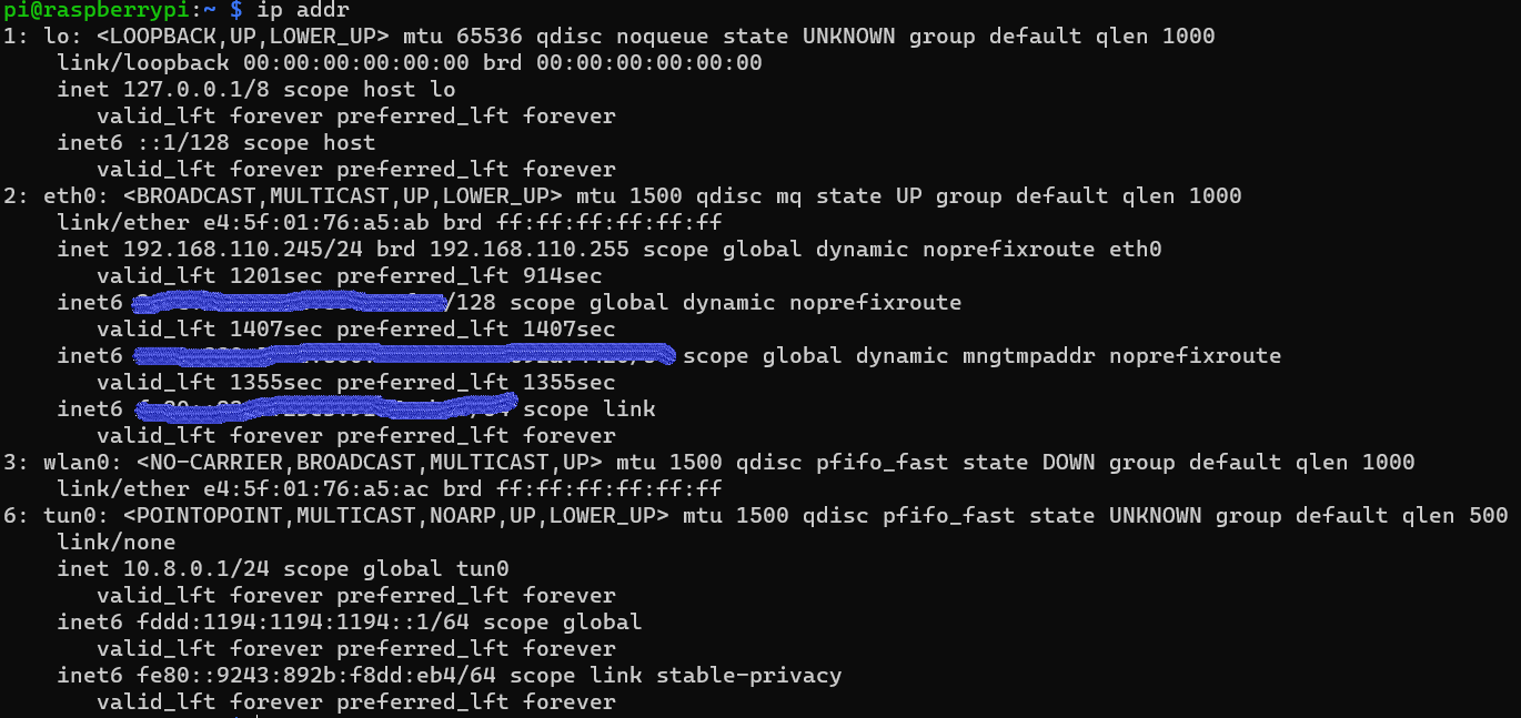

Secondly, my Raspberry Pi have received IPv6 address.  I ran 'ip addr' to check it.

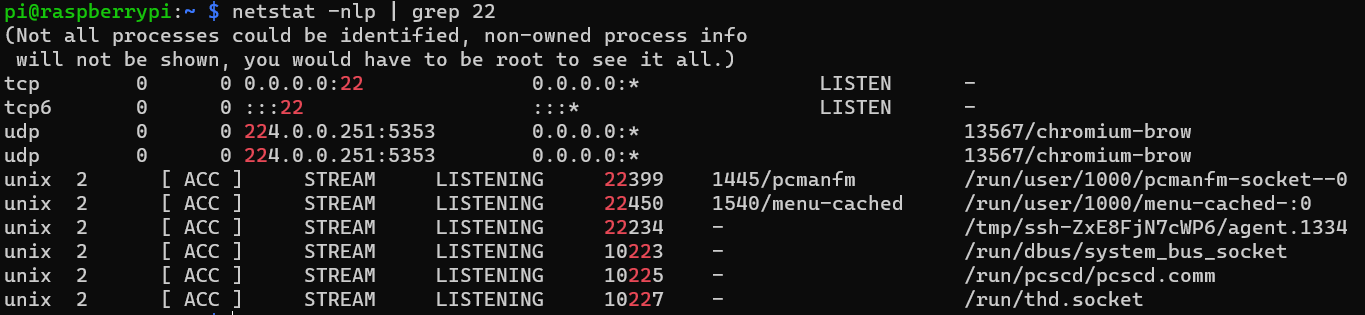

What's more, I am sure the sshd deamon is active and listening the right port. I ran 'sudo systemctl status sshd' and 'netstat -nlp | grep 22 ' to check it.

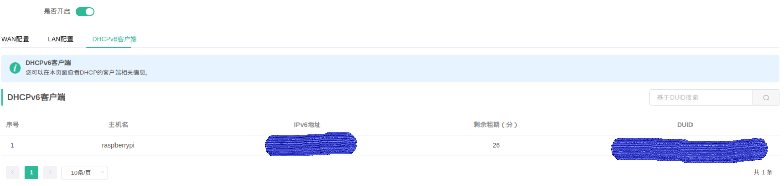

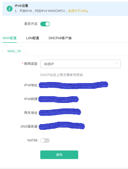

Finally, the router setting are as follows:
If the configuration is right, I just don't know what is wrong.

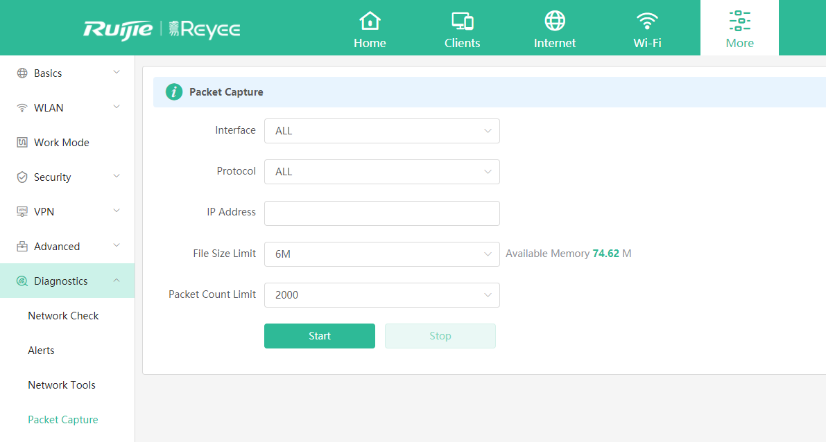

In that case, could you capture the package from the device when you try to login to the device with IPV6, like this
then send me the result,thank you for your cooperation.

I tried what you have suggested and attained the following results. It seems that the ipv6 tcp connection is reset each time a client tries to connect.
Capture Results
Please change the extension of this file to .pcap before you read it. (I don't know why attaching a file leads to a change of extension)
I tried to use ssh on ipv6 connect to the Raspberry Pi in the router's sub-network. It succeeded.
Based on this results, I have no idea about what happens. I think maybe I configure the router with some mistakes or your router has some bugs? I'm not sure about that.
