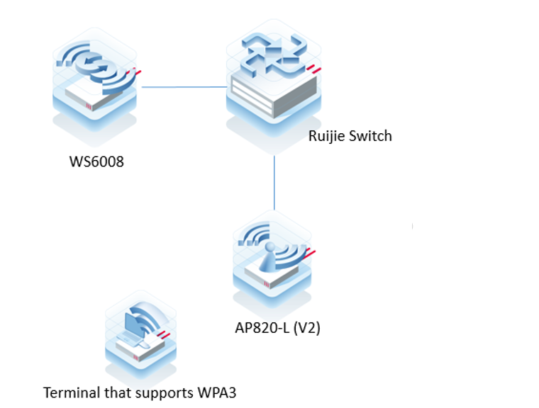

1.Topology:

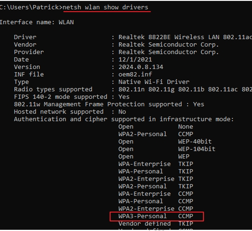

2.1 The wireless terminals should support WPA3-Personal. Otherwise, they will not be allowed to search and connect toWPA3 Wi-Fi.
For Windows, you can use this CMD command to verify: netsh wlan show drivers
For other terminals like mobile phones, please confirm with the vendor of your terminals.

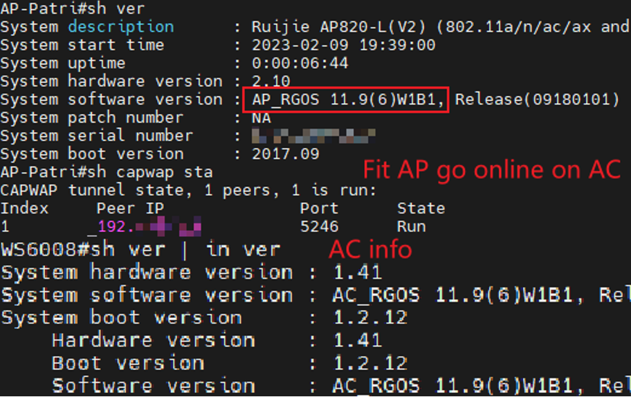

3.1 Please make sure that the firmware version of  Ruijie AP and Ruijie AC is W1B1 or later. And Fit AP needs to go online on AC.

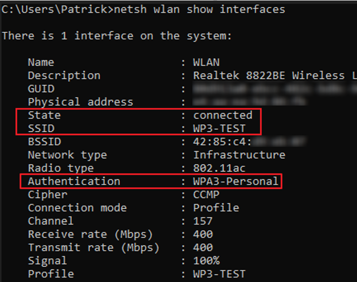

You can check the wireless adapter of your terminal after connecting to Wi-Fi.
Please note that with WPA2 or WPA3 access, this is the behavior of the terminal itself. The wireless device cannot decide.
Here is an example of Win10. Check it out by using this command: netsh wlan show interfaces

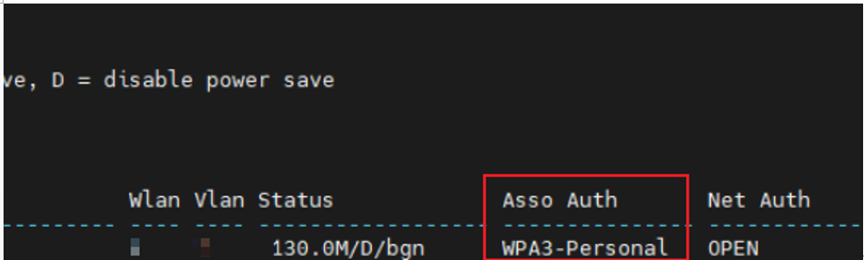

You also can use this checking command on Ruijie AC: show ac-config client
