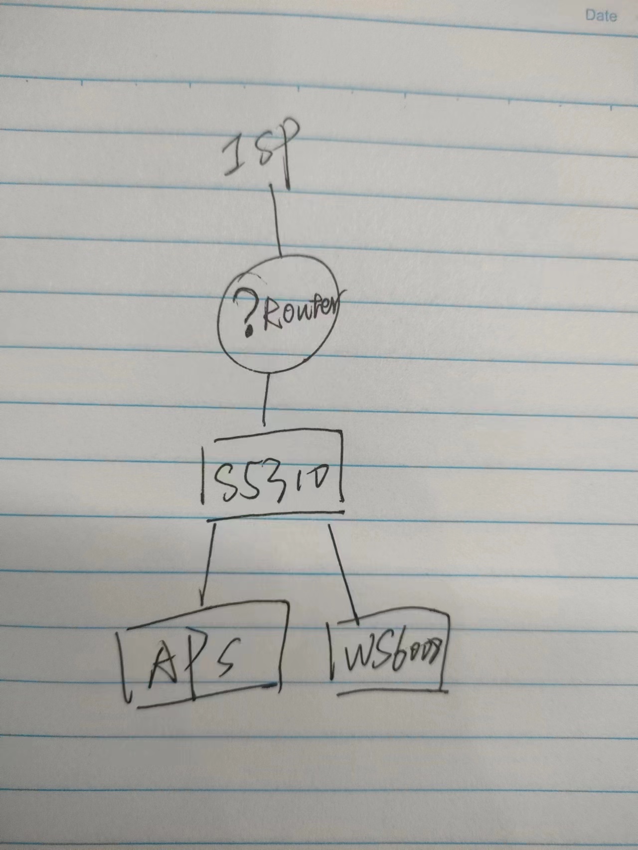

Your topology seems like this, right?
Cisco Meraki device is not the product of us, I'm not familiar with the specific functions. could i know what the specific router u used? but the default limit can be changed as follow:

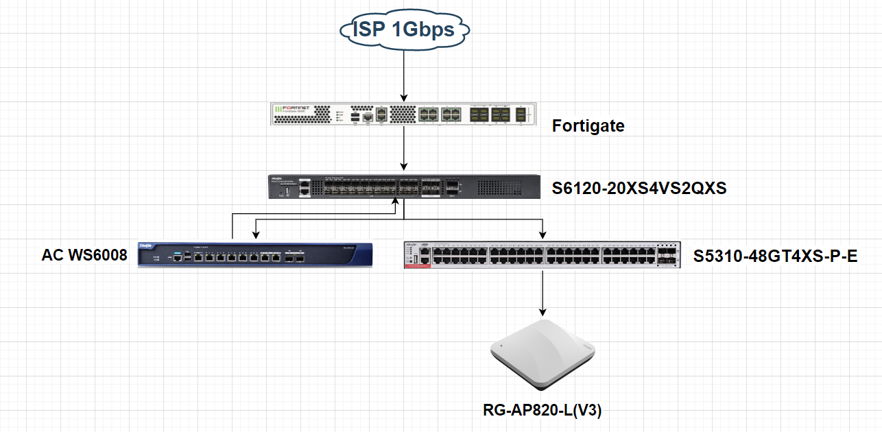

GTAC-Abigal replied at 2023-6-20 13:51
This is our network layout
There are no speed restrictions in the fortigate firewall.
If we are connected to the ethernet port of the switch we get around 500-700Mbps speeds and >10ms latency.
Only if the devices are connected to the Wi-Fi that the connection is getting worse, during teams and zoom calls, the latency is so but that the video feed gets pixelated and sometimes we got dropped calls.
The speeds for 2.4Ghz average to around 40Mbps and in 5Ghz it is around 90-120Mbps. Latency around 20 to 40ms
RSSI is around -40 to -60dBm in 2.4Ghz and 5Ghz even if we are right under the AP.
Firmware :
WS6008
: AC_RGOS 11.9(6)W1B1, Release(09192520)
S5310-48GT4XS-P-E:
S5310E_RGOS 12.5(4)B0702P3
S6120-20XS4VS2QXS : S6120_RGOS 12.4(1)B0102
AP820-L(V3) : AP_RGOS 11.9(6)W1B4, Release(09191916)
0 2023-7-26 16:26:46 View all replies
