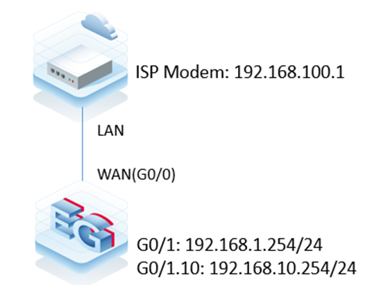

Topology:
Ruijie EG is connected to ISP Modem directly. And there are 2 local network segments for 2 intranet users.
