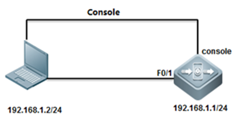

2.        Network Topology:

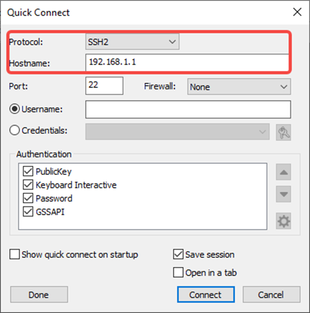

a.        Use SecureCRT or PuTTY to access the device CLI remotely via SSH:

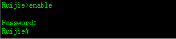

b.        Enter the correct username and password when prompted; once successful, the user mode CLI will show up and you may type 'enable' to enter privileged mode:

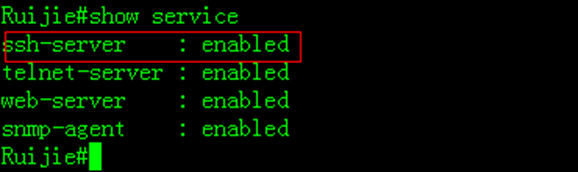

c.        Type 'show service' to check if SSH has been enabled:

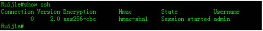

d.        Type 'show ssh' to view the SSH connection:

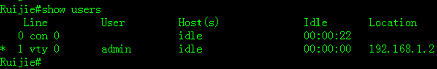

e.        Type 'show users' to view the users currently accessing the CLI:
In the example above, there is 1 console connection and 1 SSH connection accessing the switch CLI from IP address 192.168.1.2
