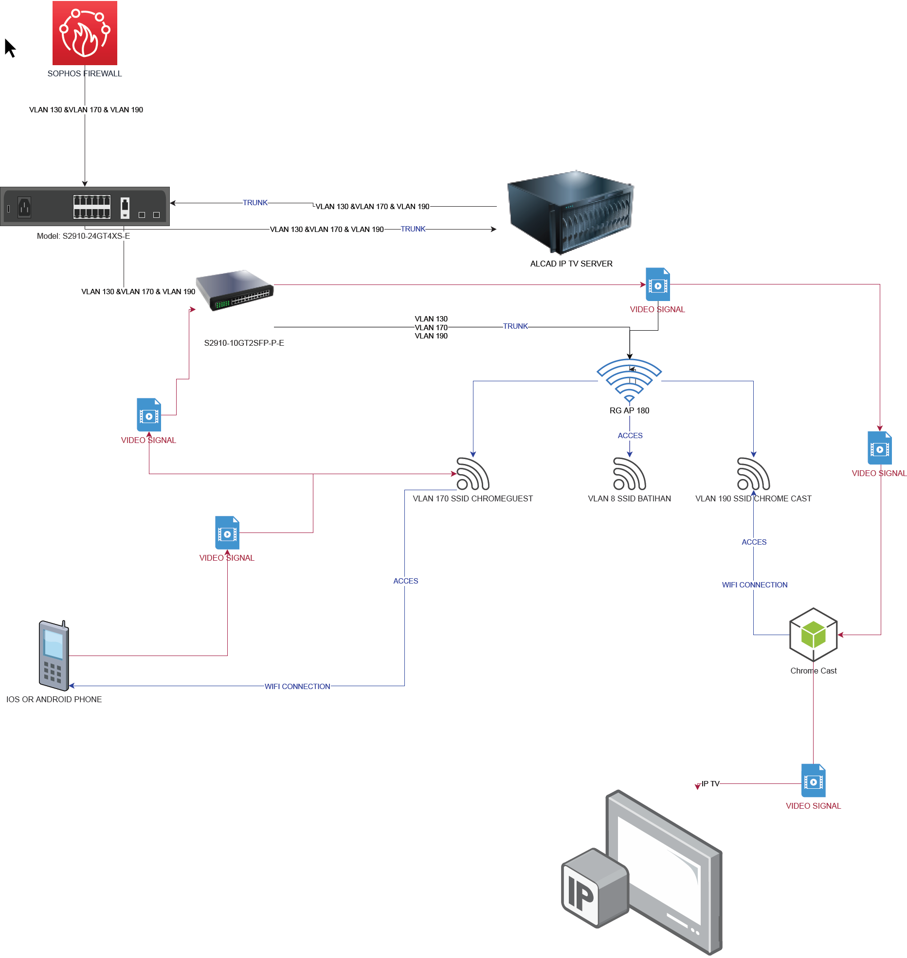

1. IPTV Vlan 130 (10.9.130.100 IPTV Server IP)
2.Chromecast Vlan 190 (10.9.190.x IP of any Chromecast device)
3.Guest Vlan 170 (IP of 10.9.170.x Guest phones)
Ouraim is to ensure that phone and tablet devices connected to the Guest Vlan(Vlan 170) can transmit images to the Chromecast Vlan (Vlan 190) under thesupervision of IPTV Vlan 130. For this reason, it is desired that no protocolblocks data transfer between vlans. Studies have observed that there areobstacles in the transfer between vlans. It is thought that the problem can besolved by enabling the MDNS protocol.

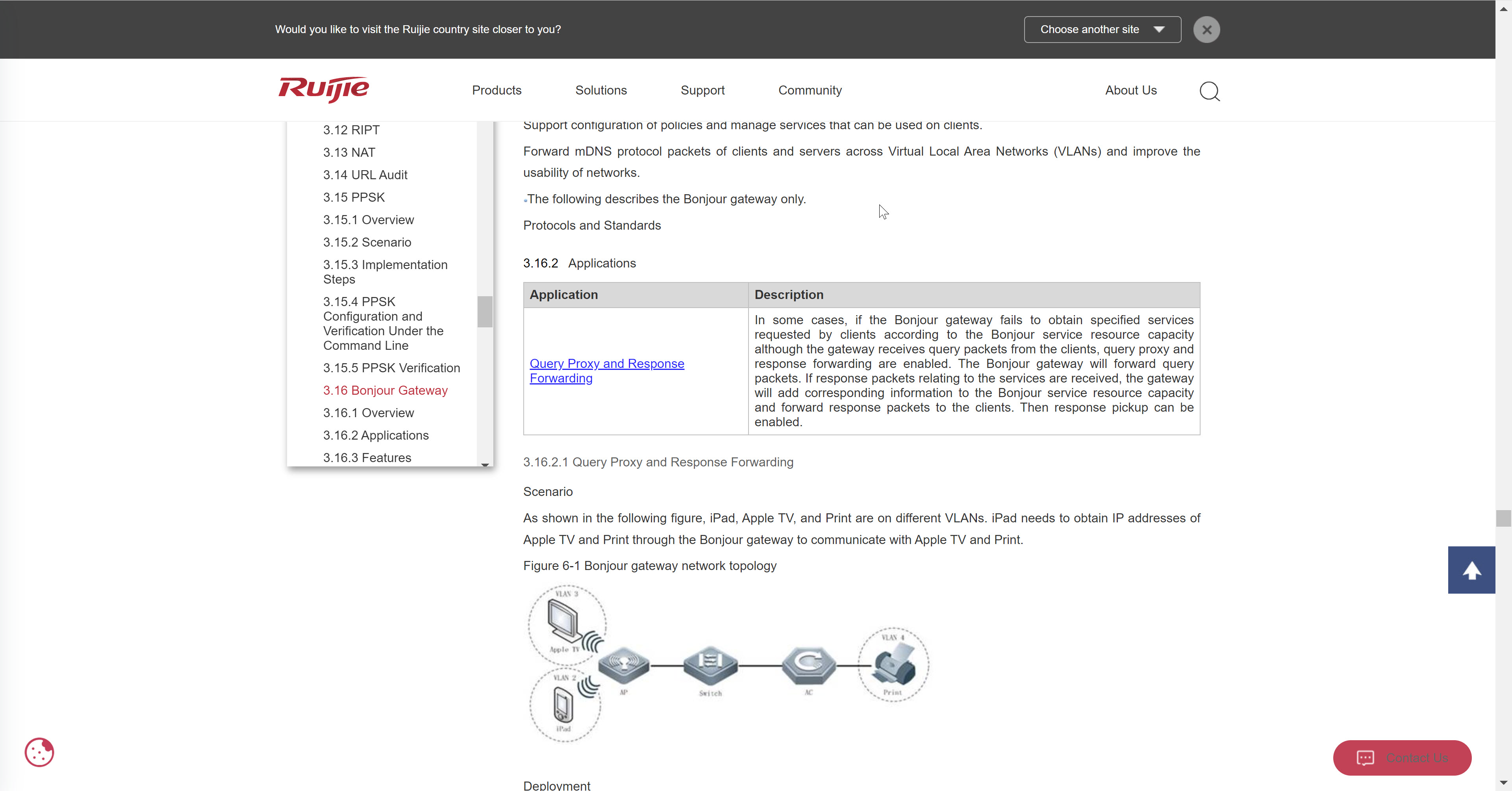

Therelevant 3.16.4.1 Enabling the Bonjour Gateway page of the Ruijie RG-WLANImplementation Cookbook (V4.1) of my request in question shows a similartopology. However, when I want to apply this recommended method, the switchdefines the commands incorrectly.
RG-S2910-24GT4XS-E

Dear Sir/Madam
Bonjour protocol can be enabled on Ruijie gateway products, it may not be available on S2910-10GT2SFP-P-E currently.
0 2023-10-11 22:02:42 View all replies
User 18152 replied at 2023-10-6 23:22
https://www.ruijienetworks.com/support/documents/slide_75752#_1.4.2_Configuring_Bonjour
Unfortunate ...
Hello Davit, First of all, thank you for responding to my topic. I thought I read in the above cookbook (Ruijie RG-WLAN Implementation Cookbook (V4.1)) that this can be done on the switch. Please correct me if I'm wrong. I leave the link below
https://www.ruijienetworks.com/support/documents/slide_75752#top
0 2023-10-11 22:15:12 View all replies
Emrah Güler replied at 2023-10-11 22:02
Hello Davit, First of all, thank you for responding to my topic. I thought I read in the above coo ...
Dear Emrah Güler,

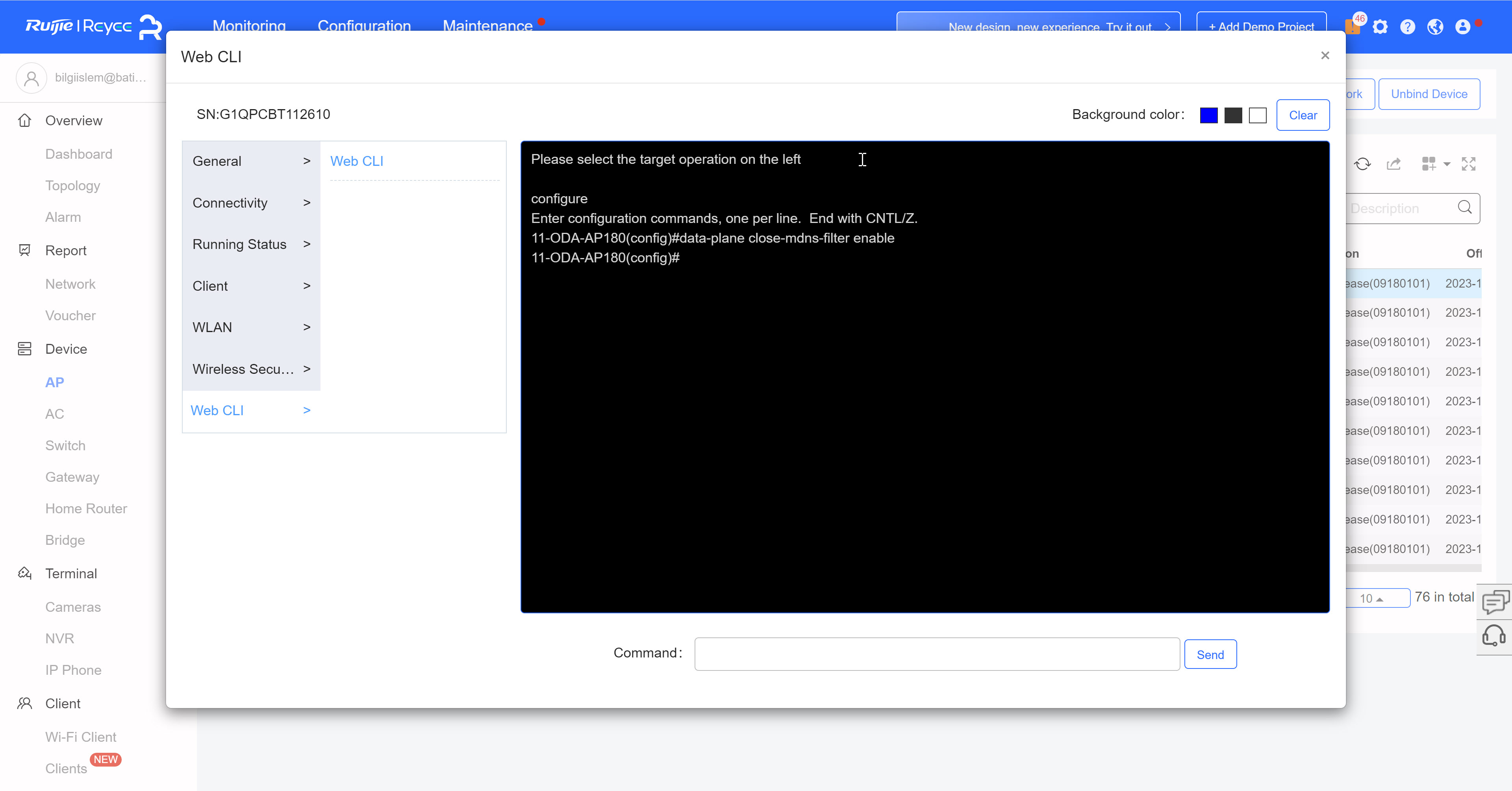

Please kindly note the Bonjour Gateway configuration is applicable to the Access Controller (RG-WS series). Your topology does not show an AC in the network, may I please know if the APs are running in fat or macc mode? Please try the following commands to allow mDNS broadcast forwarding on the APs?
Ruijie(config)#data-plane close-mdns-filter enable
Jayden

Jayden, I stated it as Ap180 in the topology, I think you will see it if you check it again. All Access points work in macc mode.
0 2023-10-11 23:16:00 View all replies
GTAC-Jayden replied at 2023-10-11 22:15
Dear Emrah Güler,
Please kindly note the Bonjour Gateway configuration is applicable to the Acce ...
Jayden Thank you, I applied the code you recommended to the AP. it was accepted, but shouldn't we write something in the switch section?
