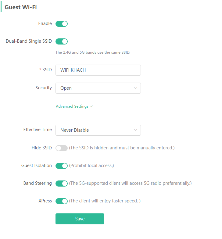

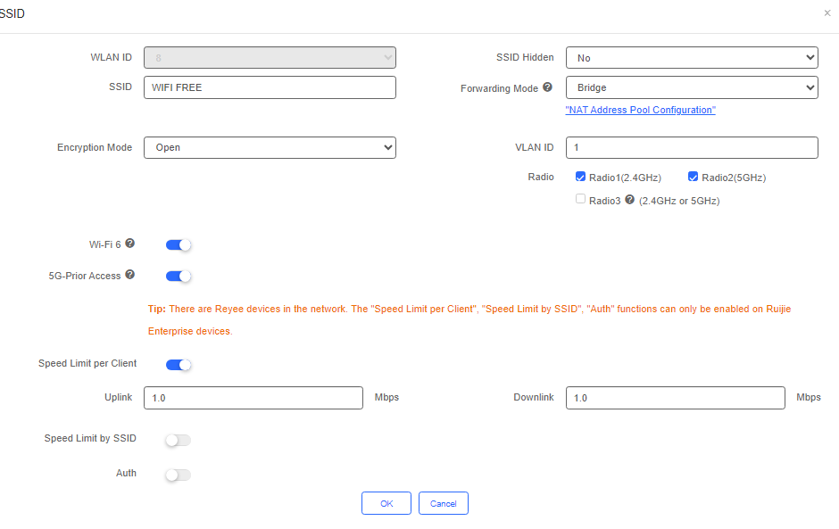

I see that the RG-EW1200G PRO has a guest wifi feature. When I turn on the guest wifi mode, why do the guest users still see each other? I have turned on the isolation mode. It is not safe for them to see each other like that. I want to completely isolate each other. all . Can it have VLAN?

Do you mean that users connected under the same guest wifi can access each other? Can I know what the current version is and how did you test it?

I use ip scan software and it still displays information about other devices. I set a bandwidth limit for the guest wifi and it doesn't work. If it is safe and secure, it will not be shown

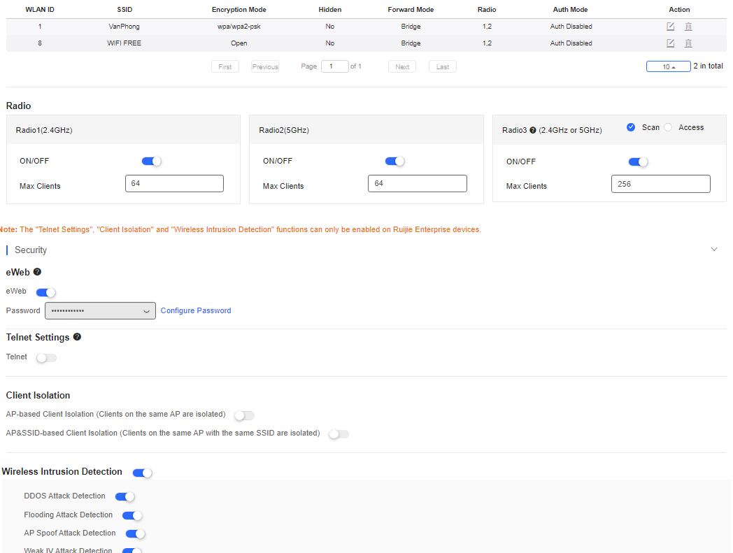

I need vlan on home wifi devices ew1200 and ew1200pro, please guide.

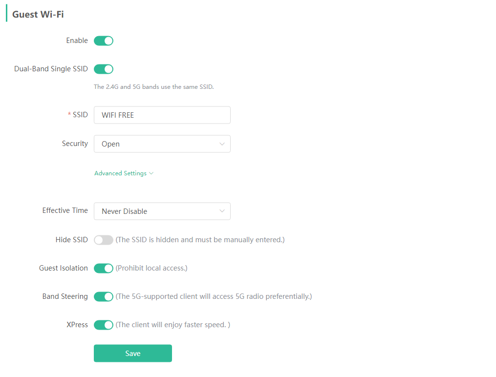

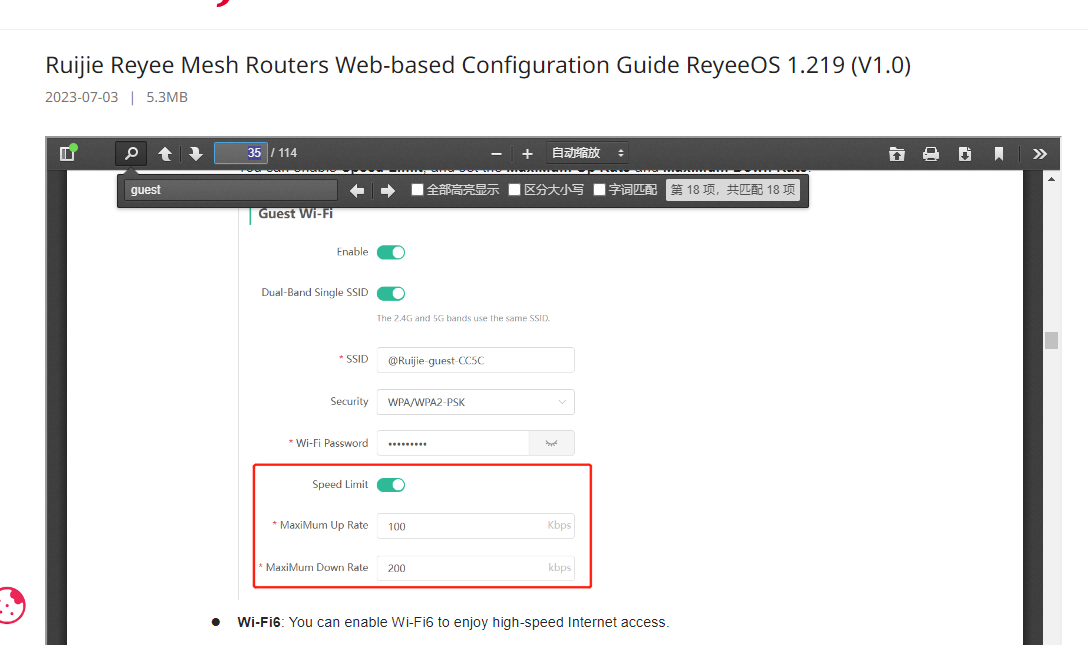

How to limit wifi guest bandwidth?

GTAC-Micca replied at 2023-10-25 20:02
you can check on this guide ( page 35): https://www.ruijienetworks.com/resources/preview/ruijie-re ...
I don't see ?

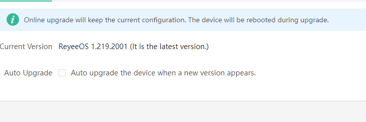

May I know you firmware version sir? Thank you,

ReyeeOS 1.219

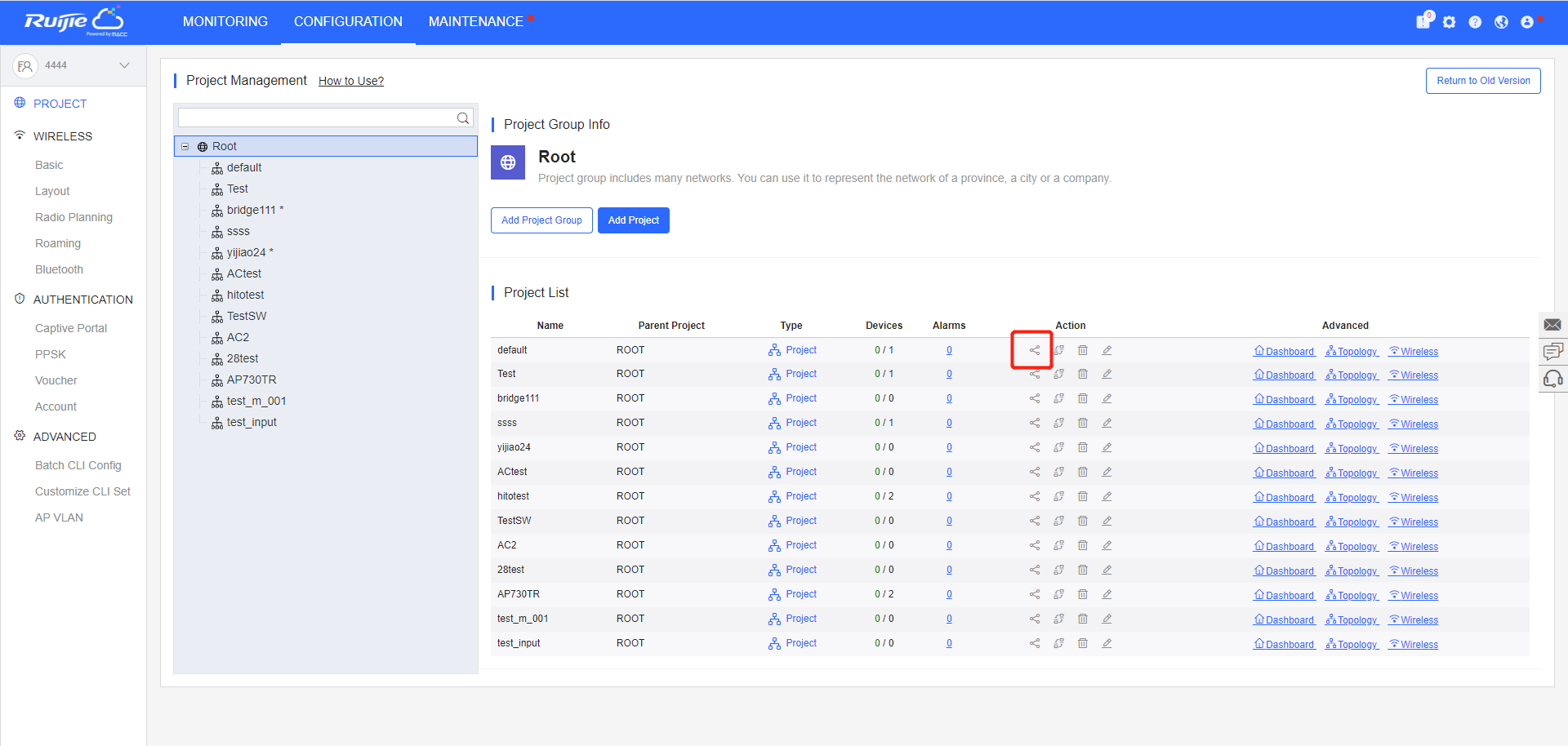

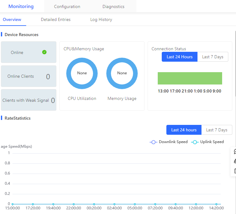

cloud error not showing any information

Please help share with me your network to my email: yujiamin1@ruijie.com.cn to further check this issue.

for guest wifi, may I confirm what it your device model? if it is EW1200G PRO, may you try to upgrade to this firmware version: RG-EW1200G PRO Wireless Routers Firmware - Ruijie Networks

GTAC-Jenny replied at 2023-10-26 15:54
Please help share with me your network to my email:  to further check this issue.
ok! I have shared network
0 2023-10-27 10:03:05 View all replies
Thank you for sharing. I checked all the EW routers can not display the log information on cloud normally, you may need to check whether the ports udp3478 and udp3479 have been allowed in your network first. And please also help share with me the network with write and read permission so that I can login to the router device to further check. I will not change any settings before your accept. Thank you for your cooperation.
