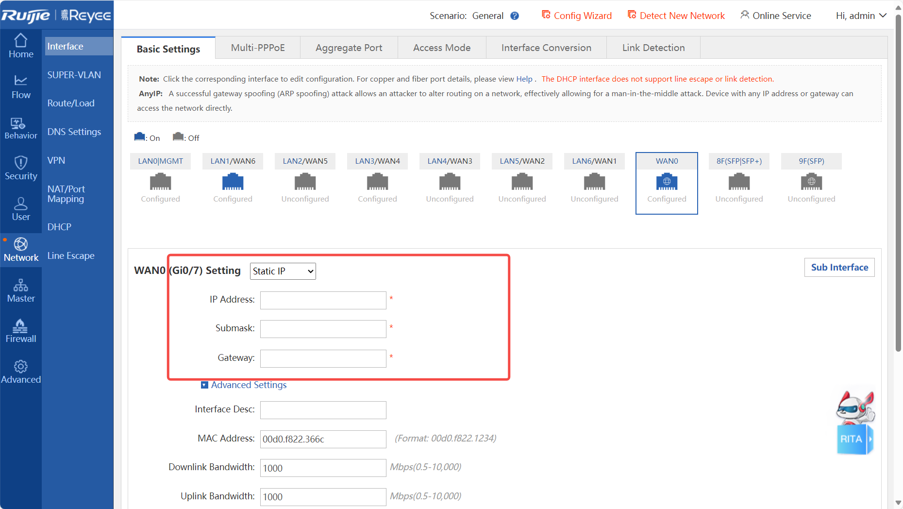

Dear customer,
Unfortunately, the Reyee EG still does not support it. It is possible to be configured on Ruijie EG/Reyee NBR models. It can be achieved by configuring a sub-interface.
<img alt="image.png">
