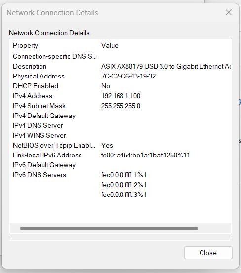

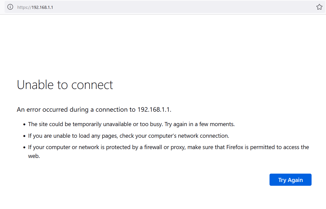

hi, i try already, i set the vlan 1 to 192.168.1.1, i am able to ping it and console, but cannot access web based via firefox
0 2023-12-8 15:31:27 View all replies
  replied at 2023-12-8 15:18
hi, i try already, i set the vlan 1 to 192.168.1.1, i am able to ping it and console, but cannot a ...
You can type: show service to check whether the web management has been enabled on the switch.
If it is disabled, you can use this command to enable web service then check again:
config te
enable service web-server
