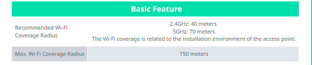

Ive asked before about what is the wifi coverage range of 2260G and the reply was 30metres but what is meant by the following image":
Can you please elaborate about this so i can be clear .

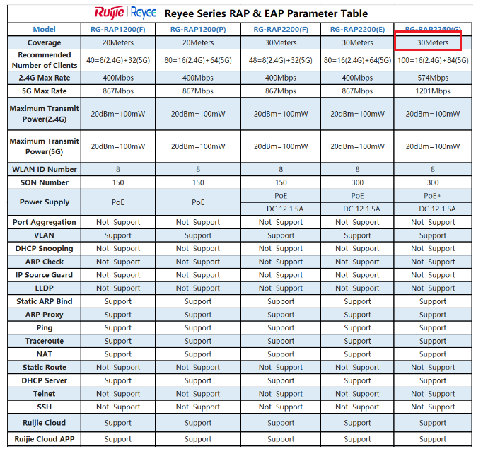

GTAC-Steve replied at 2024-1-1 18:32
Hi sir,
This is the datasheet link on our website official:https://www.ruijienetworks.com/resources/ ...
so is it 30m or 150m?
0 2024-1-1 19:02:06 View all replies
Hi sir,
The recommended coverage is 30m.
Steve
0 2024-1-1 19:03:30 View all replies
Hi sir,
The recommended coverage is 30M.
Steve

I think the data is for reference only, depending mainly on the layout and terrain.
0 2024-1-8 01:21:53 View all replies
Van Linh Nguyen replied at 2024-1-8 00:13
Dear,
It is  correct, specifications are references to the capabilities and perfomance of the device, wich are achieved in test environments.
However, these can vary according to the  installations and climate where the devices are installed.

Please suggest RAP 2260G for 25-30Mtrs coverage.
Datasheet suggest as per the test in a pure environment.
Pure environment = no obstacles, All high end user devices and accessories.
0 2024-4-1 17:05:18 View all replies
Md Saim ur  Rahman replied at 2024-4-1 16:47
Datasheet suggest as per the test in a pure environ ...
Hi sir,
Here is the coverage of RAP2260(G), This is the lab environment where the lab is tested with no obstacles
Steve
