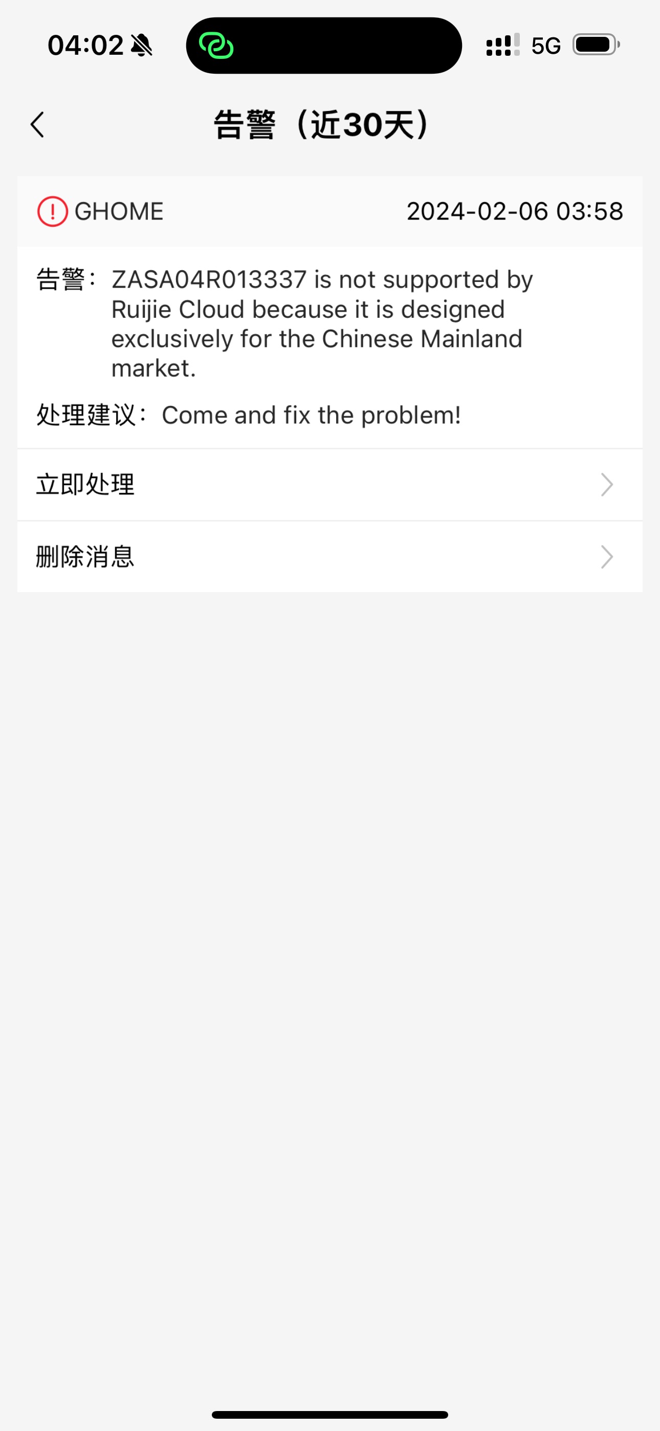

I have the same problem. All my devices disappeared from the cloud.
0 2024-2-8 18:44:39 View all replies
It says the devices are not in the correct country, but they were fine till now.
RG-EG210-P-E
RG-ES209GC-P
RG-EAP262E

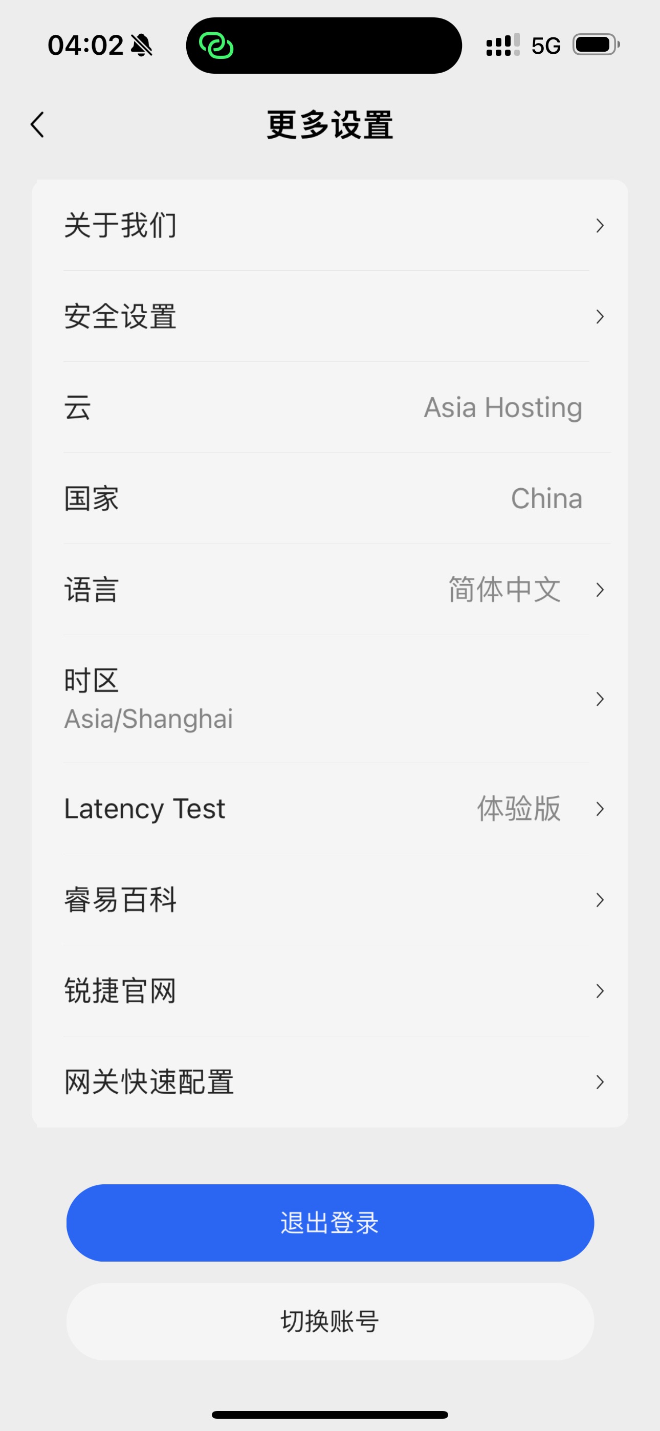

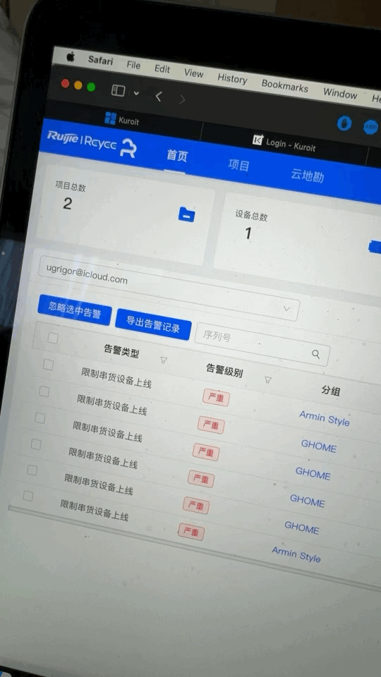

0 2024-2-9 16:22:54 View all replies
GTAC-Joy replied at 2024-2-8 19:49
can you help take a screenshot for the tips ? you can also check the following link to  ...
Here is the error message I see on the cloud.
It says it is designed for China Mainland and can't work on my account, although my account country is also set to China and this happened a day after I changed the cloud data center country from the local web interface which I am no longer able to find to change back manually.

0 2024-2-9 16:40:31 View all replies
Grigor Baghdasarya replied at 2024-2-9 16:23
It says it is designed for China Mainland and can't  ...
as we checkec these devices are purchased from China,and devices from China can not support adding to the oversea Cloud. so it will need to  Consult the domestic customer service system
