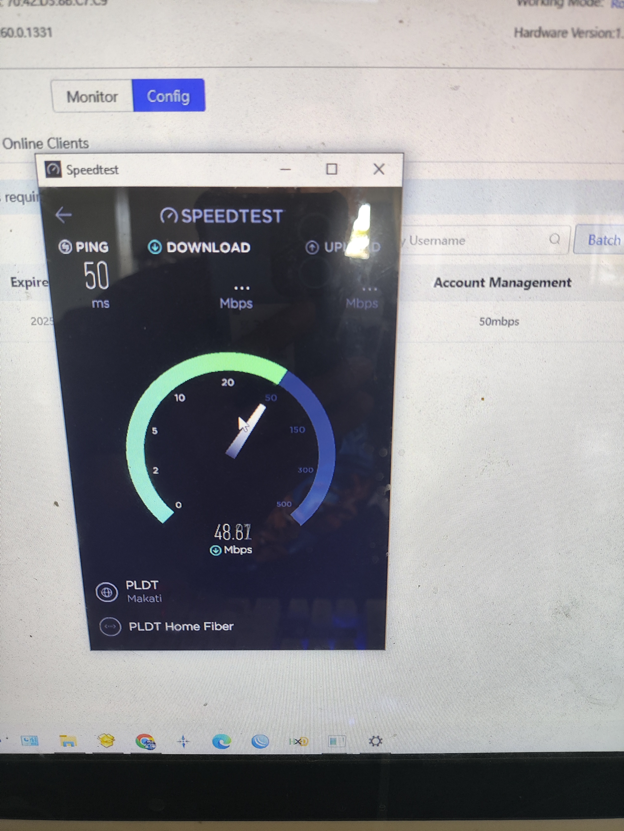

Hellow pls make fix on pppoe bandwith limit,,is very slow on take efffect.
For example.
On test router i set 25mbps limit.
When i speedtest i get 50mbps speed.
Hopefully make fix on this..

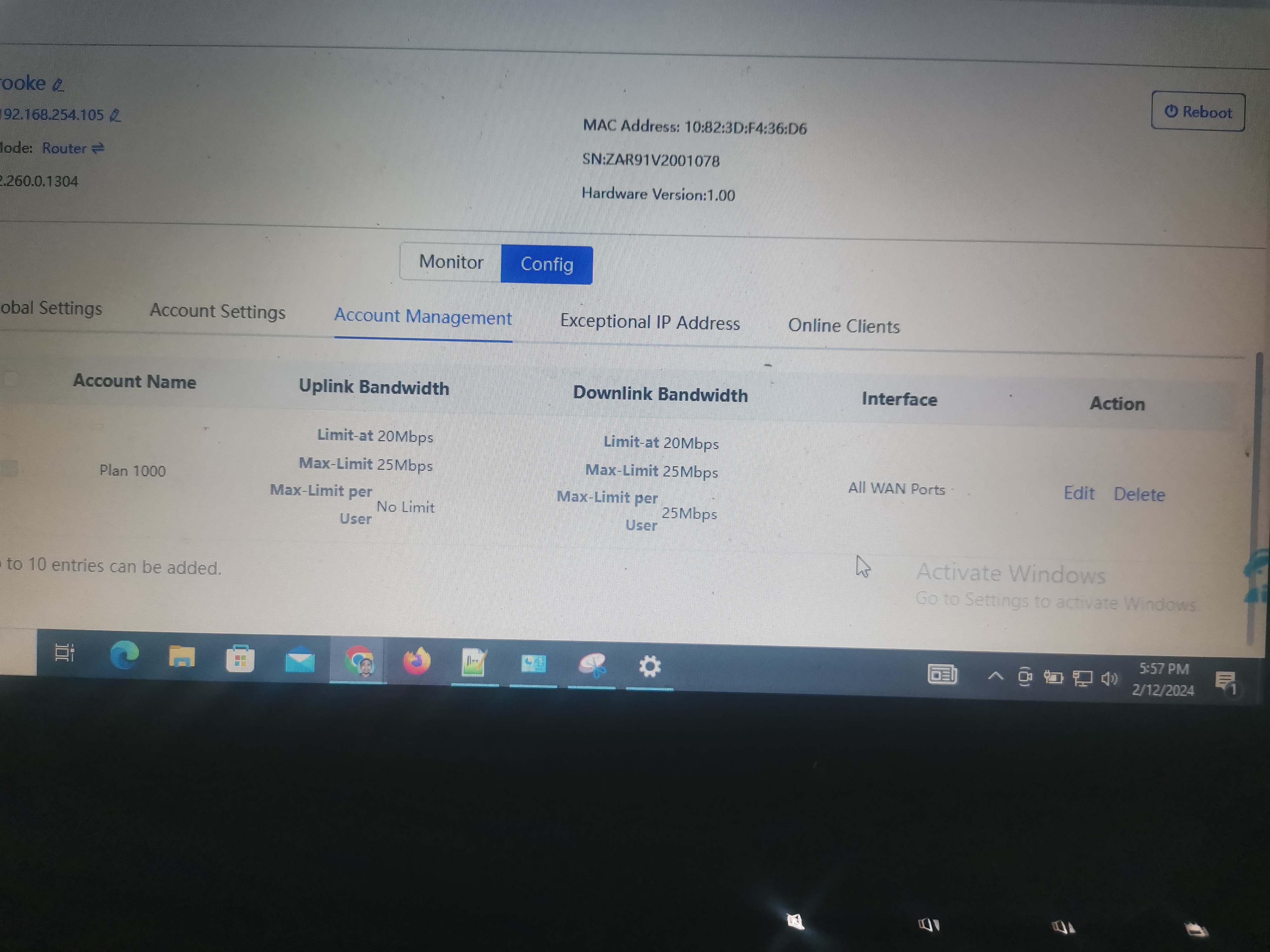

Dear User 87391,
Could you please also share the bandwidth limit configurations in Account Management as well? If possible, could you please enter RITA live chat (www.ruijienetworks.com/rita) and we can check this issue together with you?

Dear icantsleep,
Could you please decrease the Limit-at bandwidth and increase the Max-Limit bandwidth? For example, Limit-at 1M and Max-Limit at 100M.
