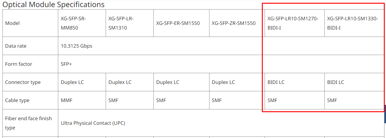

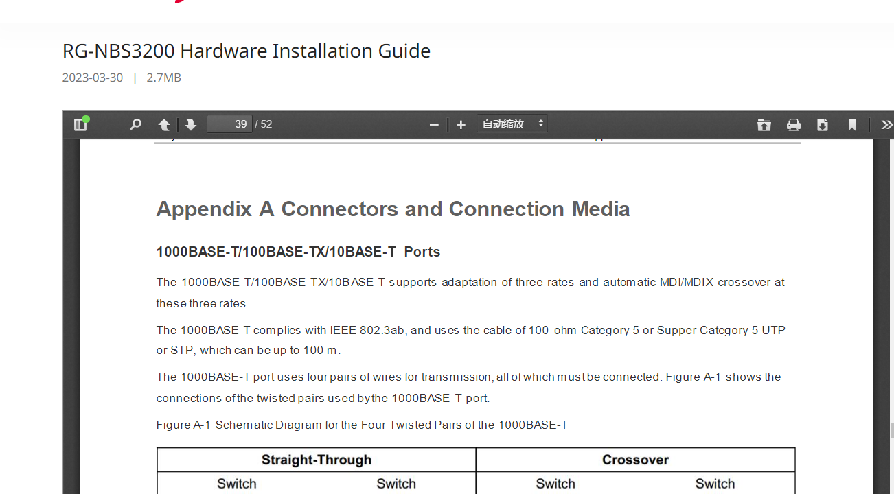

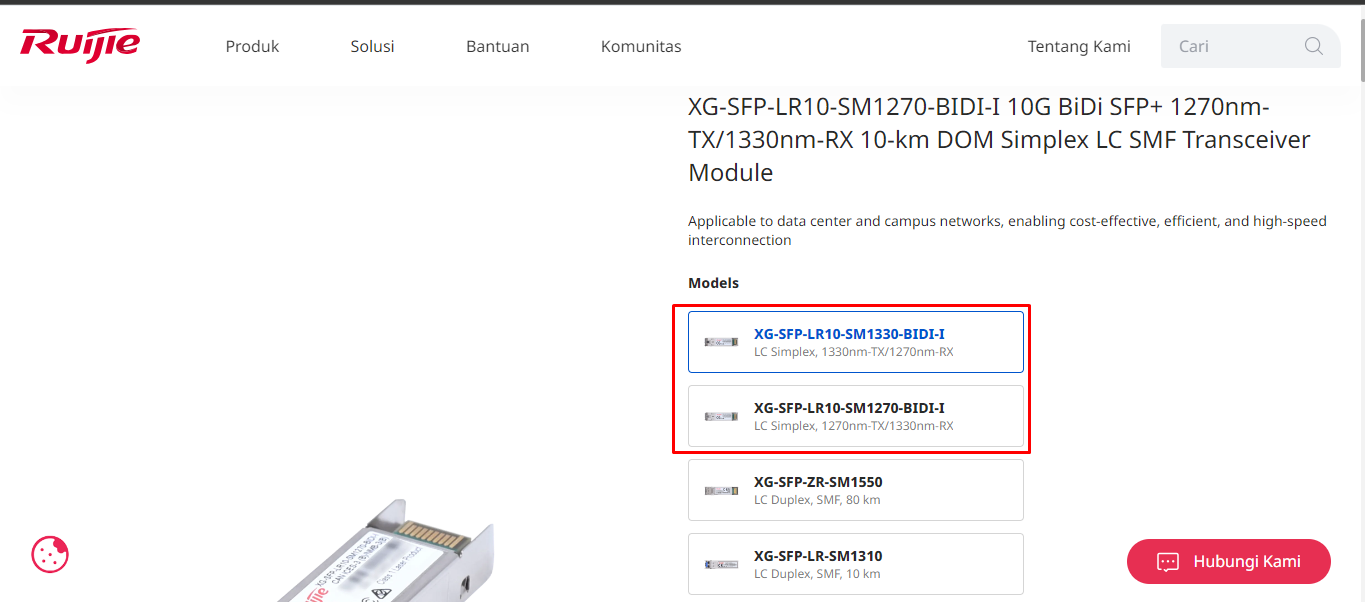

Thank you for the reply sir.
We've scrolled through the document , then we see this SFP+ Module .
<span style=""">And the wavelength is 1330 and 1270, Do we have to buy 2 type of this for tx and rx
eg : Core Switch -> 1330 , Distribution Switch -> 1270
or
We buy 2 unit and the wavelength is free to choose ?
I'm sorry asking this silly question sir . </span>

Dear IT Kartikasari,
The BIDI modules must be used in pairs, for example, if you use XG-SFP-LR10-SM1330-BIDI-I on one end,  XG-SFP-LR10-SM1270-BIDI-I must be used on the peer port.

Thank your for the reply GTAC-Jayden !
To confirm , We have to buy 1 unit XG-SFP-LR10-SM1330-BIDI-I for Core Switch , 1 Unit XG-SFP-LR10-SM1270-BIDI-I for Distribution unit .
And for FO Cable , it has to be Single Mode fiber as I read on the document
But, What will happen if the FO Cable is Multimode IF cable length is under 300 Meters ?
Sorry again for asking silly question again .
Sorry for our late response.
if the FO Cable is Multimode, the XG-SFP-LR10-SM1330-BIDI-I and XG-SFP-LR10-SM1270-BIDI-I can not be in use with Multimode cable.
the
XG-SFP-LR10-SM1330-BIDI-I and XG-SFP-LR10-SM1270-BIDI-I supports up to 10KM distance. so they can work if 300 Meters.
