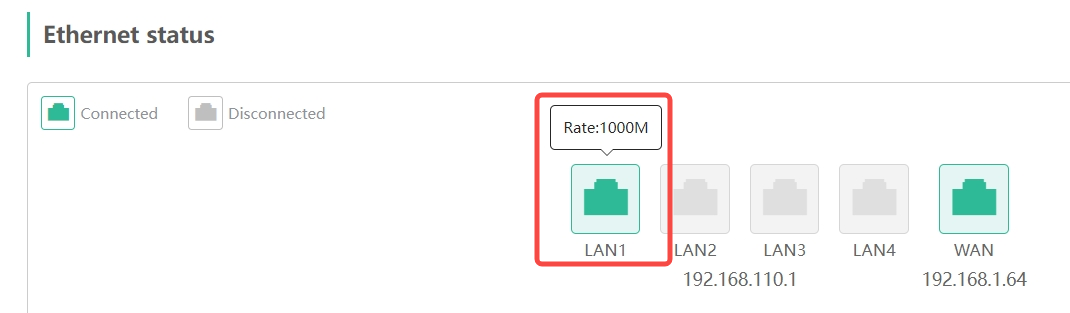

2) Verify that the negotiation rate of your LAN port is 1000M.

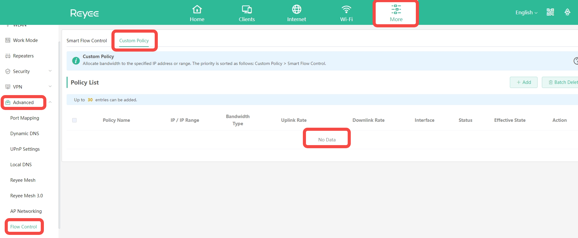

3) Check if a custom policy is enabled in the EW.  In your Reyee Router App: More Tab > Advanced > Flow Control > Custom Policy (no custom policy should be enabled for your device(s).

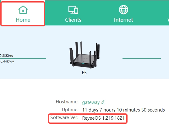

4) Make sure the Software version is the latest:

2) The LAN ports show 1000M ok.

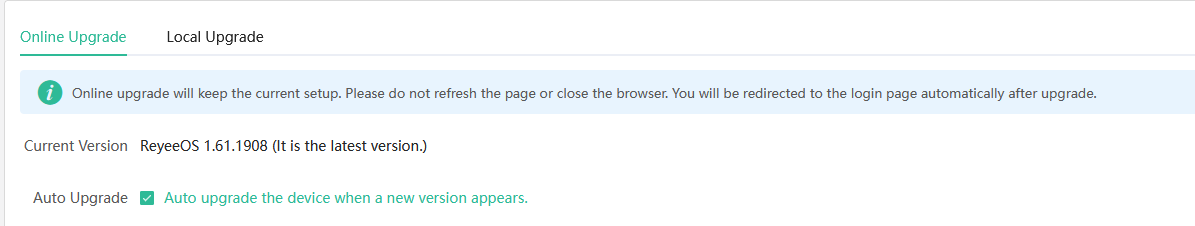

3) The software version is shown below - not the same one as your example?

may you try to upgrade the firmware version to the latest one? Here is the link for you: https://www.ruijienetworks.com/resources/software/ew3200gx-pro-firmware/reyeeos219/

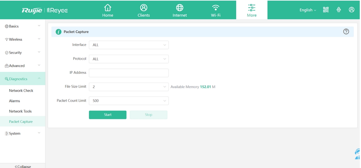

When you doing the speed test, please help capture the packets on the router via page Diagnostics >>Packet Capture and download the packet file and send it to us: service_rj(Ruijie International) <service_rj@ruijienetworks.com> attached this community link.

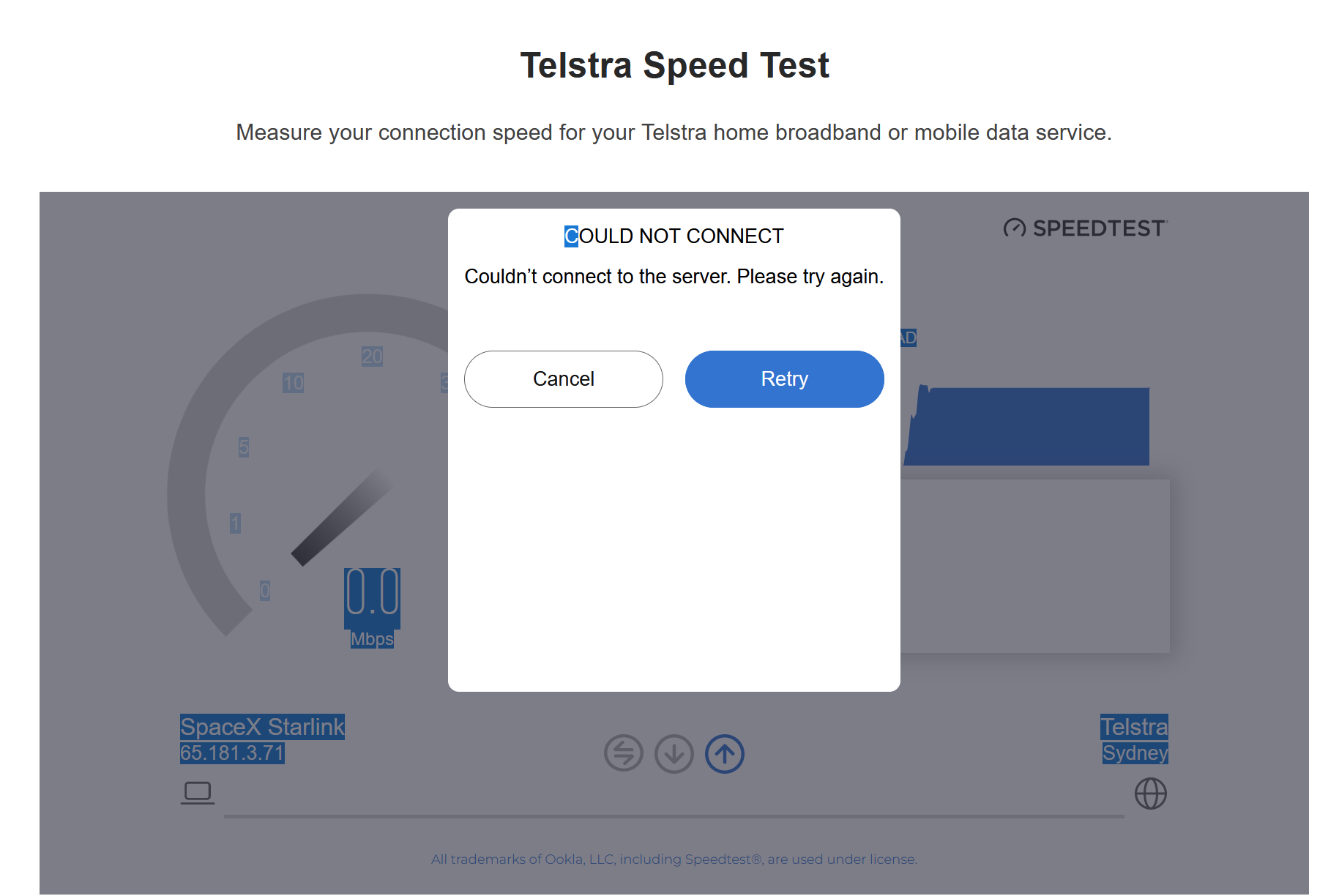

Additionally, what speed test site are you using? Have you tried different speed test sites or tools?

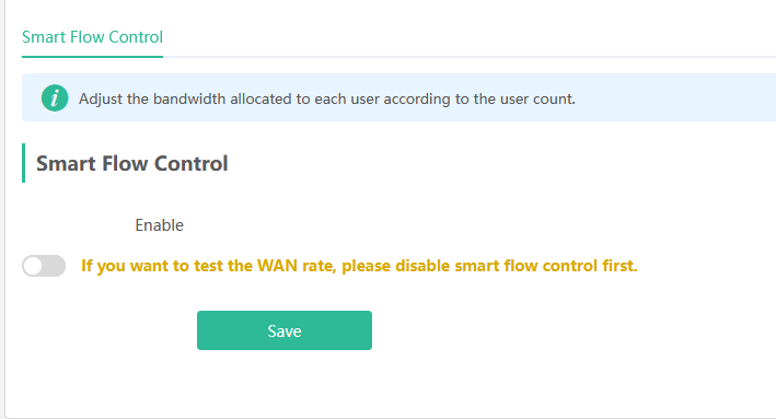

Can I know what the bandwidth provided by the ISP is? You can try to set the bandwidth in the flow control to be the same as the bandwidth provided by the ISP
