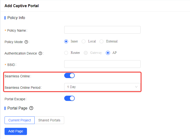

Dear Francis Ssempijja,
Did you enable seamless online on the portal policy? This will stop reauthentication when users connect again.

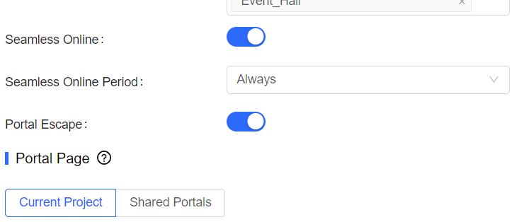

I had set everything that way already
