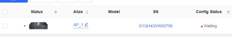

I cant connect the AP to cloud
RG-EAP602
Cloud Wireless
0 2024-3-30 10:52:20 View all replies

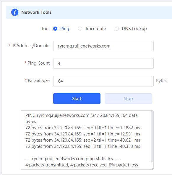

Please help login to the Reyee AP locally and show me the ping test result of this domain to further check: ryrcmq.ruijienetworks.com
Jenny
0 2024-4-1 12:40:58 View all replies
GTAC-Jenny replied at 2024-3-30 10:52
Please help login to the Reyee AP locally and show me the ping test result of this domain  ...
hello sir
this the result
cloud status

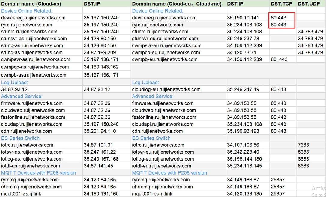

May I know the EAP uplink router device model and whether there are other Reyee devices can be online on cloud in the same network? Please help check whether the port tcp80 and tcp443 has been allowed in your network.

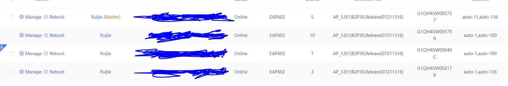

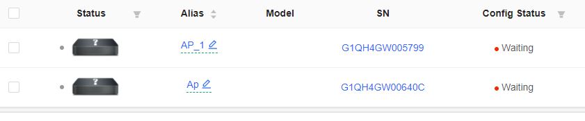

EAP602
there's no other AP in cloud
these is all the EAP602

May I know have you checked whether the corresponding ports: tcp80 and tcp443 are allowed in your network? If the problem still exists after you check the ports, we may need to remote to further check this issue. You can contact support email: service_rj(Ruijie International) <service_rj@ruijienetworks.com> personally attached this post for the same problem. Thank you for your cooperation.

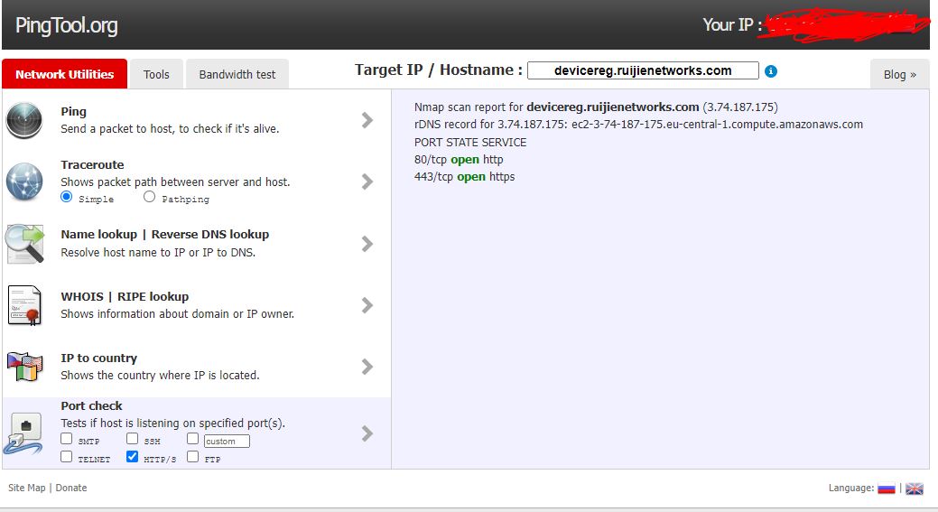

Please help connect your pc to the same network with the RAP and use this ping test tool:
to further confirm whether the corresponding domain ports are allowed to pass through your network actually.

Hello sir
This is the result
Thank you
