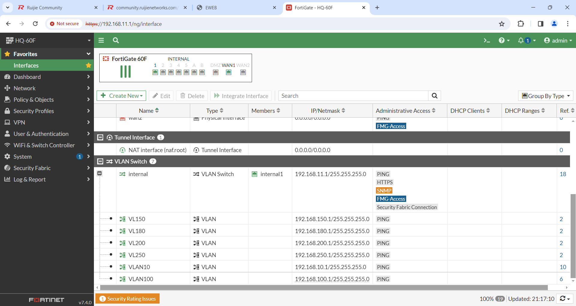

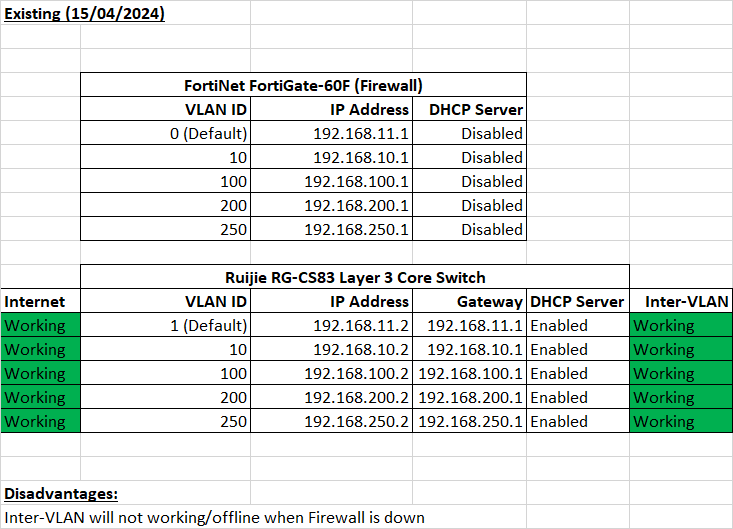

Hi, I have a Fortinet FortiGate Firewall with configured as only Gateway for muliple VLANs (to uplink Internet Access for Ruijie Switch).
VLAN0 (Default): Gateway = 192.168.11.1
VLAN10: Gateway = 192.168.10.1
VLAN100: Gateway = 192.168.100.1
VLAN200: Gateway = 192.168.200.1
VLAN250: Gateway = 192.168.250.1

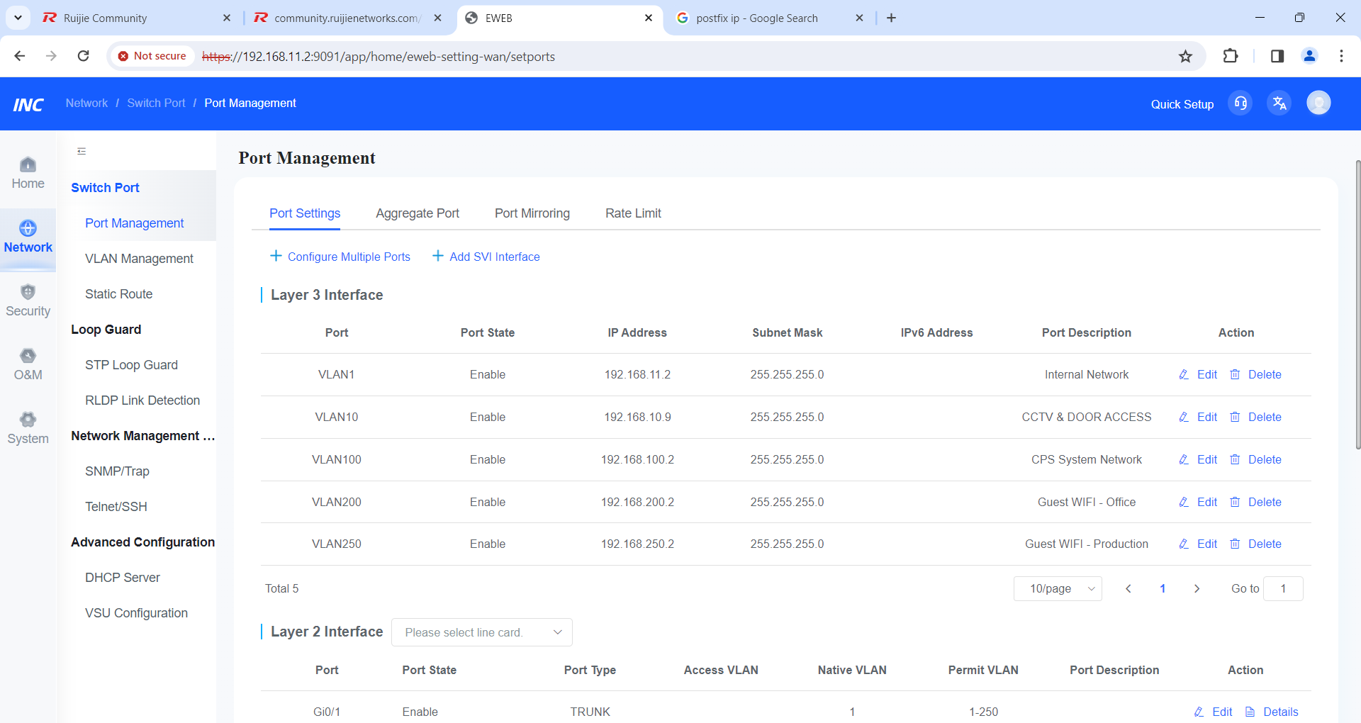

And the Ruijie L3 Switch (Model: RG-CS83-24GT4XS) has the same VLANs with DHCP management
VLAN1 (Default): Gateway = 192.168.11.2
VLAN10: Gateway = 192.168.10.9
VLAN100: Gateway = 192.168.100.2
VLAN200: Gateway = 192.168.200.2
VLAN250: Gateway = 192.168.250.2
Everything work smoothly in above configuration, however I noticed the Inter-VLAN will stop working when the UpLink port from FortiGate firewall was disconnected...
Is there anyway to get Inter-VLAN continue working even if the Firewall was down (Internet disconnected) and have to be restarted.
The purpose is to ensure the internal network operation running as usual without interruption from Firewall itself.
Thanks.

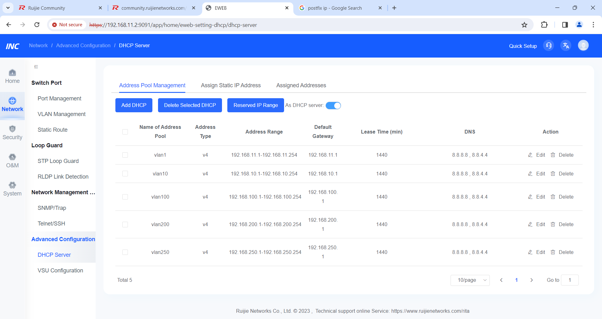

Can I know the address of the default router in the switch DHCP pool? Is it the address of the firewall?
If so, all Inter-Vlan traffic passes through the firewall. When the firewall is disconnected, the access is unavailable.
You can try to change the default router to the address of the CS switch and test again.

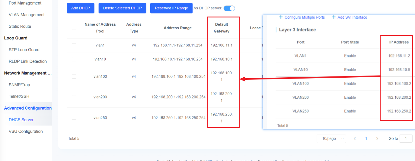

VLAN1 (Default):
DHCP Server = 192.168.11.2; Gateway = 192.168.11.1
VLAN10:
DHCP Server = 192.168.10.9; Gateway = 192.168.10.1
VLAN100:
DHCP Server = 192.168.100.2; Gateway = 192.168.100.1
VLAN200:
DHCP Server = 192.168.200.2; Gateway = 192.168.200.1
VLAN250:
DHCP Server = 192.168.250.2; Gateway = 192.168.250.1

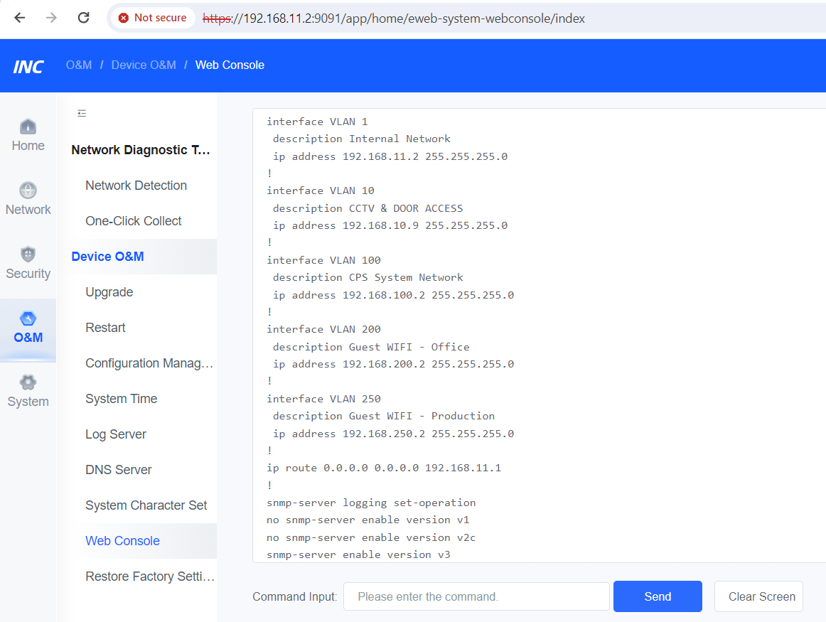

For your information, the Firewall only has VLAN and IP (DHCP disabled), and the Firewall IP address is 192.168.11.1

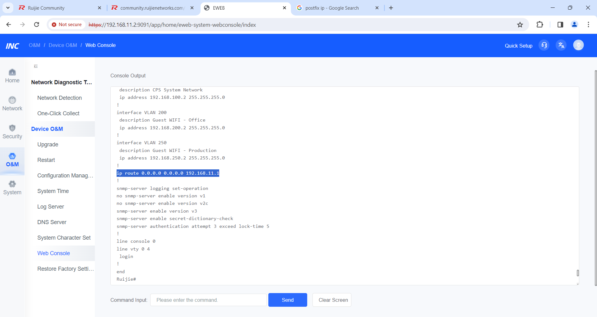

I check the Switch Web Console and found this "ip route 0.0.0.0 0.0.0.0 192.168.11.1"
You can refer the images for details.

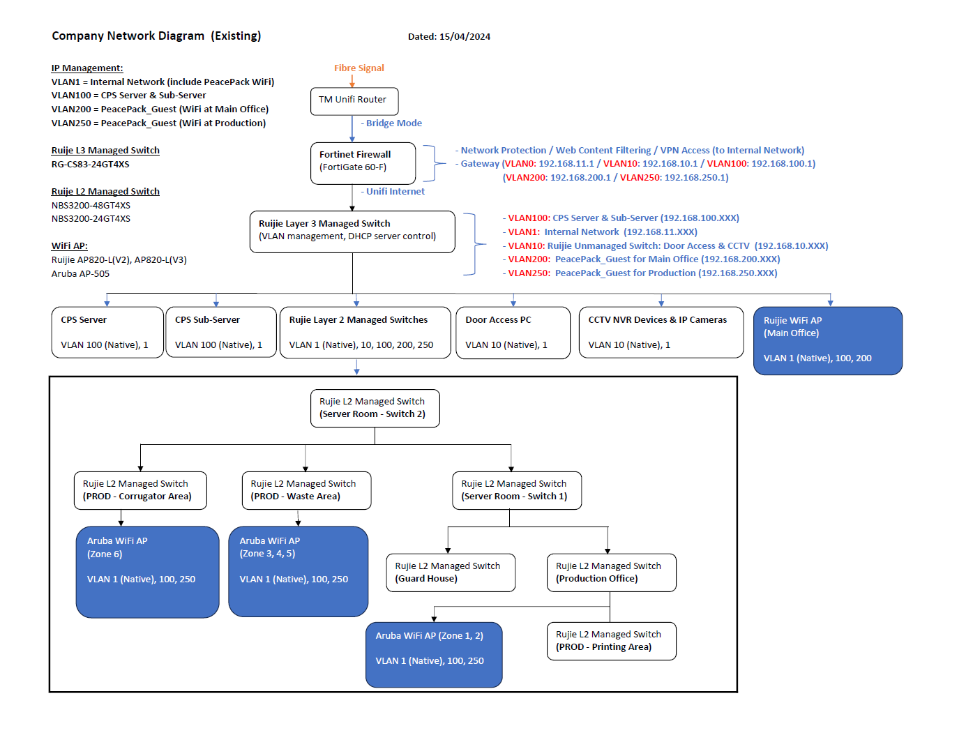

Regarding this issue, could you also provide us with a topology of the network including firewall and core switch here ?
If permitted, you can resort to SVI to realize inter vlan when firewall down.

Dear David,
For your reference.
Thank you.

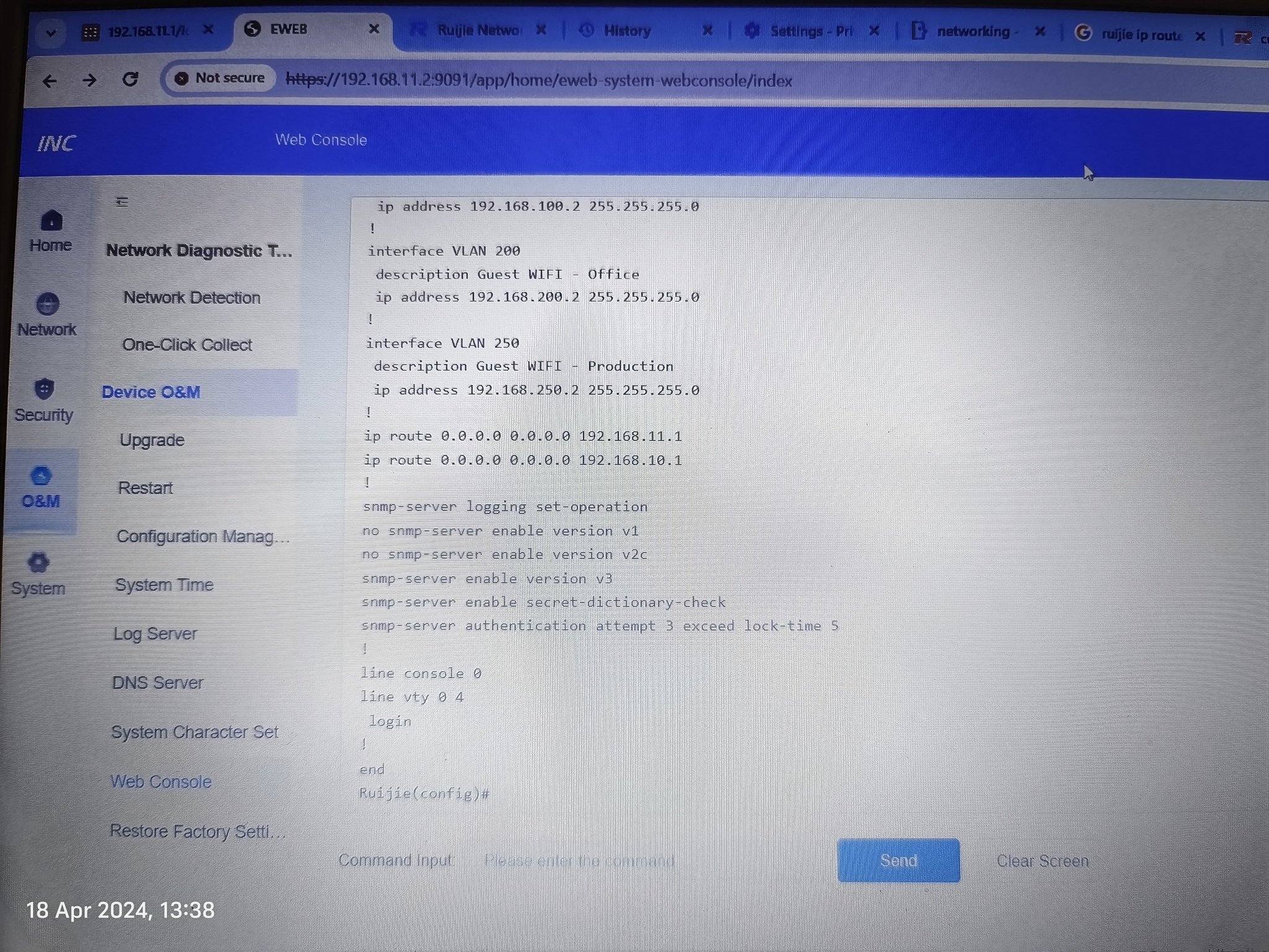

Please kindly refer to these commands and try to add them on your device.
Ruijie(config)#ip route 0.0.0.0 0.0.0.0 192.168.11.1
Ruijie(config)#ip route 0.0.0.0 0.0.0.0 192.168.10.1
Ruijie(config)#ip route 0.0.0.0 0.0.0.0 192.168.100.1
Ruijie(config)#ip route 0.0.0.0 0.0.0.0 192.168.200.1
Ruijie(config)#ip route 0.0.0.0 0.0.0.0 192.168.250.1

Edited by Jim Khor at 2024-4-18 14:15
GTAC-Micca replied at 2024-4-17 14:23
Jim Khor replied at 2024-4-17 12:10
Dear Micca,
Dear Micca,
After try, the suggested command only works to grant Internet access if no additional ip route added.
For example:
ip route 0.0.0.0 0.0.0.0 192.168.11.1 > for VLAN1 (Default)
ip route 0.0.0.0 0.0.0.0 192.168.10.1 > for VLAN10

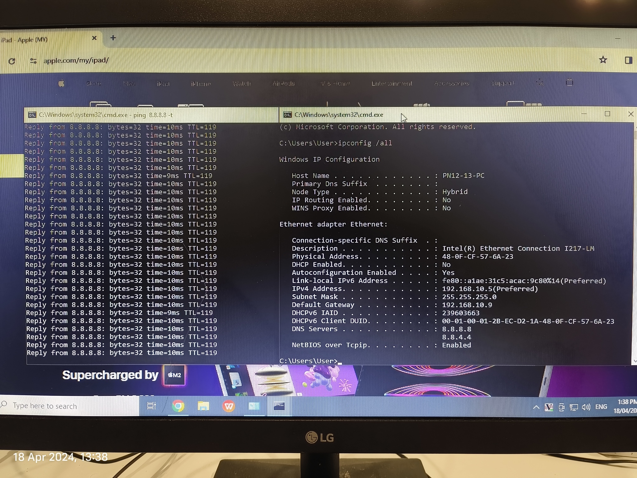

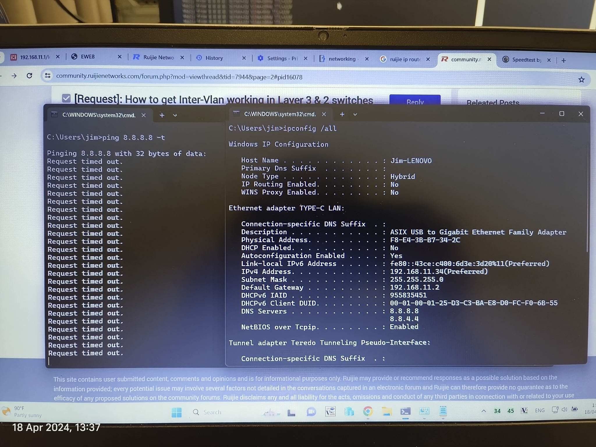

Tested PCs (Manually Configured, to avoid existing network disruption):
VLAN1:
IP: 192.168.11.34, Subnet Mask: 255.255.255.0, Gateway: 192.168.11.2, DNS Server 8.8.8.8 and 8.8.4.4
VLAN 10:
IP: 192.168.10.5, Subnet Mask: 255.255.255.0, Gateway: 192.168.10.9 (not 192.168.10.2, typo error last time), DNS Server 8.8.8.8 and 8.8.4.4
From the above setting, the PC in VLAN10 will be able to PING 8.8.8.8 and grant Internet access, however it may cause the VLAN1 PC unable to PING 8.8.8.8 (or any) and Internet connectivity will become slower and not consistent if compared to only 1 "ip route 0.0.0.0 0.0.0.0 192.168.11.1" in the console. (when perform speedtest.net test, finding server will take longer time than usual)
For the "Administrative Distance" configuration, the VLANs network unable to get grant Internet Access and PING command not working.
Is there any possibility to get all VLANs automatically get their IP Route instead of just insert command and let system to choose/prioritise
without any conflict? such as add IP ROUTE command in the VLAN interface?
