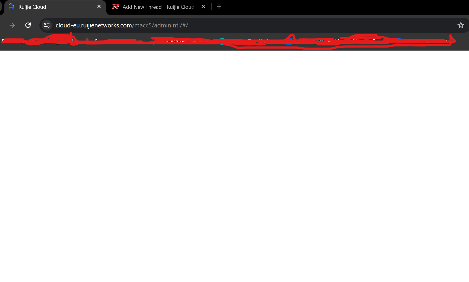

Good day,
Im having issues logging into my Reyee cloud portal. It will take me to the logging page, but once i entered my username and password, it redirects me to a blank page.
Anyone else having this issue?
0 2024-5-3 17:51:24 Solved View all replies

Hi Jayden,
There is still a problem. I tested by using 3 different computers, used 3 different browsers and even connected to 2 other internet providers and i get the same result.
I asked my  colleague to login with his account and he gets the same white screen after the login page.
I also tried logging in with a client's login and also, again the white page.
The only thing i can think of is that last night i cleared my browser history and this morning i was getting this issue same with my colleague, he is able to login fine with his browser, but when i asked him to clear the browser cache and history, he is also getting the white page.
If i clear my browser cache, i get to the login page, then enter my credentials and it hangs with the below showing at the bottom of my screen. then goes to the blank page.
