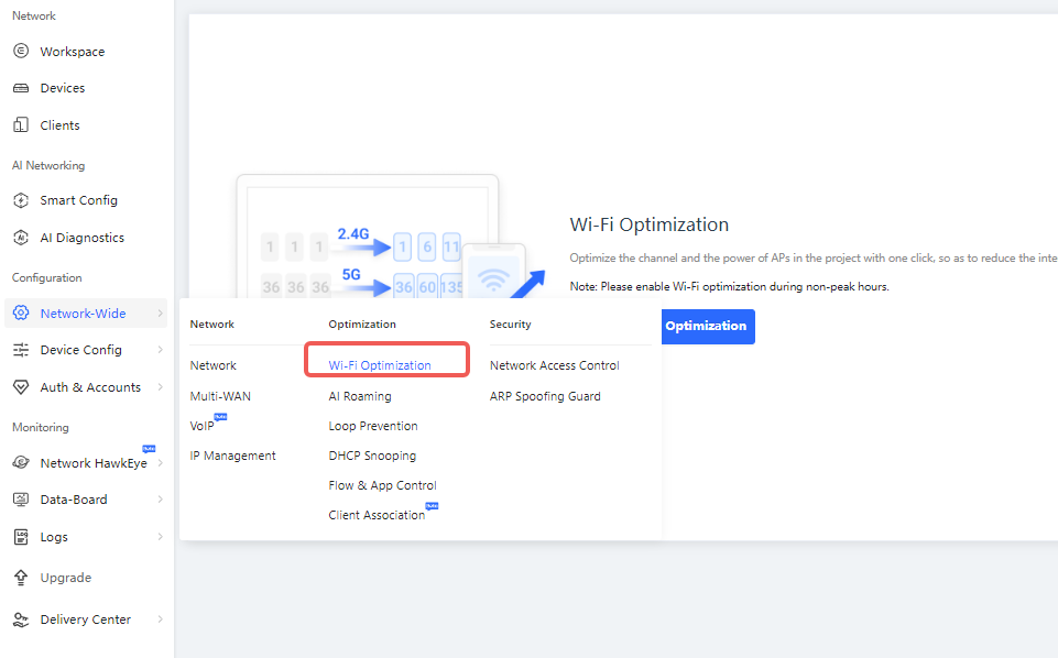

4. plz use wifi optimization function to optimize channels, power of all APs to minumize interference and optimize performance.

4. I ran the Wi-Fi optimization function. It gave me this result:
Optimization time: 5 min 2 s
Optimized severe interference of 4 APs.
Channel interference Down by 54.96%
User experience Up by 77.74%

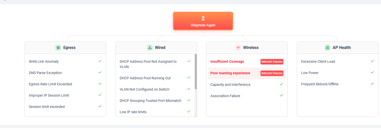

We have received the email you sent us. As we checked, the AP units in the project has Insufficient Coverage and Poor roaming experience issue according to the [color=rgba(0, 0, 0, 0.9)]AI Diagnostics.
For coverage issue, could you tell us the approximate distance between your AP units? Are there obstacles like concrete walls between them? If you have something like a heatmap with the deployment of APs marked on it, you can sent it to us via email or Rita.

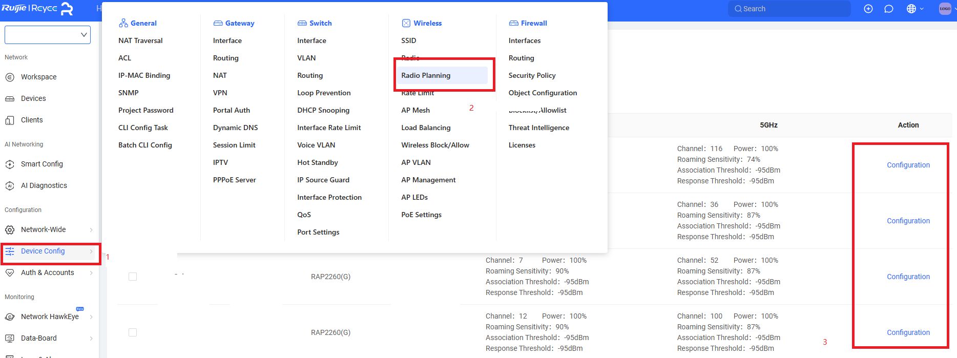

If the WIFI optimization didn't help, you can also adjust the the channels and RF power manually.

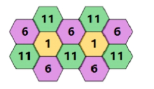

When configuring them, you may nest the 2.4Ghz channels of your APs in the following pattern according to their physical location. You can also nest the 5Ghz channel in the similar pattern choosing from 149、153、157、161、165,36、40、44、48、52、56、60、64

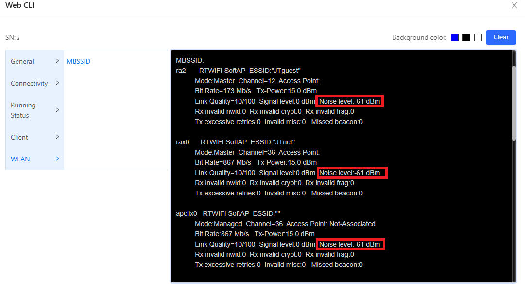

The frequent disconnection could have something to do with the channels interference. That is why the we can try adjusting the channels.
Apart from that, the noice level in the surroundings will also play a part. As we checked, the noice level is quite high for the AP units in the project. Normally noise level for WiFi to work properly is around -90dbm, a higher noise level indicates there is environmental interference, could you please check if there is any high power appliances near the APs? for example a microwave can cause interference to the 2.4G wifi signal.
