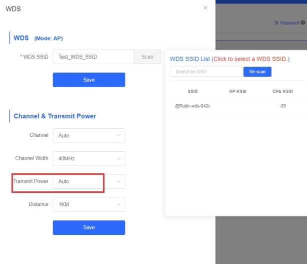

Hello Lukasz Ptak,
You can check from the below screenshot of configuration.
You can test it first, if there are still problems, please feel free to contact me. I'd be happy to help you in the community.

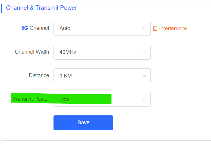

0 2024-5-31 21:20:35 View all replies
Dear Sir
that means the signal strength of the current equipment has been reduced to a minimum
May I know the current issue you encountered?

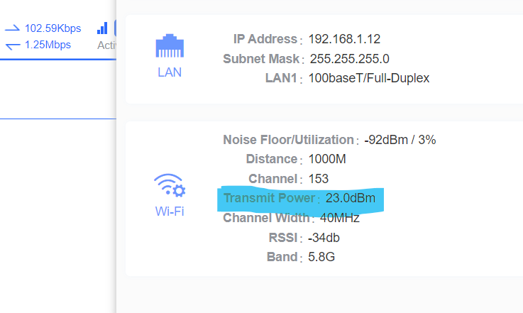

0 2024-5-31 21:53:13 View all replies
GTAC-Ross replied at 2024-5-31 21:20
Dear Sir
That's not an issue, looking for more information.
Actually I can see 4th option to go which wasn't there yesterday ''lower''
Power settings looks like
LOWER  -  20dBm
LOW       -  23dBm
MEDIUM -  25dBm
HIGH       - 26dBm
But if I want to setup wireless bridge with distance 50m, I should get option to go lower than 20dBi because with that power, devices interference one to each other also signal level at -33dBm can be case of wireless link drops.
