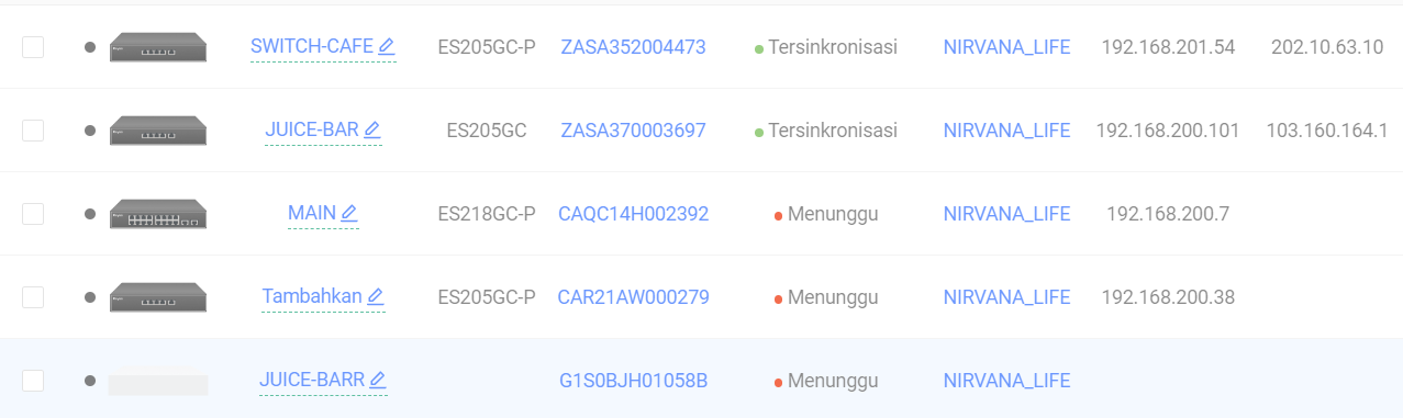

Hi Good Afternoon
Can you help me I have case all my switch is offline
thank you

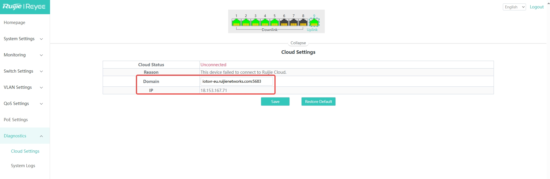

If your switch is running the latest firmware B1P27 version, you may configure cloud URL in the Cloud Settings:
If your device is installed in Indonesia, please navigate to Diagnostics > Cloud Settings and change the domain to iotrc.ruijienetworks.com:7683 or iotsvr-as.ruijienetworks.com:5683

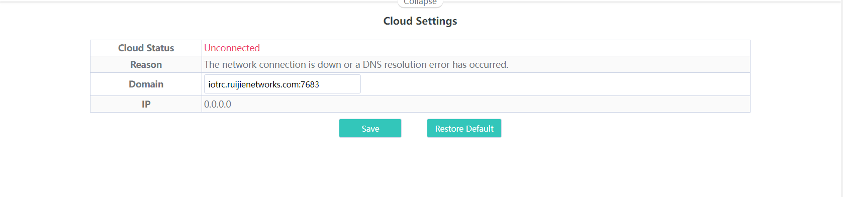

Dear Sir
I submit the screenshot of my cloud
0 2024-7-9 13:14:36 View all replies
Putu Setiawan replied at 2024-7-9 11:44
Dear Sir

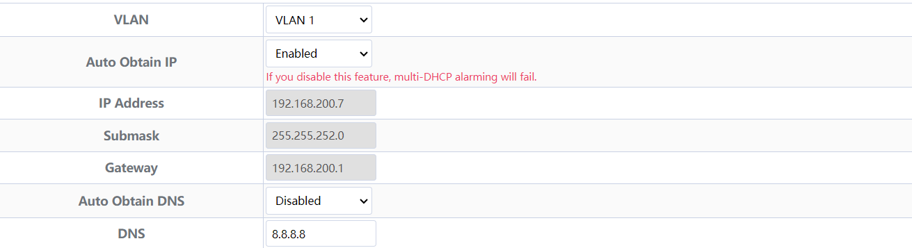

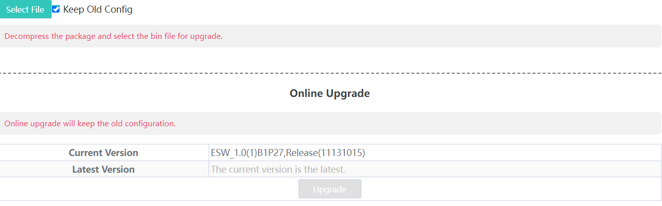

Hello,
plz enter ES local web,
1.  set dns to 8.8.8.8 in "ip setting"; and screenshot for us;
and plz upgrade ES to the latest firmware version as B1P27 shown in home page,
2. and enter system--cloud service--and screenshot for us the whole page
0 2024-7-9 13:33:43 View all replies
GTAC-Stella replied at 2024-7-9 13:14
Hello,
Helo,
0 2024-7-9 13:38:21 View all replies

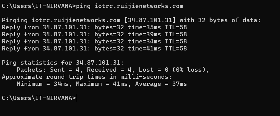

Hi, Putu Setiawan
In the Cloud Settings, the cloud domain is not resolved to IP address properly.
Please verify if the switch is connected to internet. You may test this by connecting a PC to the switch, make sure the PC receives and IP in the same segment as the switch, i.e 192.168.200.x and ping 8.8.8.8 and iotrc.ruijienetworks.com to check the connectivity.

hi Jayden
the switch is connected to internet, I now all device is connected to internet, and we use now for the internet
0 2024-7-9 14:00:45 View all replies

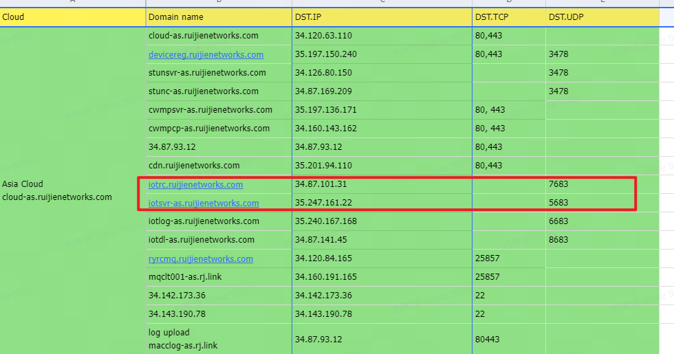

Hi sir,
Is there any firewall in your environment ? If so, please unblock these urls and ports.
Steve
0 2024-7-9 15:22:31 View all replies
GTAC-Steve replied at 2024-7-9 14:00
Hi sir,

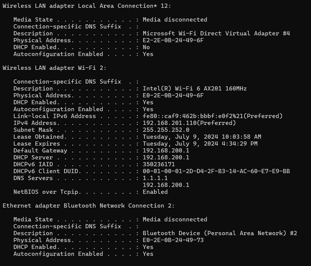

Hi, Putu Setiawan
If in the Cloud Settings of the switch, the domain is still not resolved to the correct IP address, please show me the result of "ipconfig/all" and ping 8.8.8.8 and iotrc.ruijienetworks.com on a PC connected to the switch LAN port.

Hi Jayden
0 2024-7-9 17:23:10 View all replies
