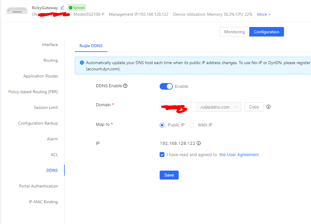

Dear all,
We observed that the Ruijie DDNS is using the wrong WAN IP "192.168.128.122" for the A record, is there any way to fix it?
The Gateway is behind a TPlink router with DMZ set to Ruijie WAN IP, we can not remove the Tplink for some reasons.

Hello,
When you switched from WAN ip to public IP, did you wait for the cloud to refresh the page?
Can you try switching WAN IP again, then switch to public IP and check to refresh?
Which IP address is resolved when you access or ping the test?

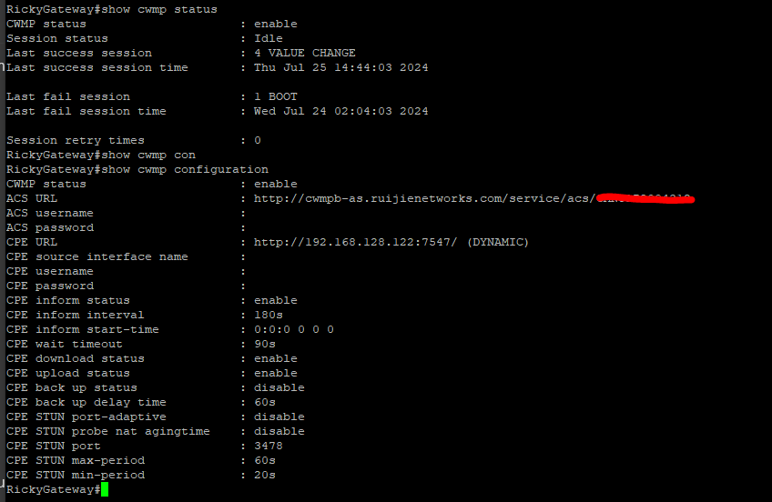

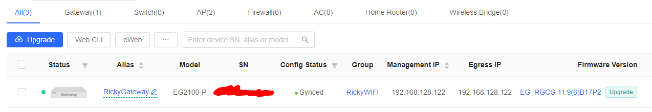

We noticed the MGMT IP and Egress IP is the same ip address which is abnoraml
May I know if you can input following commands to the device?
conf t
cwmp
acs url http://cloud-as.ruijienetworks.com/service/acs/Device's SN
end
wr
Ross
0 2024-7-25 14:44:47 View all replies
That is already running:
0 2024-7-25 21:55:37 View all replies
Leo Tam replied at 2024-7-25 14:44
Hello,
We noticed the MGMT IP and Egress IP is the same ip address which is abnoraml It may caused the DDNS configuration didnt' take affect
We also noticed the current acs url still in the default url
May I confirm the MGMT IP and egress ip address still the same after you input the commands we provided?
conf t
cwmp
acs url
end
wr
becaues we want to confirm whether ther egress ip address will change after commands are input to the device
Ross

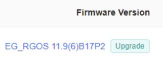

I have noticed there is pendant a gateway's firmware upgrade:
Have you tried?
You could check the issues resolved here https://www.ruijienetworks.com/resources/preview/1196b17p2/
