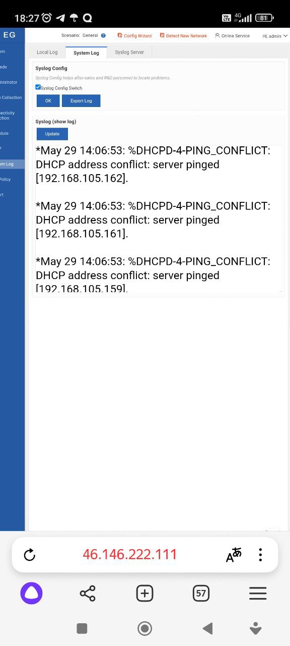

Dear Sir,
Before DHCP Server allocates an address, it will ping probe the address to ensure that it is not in use. If probed, and found that the address is occupied will trigger a conflict alert. In addition to generating the above logs, you can also see the conflict logs through the showip dhcp confict. Since the conflict detection is before allocation, generally speaking, this alarm has no business impact.

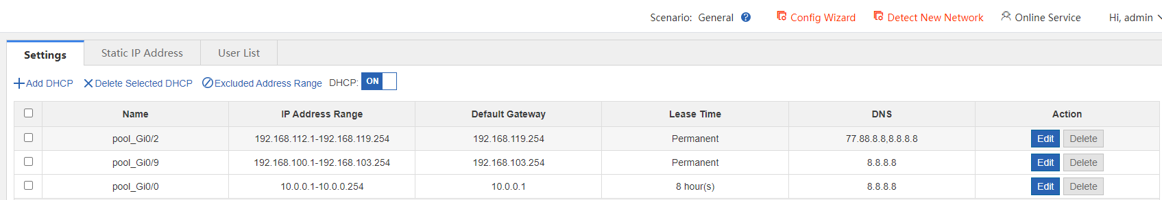

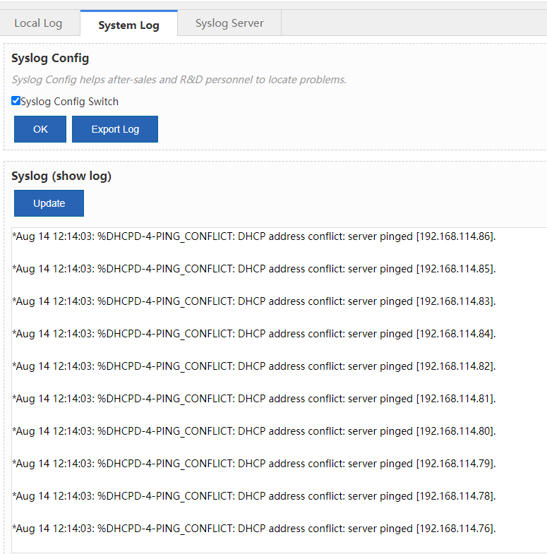

Here is my DHCP server settings:
But i receive yhis errors:
Al hosts in my network recived ip adresses dynamicaly, dhcp is only one in this network, also there is no static ip adresses.
There is problem with dhcp.
Why does Gateway start giving out new IP addresses when he is rebooted?
