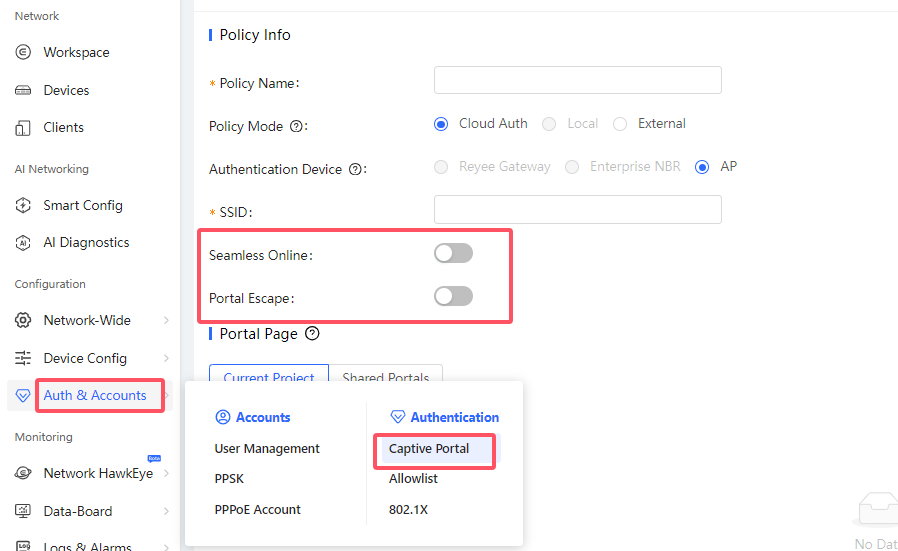

Hello,
1. Is the configuration you mentioned the configuration in the screenshot below? If not, you can follow the screenshot and change your authentication configuration.

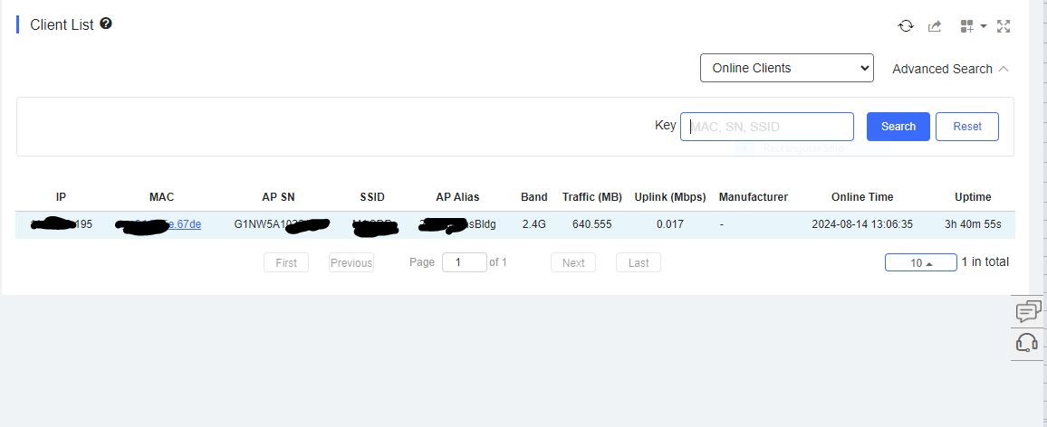

2. If the configuration has been changed, but there are still users who can connect to the SSID without authentication, can you take a screenshot of the authentication configuration, account group Settings, and SSID configuration for me to check?
3. Please also share the records of user connections(client list) on the cloud

Your attached file is the exact config I made and also I recorded all the bind mac address that been use on our users but the problem there is some mac addressing still accessing the ssid event without an account. The attached file is the current mac address and I think it the same user before because the location where he/she connecting is always the same. Maybe he/she have a way to change his/her mac address.

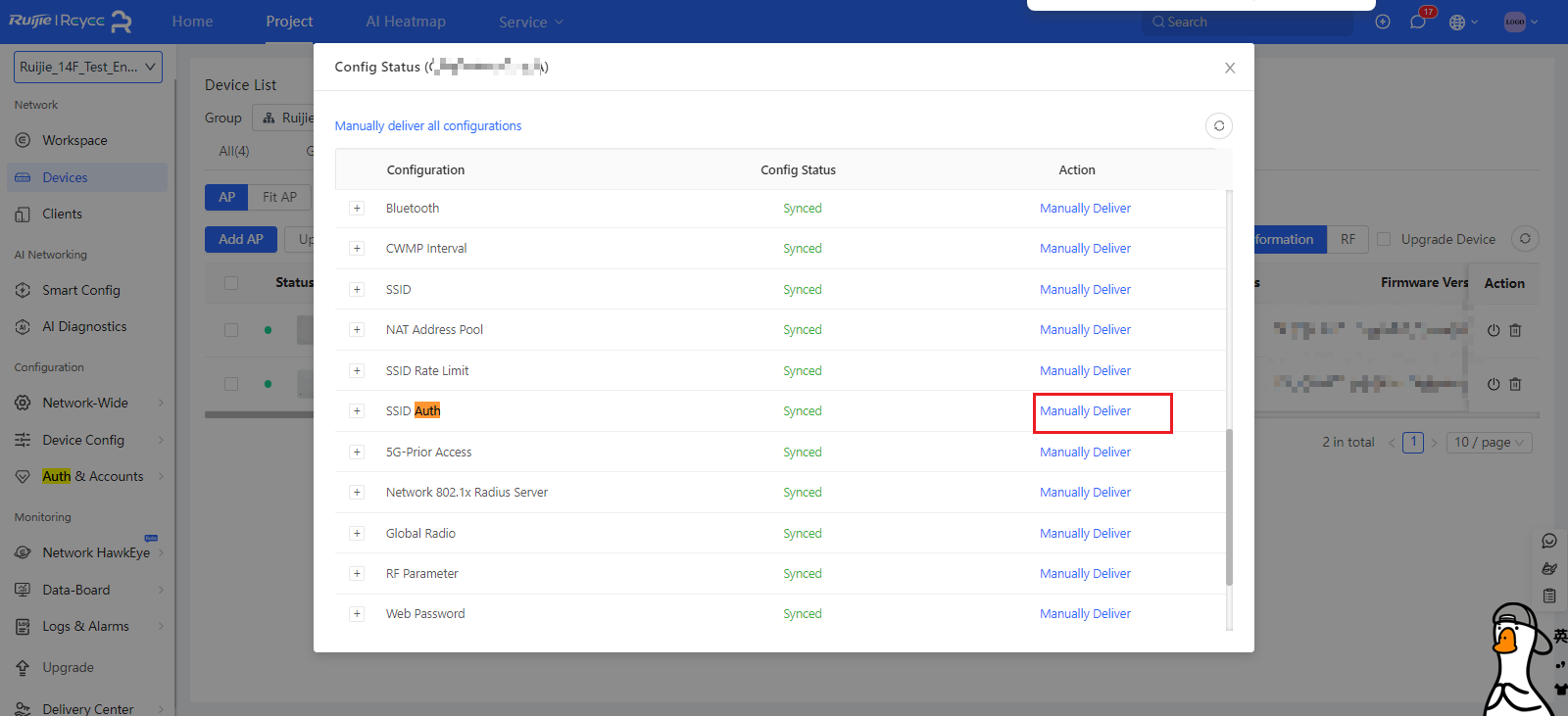

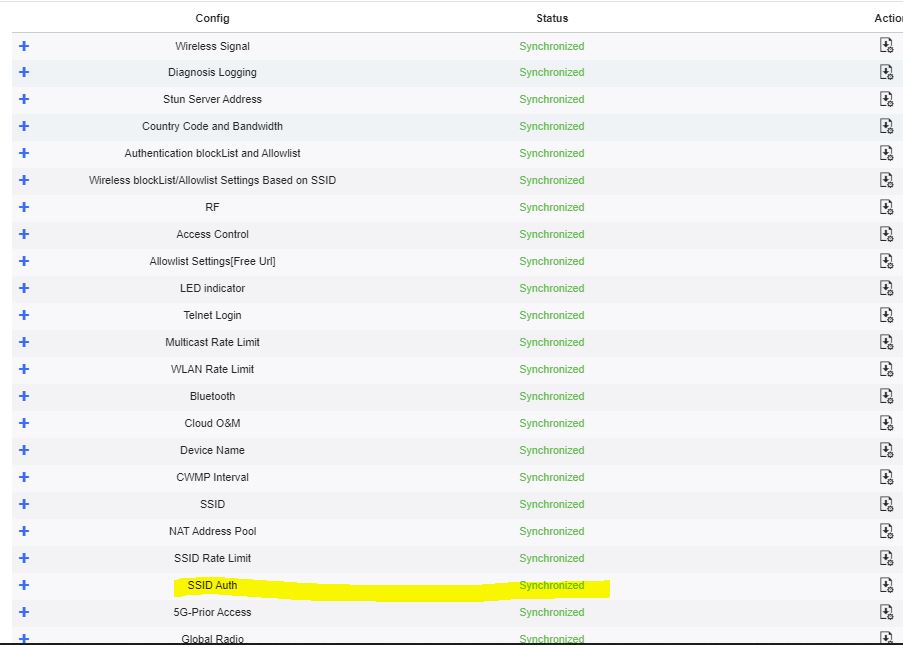

Hello,
What does the topology look like? How many APs are there? Are all APs successfully synchronized with portal configuration? You can manually click deliver to synchronize the portal configuration to the AP again

We have 41 access point, and yes I already blacklisting the mac address but the device manage to get new
mac address on his/her device and still connecting on the same location. I look to the AP
where the user
frequent connected to it all sync base on our config.

Hello,
1. May I also confirm whether these two functions were enabled
it will allow user access the network and portal page will not pop up
and user who has passed the authentication will not need authentication again
if these two functions were enabled, could you try to disable them?

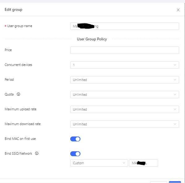

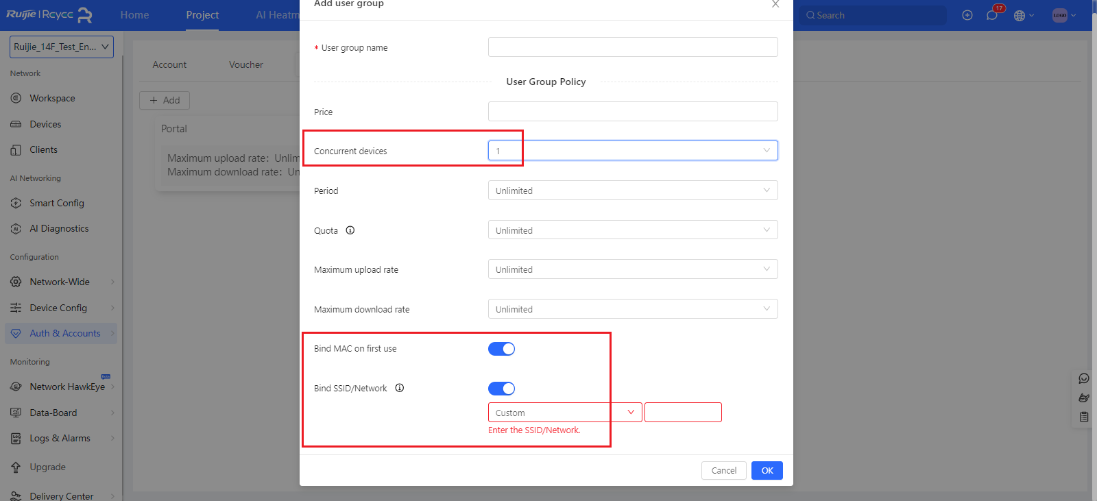

2. May I also see the configutation on the user Group too?
configuration like this

I will try and workaround the 1 and 3, now I put an alias to all the mac address that been use so that I can
easily identify which mac addresses are newly registered and when I saw an new mac address that is
not binded to any account I created I blacklist the mac addresses globally. (temporary solution)
As of now I already black 6 mac addresses that been connecting to the different ssid even they
do not have an account and they consuming a certain amount of bandwidth. For those 2 this is my
group settings.
