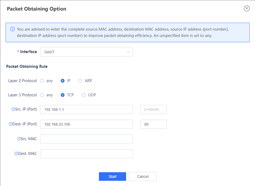

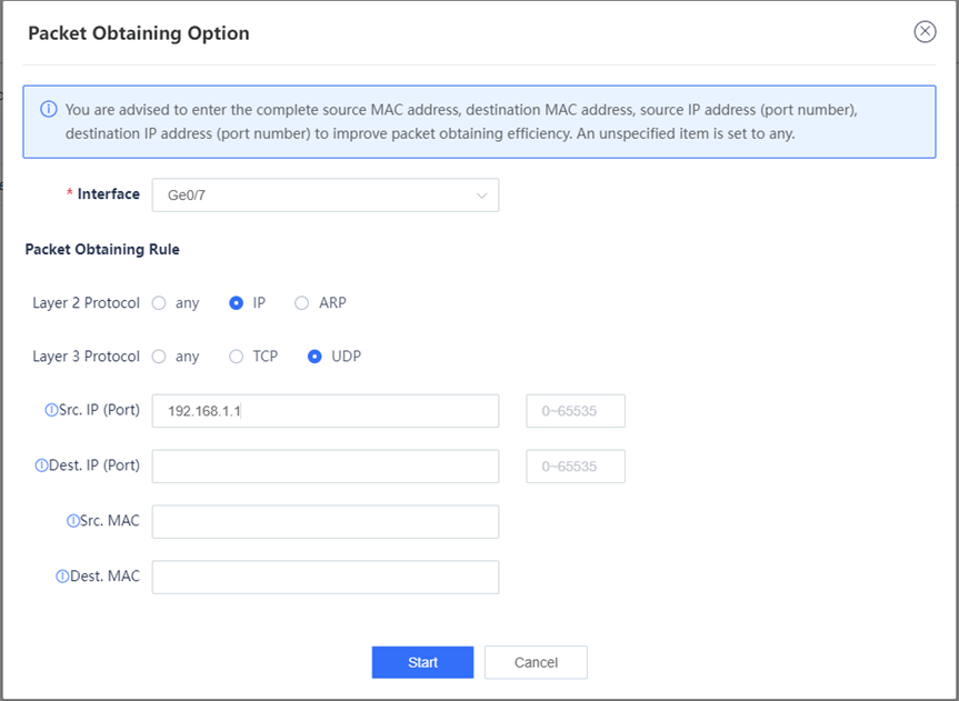

Source options (Src. MAC, Src. IP, or Src. Port) and destination options (Dest. MAC or Dest. Port) are available. If only source or destination options are specified, packets with the specified source or destination will be captured. If both source and destination options are specified, all packets matching the given source or destination criteria will be captured.

All UDP packets passing through port Ge0/0 with a source or destination address of192.168.1.1 are captured.

All TCP packets passing through interface Ge0/0 with a source IP address of 192.168.1.1 and destination IP address of 192.168.23.100:80, or with a source IP address of 192.168.23.100 and destination IP address of 192.168.1.1, are captured.
