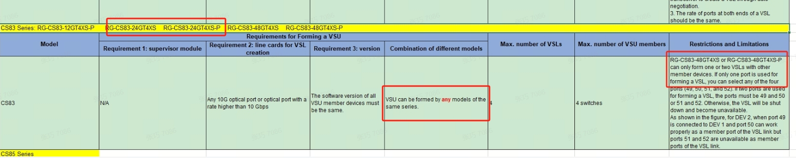

Dear Support
I would like to know if the RG-CS83-24GT4XS can use VSU with the RG-CS83-24GT4XS-P. Actually, if you want to stack, you can do it from 10G up to the specifications that Ruijie mentioned. Moreover, they are switches in the same series.
I asked to make sure and clear up any doubts.
Thank you and Best regard.
RG-CS83 Series
Switch Other VSU Stack Data Center Switch
0 2024-8-30 13:05:29 View all replies
Edited by GTAC-Lex at 2024-9-2 12:26
Dear Victor,
Good day.
Yes, RG-CS83-24GT4XS Can use VSU With RG-CS83-24GT4XS-P.
You may check with this post:
https://community.ruijienetworks.com/forum.php?mod=viewthread&tid=1951&extra=page%3D1
Lex
