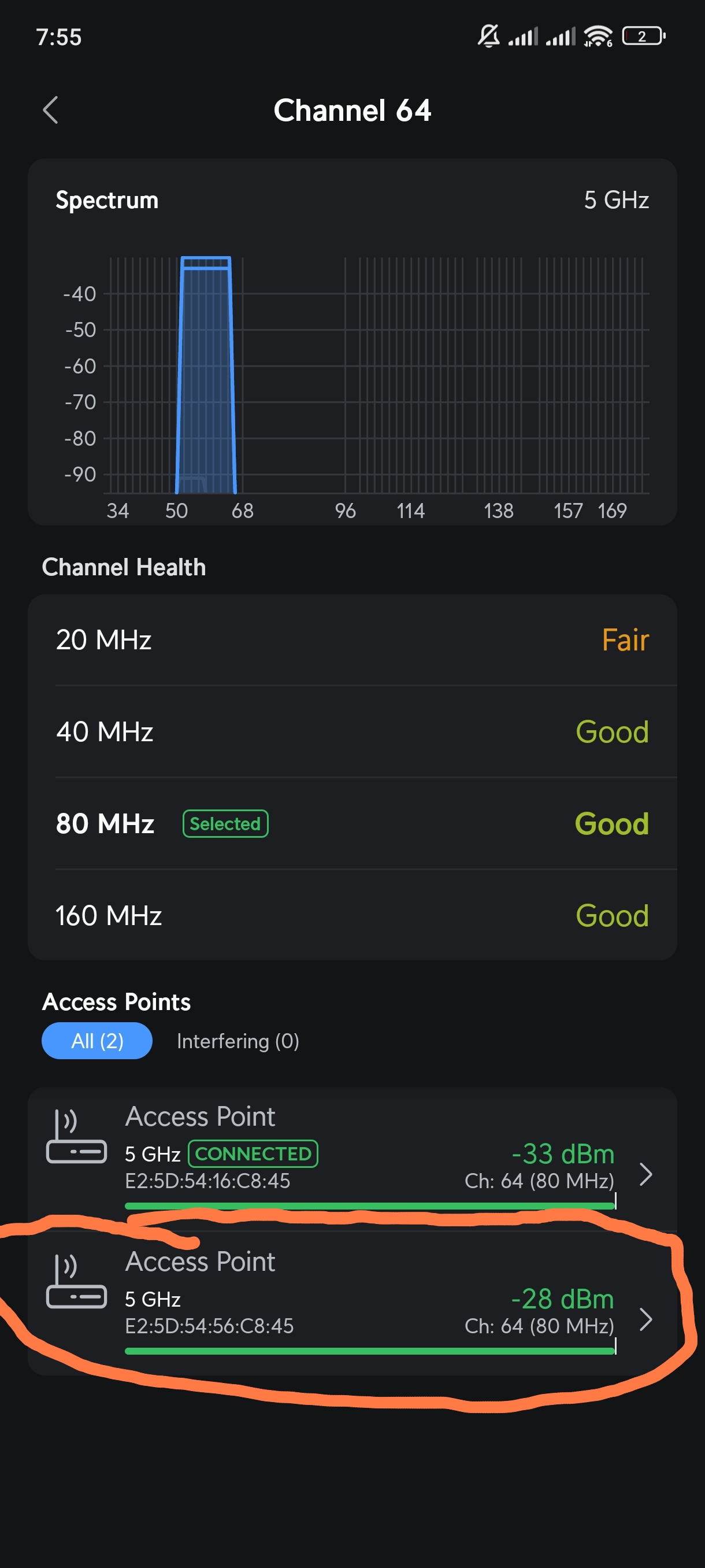

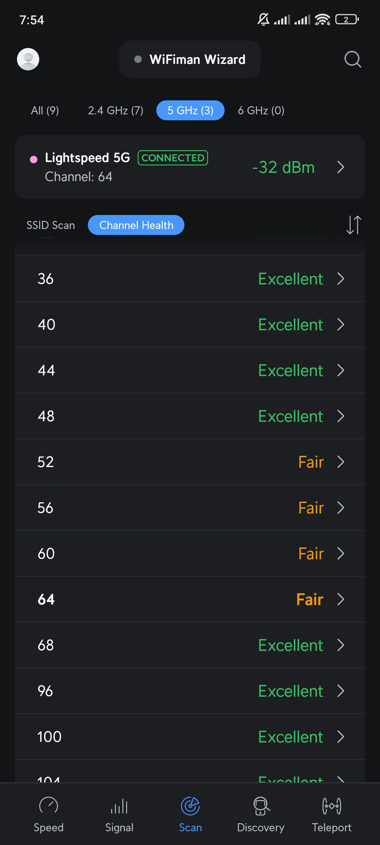

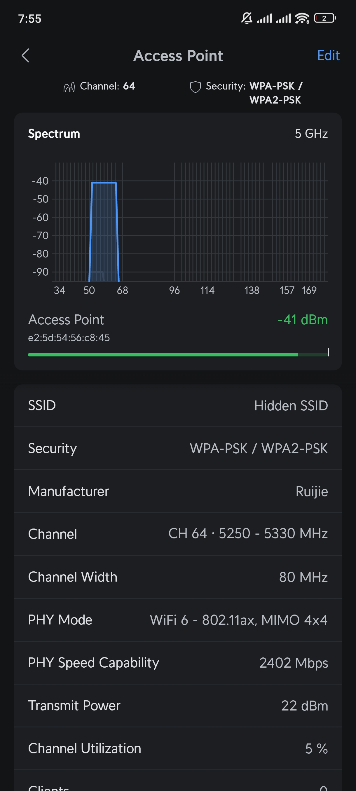

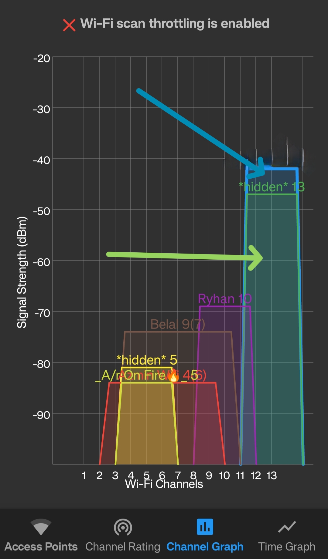

In this picture you can see two ssid is
showing one is Blue which is my
normal ssid and the other one is hidden 13 which is also from my router.
My question is why how to off this hidden 13 ssid and my router brodcasting this ssid.
My router.is ruijie ew 1300g
RG-EW1200
Mesh-Wi-Fi

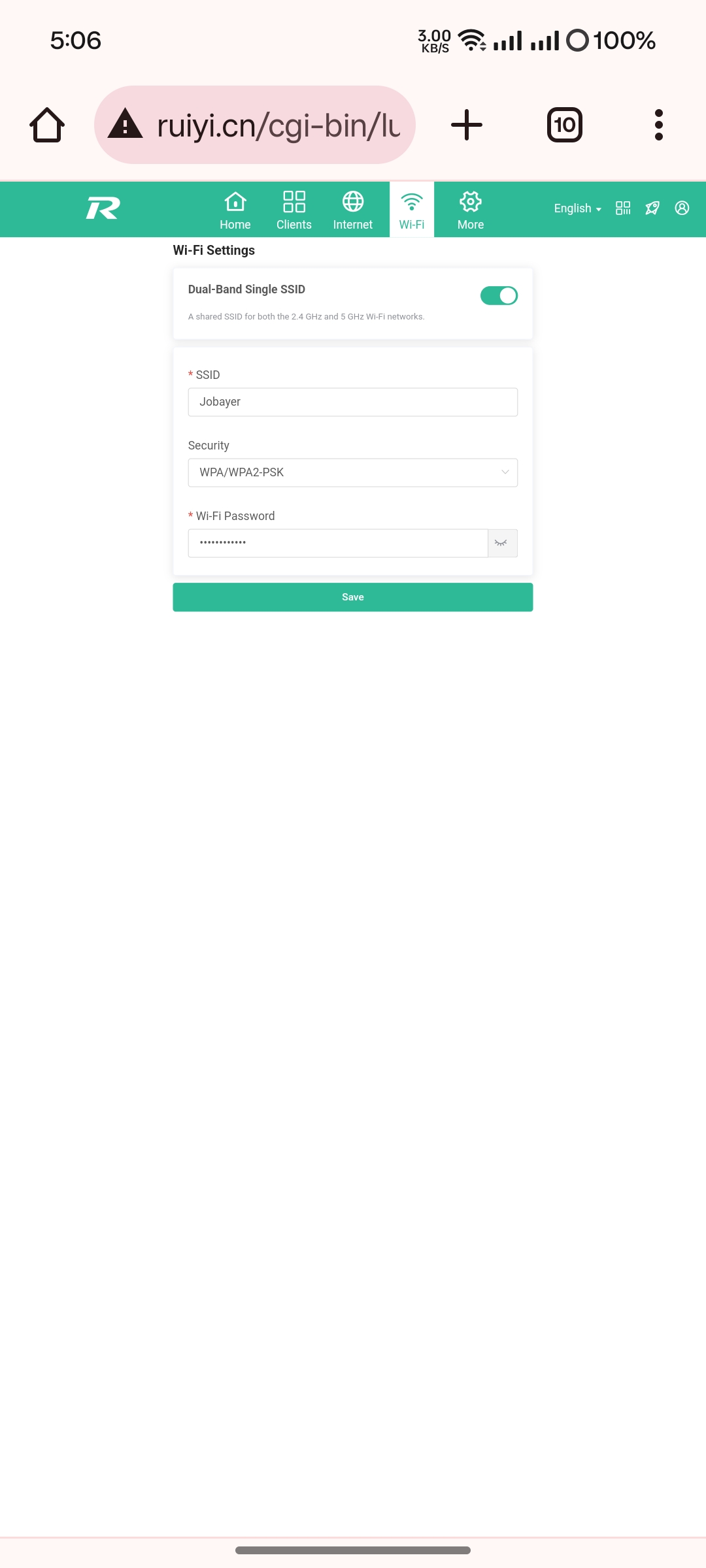

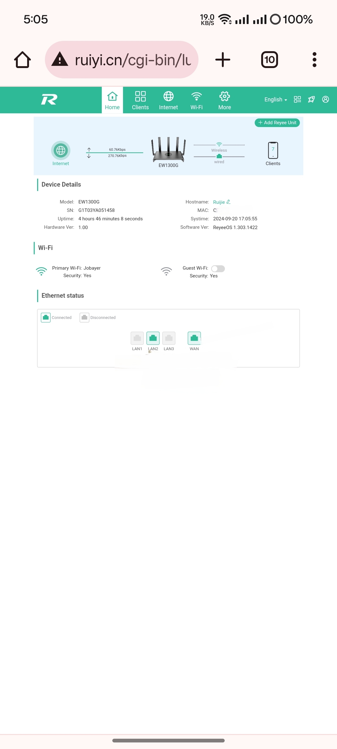

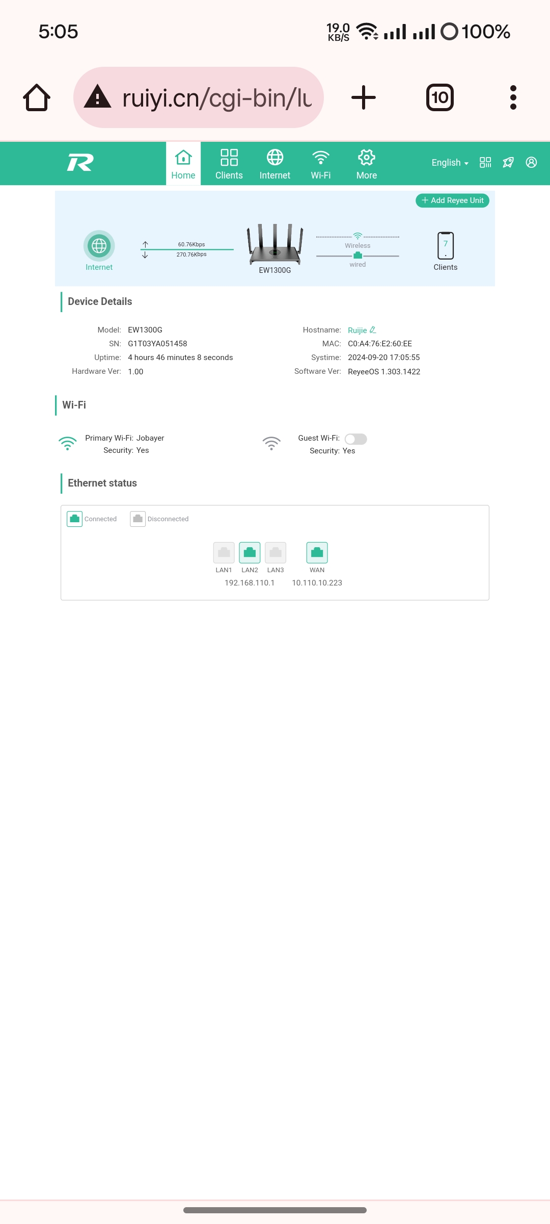

Hi sir,
Could you show me your SSID configuration on ew 1300g?
Steve
0 2024-9-20 19:08:02 View all replies
GTAC-Steve replied at 2024-9-20 18:06
Hi sir,
Yes this is my ssid configuration
0 2024-9-20 19:26:00 View all replies
Hi sir,
Yes this is my configuration

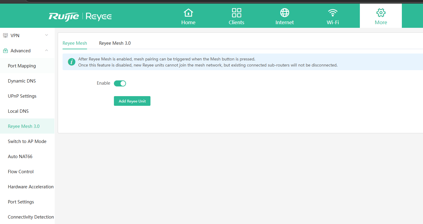

Hello,
The hidden SSID your router broadcast is for the mesh network. If you don't want it to broadcase it, you can turn off the mesh in your router.
0 2024-9-21 03:08:14 View all replies
GTAC-Ryan replied at 2024-9-20 22:46
Hello,
The hidden SSID your router broadcast is for the mesh network. If you don't want it to broa ...
I already turned it off  but still i am showing those hidden ssid
0 2024-9-21 03:11:40 View all replies
User 22610 replied at 2024-9-21 03:08
And i already factory reset my router but still l am seeing those hidden ssid
0 2024-9-23 14:27:54 View all replies
User 22610 replied at 2024-9-21 03:11
This hidden SSID is broadcast by our router and can not be disabled currently. Sorry for the inconvenience.
