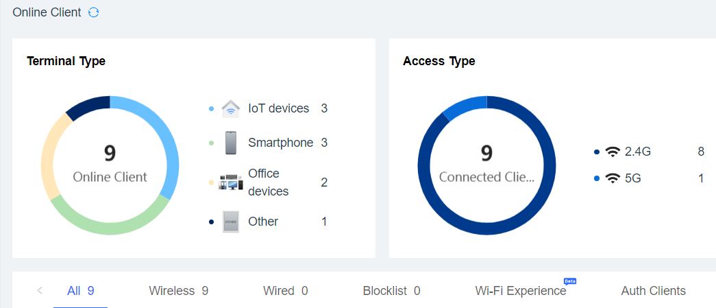

I cannot see all wired clients that connected and online in my network.
It's been more than a week now. All clients can access network normally.

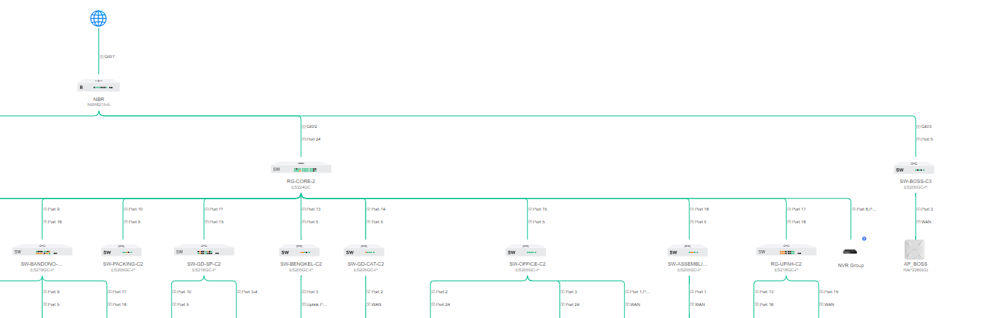

May you draw your network topology?
Is this a newly deployed project? Has the wired users information been displayed before?
My project Up time: 238 day(s) .
Wired users information has been displayed before, only around last week or so, i cannot see all wired clients.

Yes, Sir, I can see all my clients. Wireless and Wired in showARP.
But still none of my wired clients showed up on ruijie cloud
